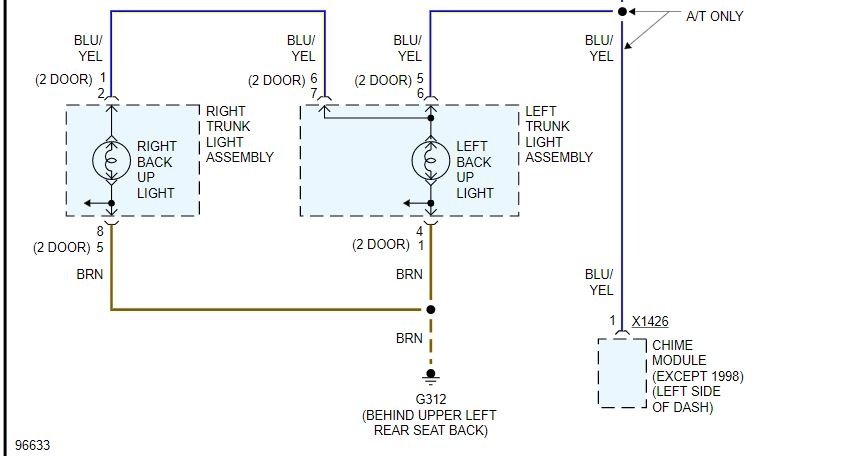

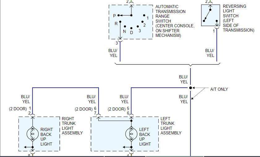

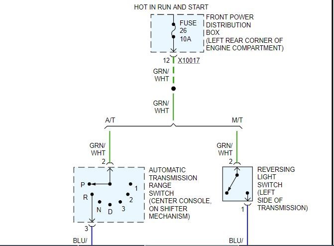

What code was retrieved? Also, the back up lights and the reverse bell, it sounds like the reverse light switch has failed, and it has nothing to do with the mass air flow sensor. I attached a wiring schematic below. Note that I broke it into three pics so you could read it. I did, however, overlap it so it is easier to follow.
Take a look at the pics. You will see power is provided via fuse 26 in the power distribution box under the hood. It then goes to the reverse light switch. Once the switch is closed, power travels to the back up lights and to the chime module.
Power is supplied via the same fuse to the transmission range sensor and that appears to be working, so I don't suspect a fuse. It could be the bulbs, but if that was the case, I feel the chime would still alarm. First, make sure the bulbs are good. If they are, check the switch for adjustment. If it is properly adjusted and still not working, replace the switch.
