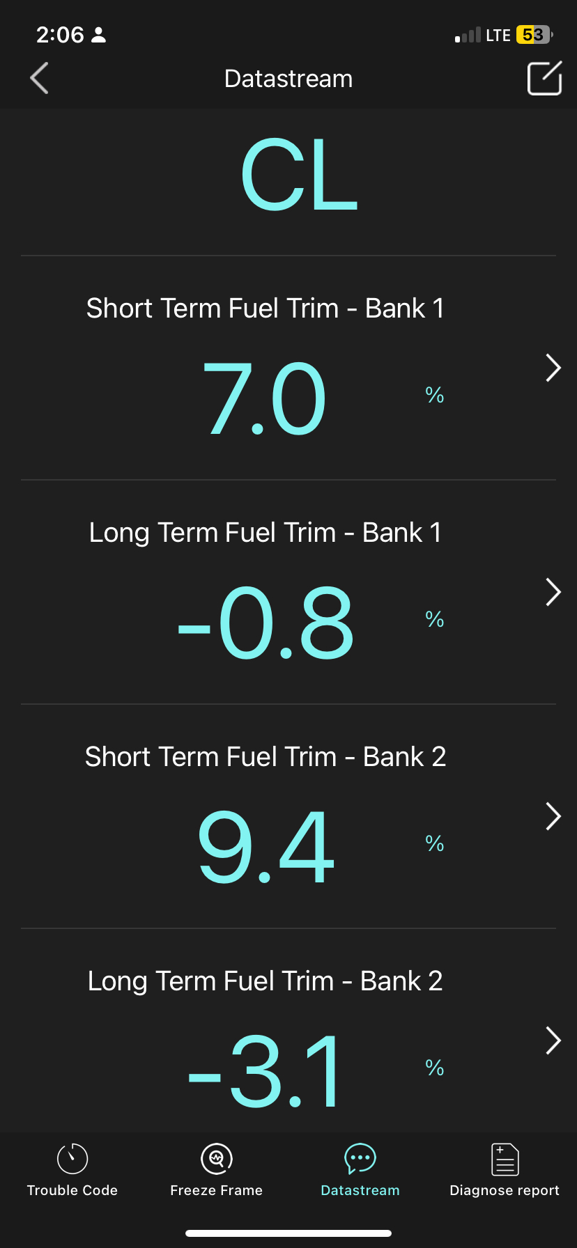

I’ve gotten the spark plugs from AutoZone. I also researched that Nissan Pathfinder's tend to have failures on their MAF sensor could that be a cause? Also check the trims and I noticed bank 1 fuel trim aren’t running both the same could that be another hint?

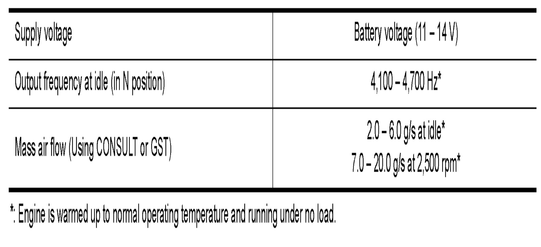

Okay, on the plugs, I have seen many counterfeit parts from online sources. I wanted to possibly eliminate that. The fuel trims long term are trying to pull fuel while the short terms are adding. Try this. Start the engine, let it idle a bit. Note those trims. Now rev it up to 1000 and note those, now up to 2000 and note those. If at idle you see the trims going positive (like those readings) then as you step up the rpms they start to go down until you get to closer to zero trim (A perfect engine would show the fuel trims at numbers that zero out, so maybe long term at 2% but short term at -1% or similar). Also look at the MAF numbers, with a warm engine you should see about 3.5 grams per second at idle. Normally you figure one gram of flow per liter of engine size as a starting point. Then as the throttle opens it should go up at a nice even rate. However, if it hasn't been cleaned in a while this would be a good time to clean it and maybe the throttle body. Just to see if it is related. Another quick test to see if it's a vacuum leak, on a cold engine, start it and then spray carb cleaner near the intake gasket area, around the vacuum lines and check the air tube between the MAF and throttle body as well. If there are no leaks the engine will stay steady, if it suddenly changes when sprayed, look for a leak in that area.

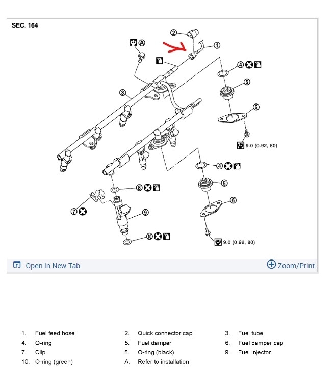

I haven’t seen a leak of gas, just had a smell when the car would turn on so I’m probably going to test the pump with a multimeter and if that wouldn’t be it then replace the fuel filter. thanks for the information appreciated.
Apr 26, 2024 at 2:55 PM
STEVE W.
  • 15,113 POSTS
You can get a pressure test kit at most parts stores as a loaner tool. On that one you test the pressure by disconnecting the line at the fuel rail and putting the tester inline. To remove the pressure before testing you remove the fuel pump fuse and then try to start the truck. Once it won't even fire, you connect the tester and put the fuse back in. Then run the test. https://www.2carpros.com/articles/how-to-check-fuel-system-pressure-and-regulator
