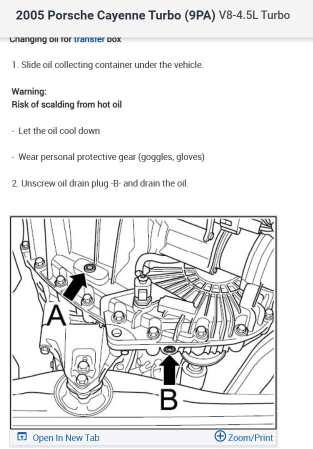

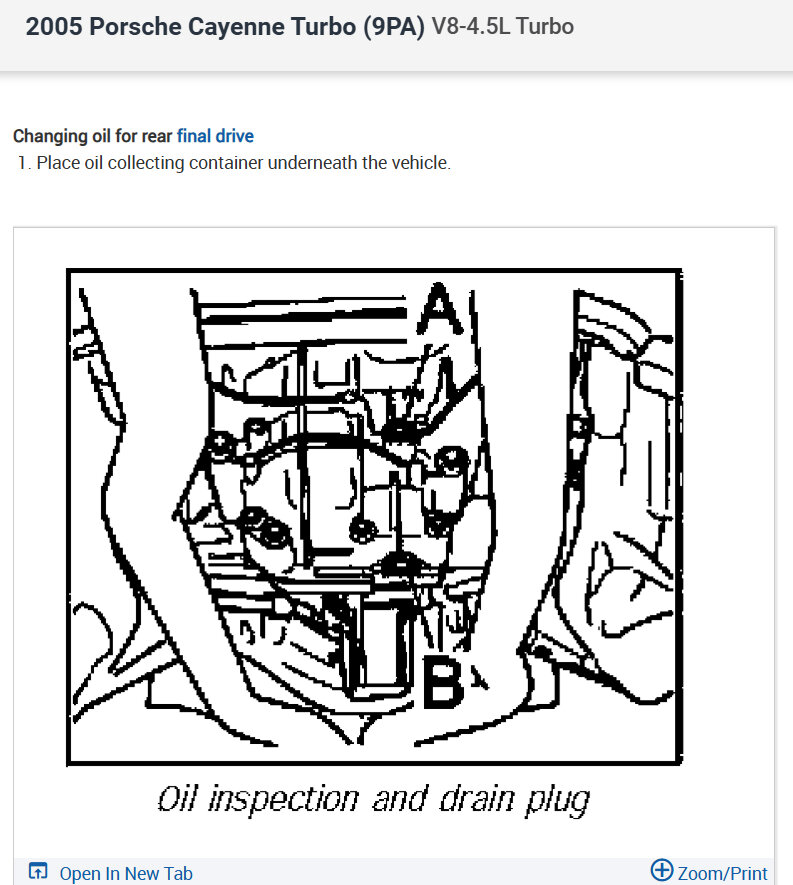

So these cars have special fluids that can break down and not allow the clutch discs inside the transferase and rear differential to slip, instead they chatter which can give you that shudder sensation. If these fluids had not been changed at 150,000 this is where I would start. Any warning lights on? Here is how to change the fluid out also, make sure you use Porsche fluids only! This is important.
Fluid Types
Approved oils for transfer box Z48/00 (S) and Z48/50 (Turbo) as of January 2003.
Type .................... Esso ATF LT 71141
Porsche Part No. .................... 000 043 205 09
Note: Esso ATF LT 71141 is red in color. The factory-fill oil comes from a different manufacturer and is blue in color.
Capacities
Transfer Case Fluid Capacity
New Filling .................... 0.85 liters
Change Quantity .................... 0.75 liters
Approved oils for front-axle final drive (all-wheel drive) V48/00 (S) and V48/50 (Turbo), rear-axle final drive H48/00 (S) and V48/50 (Turbo) as of January 2003
Front-axle final drive
Type .................... Burmah SAF-AG4
Porsche Part No. .................... 000 043 205 30
Rear-axle final drive (w/o differential lock)
Capacities
Rear-Axle Final Drive
Filling Capacity
New Fill .................... approx: 1.4 liter (1.5 quarts)
Change .................... approx: 1.4 liter (1.5 quarts)
