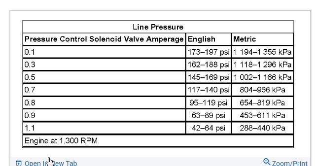

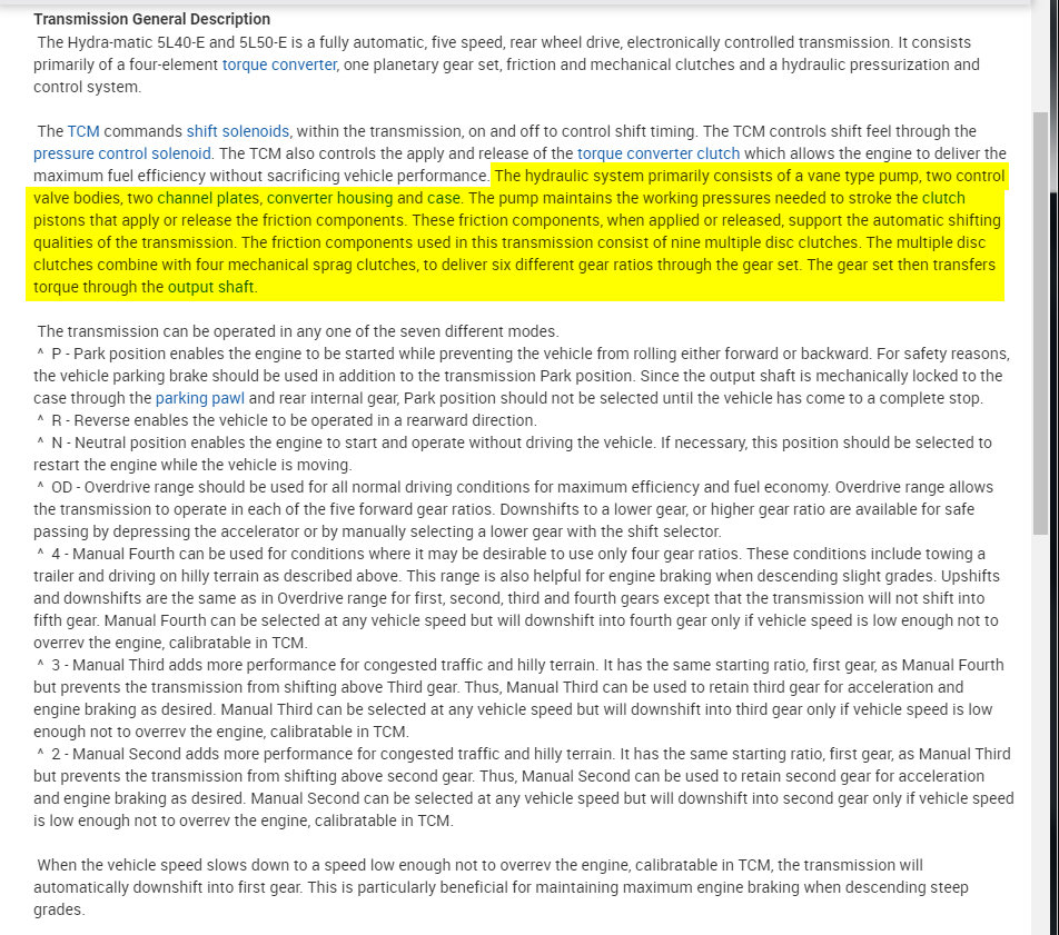

I put the transmission fluid in it, then was driving it and then I give it gas and it started like slipping like it didn't want to go but it did but I'll give it a lot of gas to go and then once I parked it and started back up her leave again. now it won't go into reverse like the shifter will go in reverse but it does it if I step on the gas it doesn't want to go backwards and might want to go forward.
