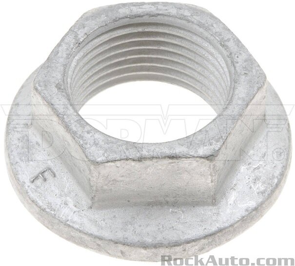

If you have a stamped steel cage with slots for a cotter pin, those nuts can be reused. If you have the style shown below, those are usually a one-time-use nut. You will get a new one with the wheel bearing. They're called, "torque-to-yield" nuts. The threads peel or stretch a little making torque values invalid for the next use. They will not develop the needed clamping force when tightened to specs.
