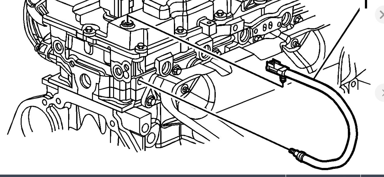

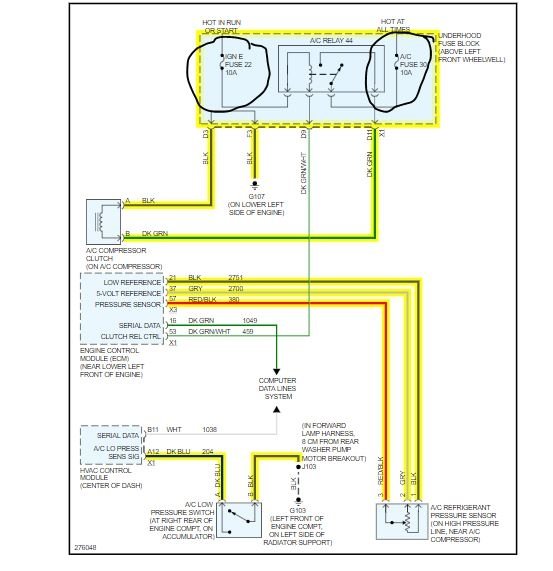

I attached a wiring diagram for you to view. Check the fuses I circled for power on both sides with the key on. This is not a visual inspection, it is a voltage check on both sides of the fuse.
As far as the temperature sender, it could be a bad sender unit. Check the sender for power with the key on.

I was addressing the temperature gauge first as that will effect the A/C operation.

Let me know what you find. The 2 are connected.
Sep 24, 2019 at 7:59 PM
The PCM ties these systems together I would do a CAN scan toy see what comes up you may have a bad PCM. Here is a video. You can get a CAN scanner from amazon for about $45.00:
