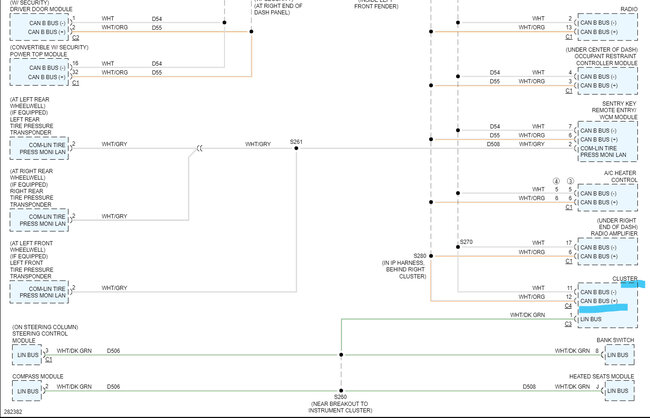

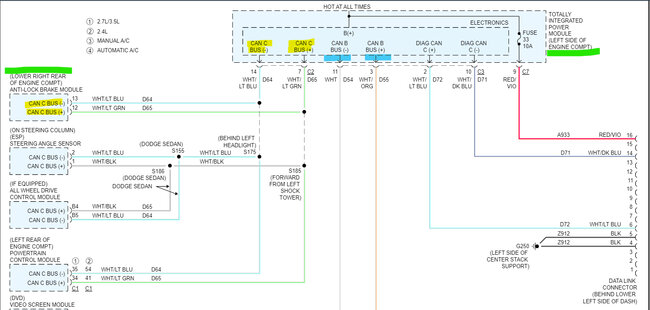

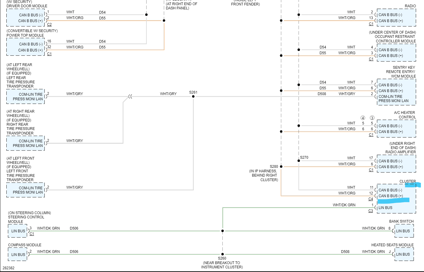

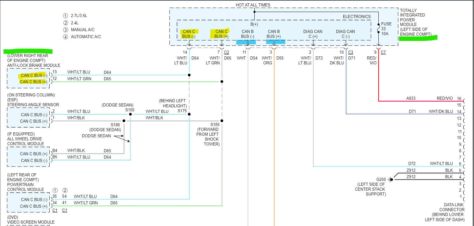

Here is a diagram of the communications network in the vehicle, you'll notice the ABS module is on CANbus C and the Instrument Cluster is on CANbus B, the TIPM is at the top which is where the two networks transmit messages between each other, also known as the "gateway module" for this reason.
So, the ABS module could be sending out corrupt messages or the TIPM might be, and I think what you are seeing on the Cluster is a result of that.

Looking at the ABS modules wiring diagram, the brake switch is actually on a completely different network as well, it is on a Linbus network that communicates directly with the Instrument Cluster, so it's possible the instrument cluster may be at fault as well. It only takes one bad module to cause a lot of problems.
