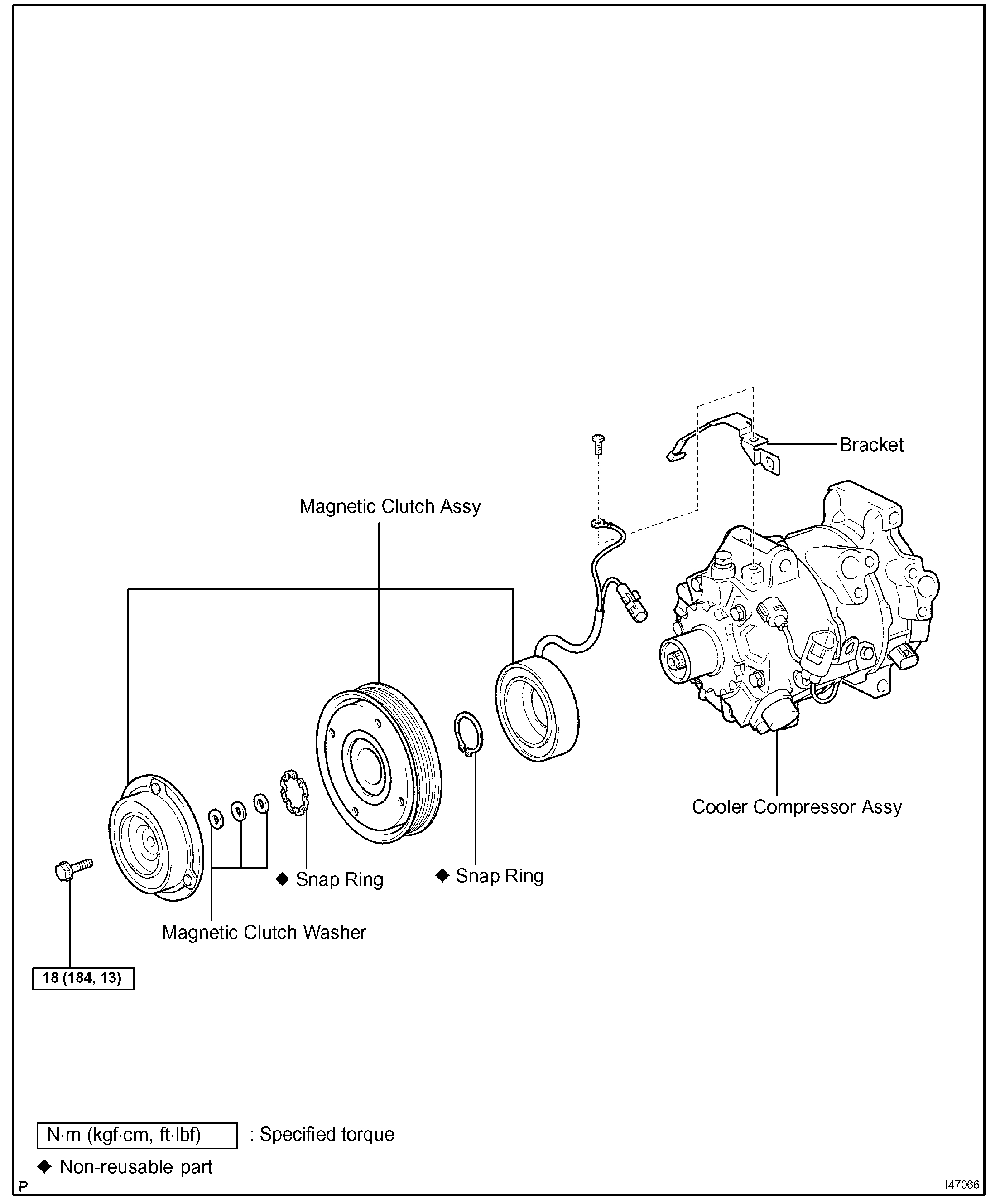

First, I need you to check a few things for me. To start, I need to know if the AC compressor is engaging when you turn the system on. If it is and you still get no cold air for fifteen minutes, then I suspect either you are low on Freon or there could even be an issue with what is called a blend air door actuator. The actuator is what determines if you get heat, AC or nothing into the vehicle.
Open the hood and have a helper start the car and turn on the AC. Pay attention to the compressor, which is a belt driven accessory on the front of the engine. There is an electric clutch which should cycle on and off. When this happens, you will hear a clicking sound. I attached a picture for you to see the part. The magnetic clutch assembly in the picture is what I am referring to.
Pay attention to that and let me know what you find. I would also like to know if the heater works properly. Also, feel free to let me know if you have other questions.
