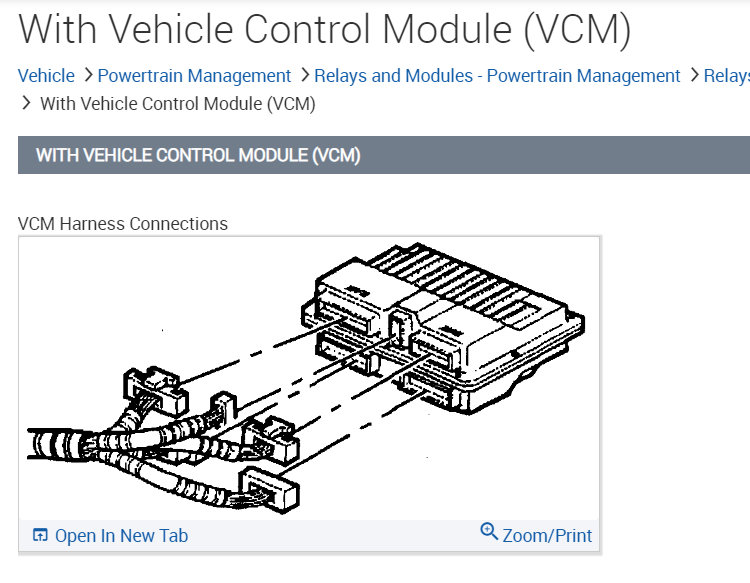

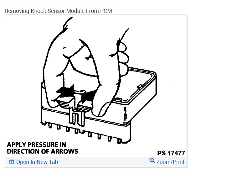

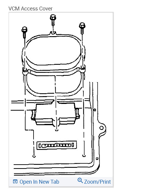

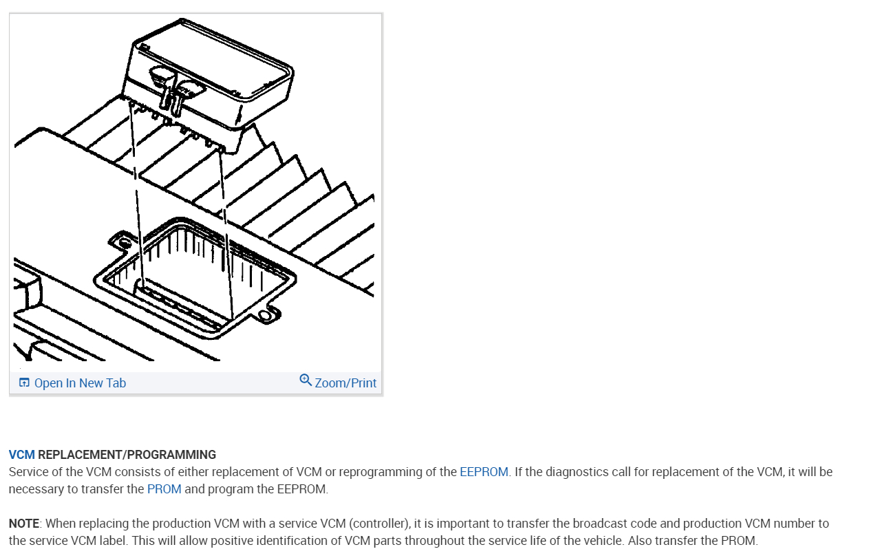

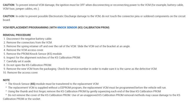

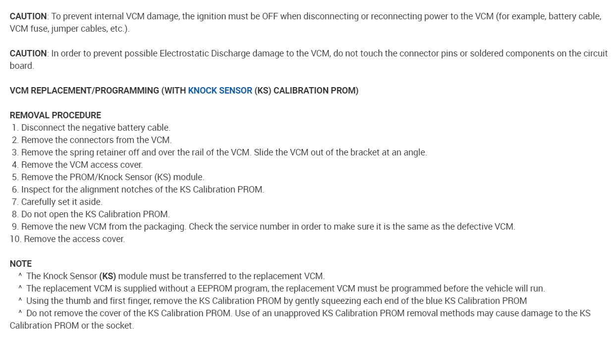

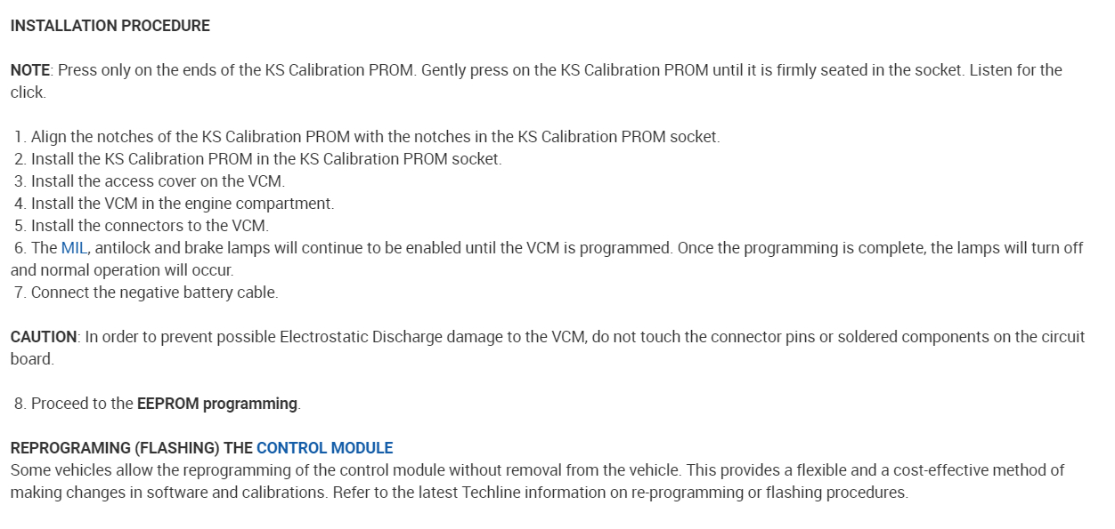

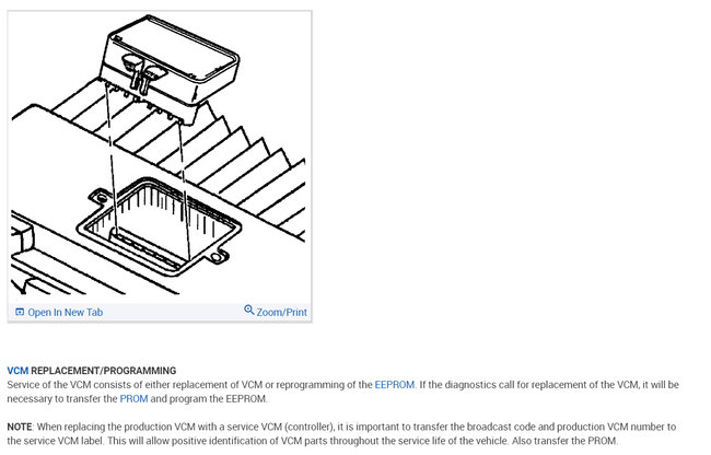

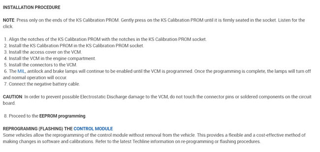

The only way yot see if the PCM is bad is to send it out and have it tested.
