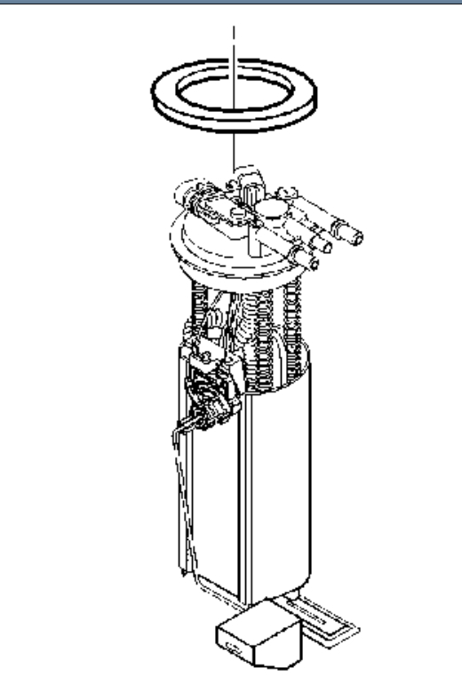

The most common cause for the 300 misfire code is low fuel pressure from a weak fuel pump.
You need to test the fuel pressure to verify.
Fuel Pressure (Key ON, Engine OFF) .................... 284-325 kPa (41-47 psi)
It looks like you may be replacing the fuel pump.

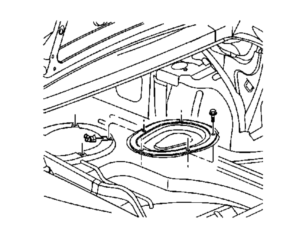

3. Remove the rear compartment trim panel.
4. Remove the fuel sender access panel bolts.
5. Remove the fuel sender access panel.
6. Disconnect the fuel sender quick-connect fittings.

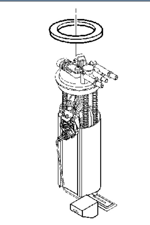

9. Remove the fuel sender retaining ring using the fuel sender lock nut wrench.
IMPORTANT: The modular fuel sender assembly will spring-up when the locking ring is removed.
10. Remove the fuel sender assembly.
NOTE: Do Not handle the fuel sender assembly by the fuel pipes. The amount of leverage generated by handling the fuel pipes could damage the joints.
IMPORTANT: When removing the fuel sender assembly from the fuel tank, the reservoir bucket on the fuel sender is full of fuel. The fuel sender must be tipped slightly during removal in order to avoid damage to the float. Place any remaining fuel into an approved container once the fuel sender is removed from the fuel tank.
