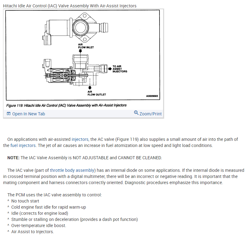

Typically when an engine has similar issues you are describing there are some sort of trouble codes.
Is your check engine light one? Here is a guide that will help with getting codes.
If so do you know what code it is producing?

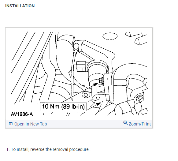

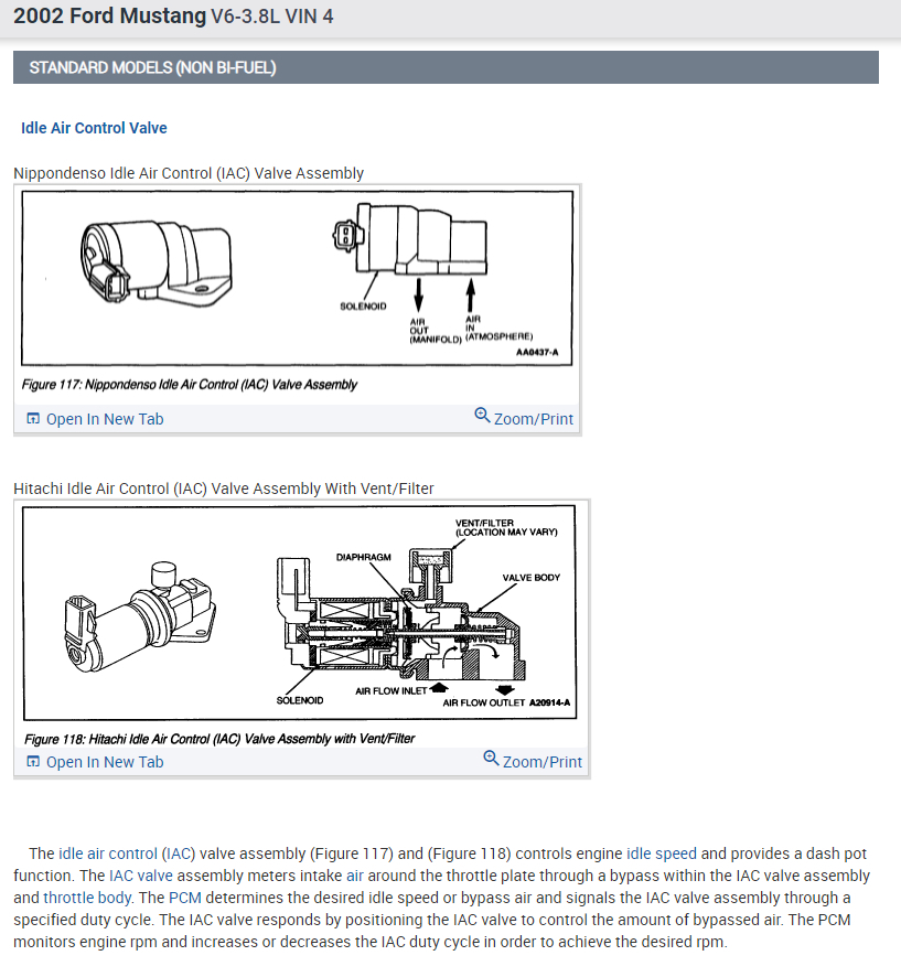

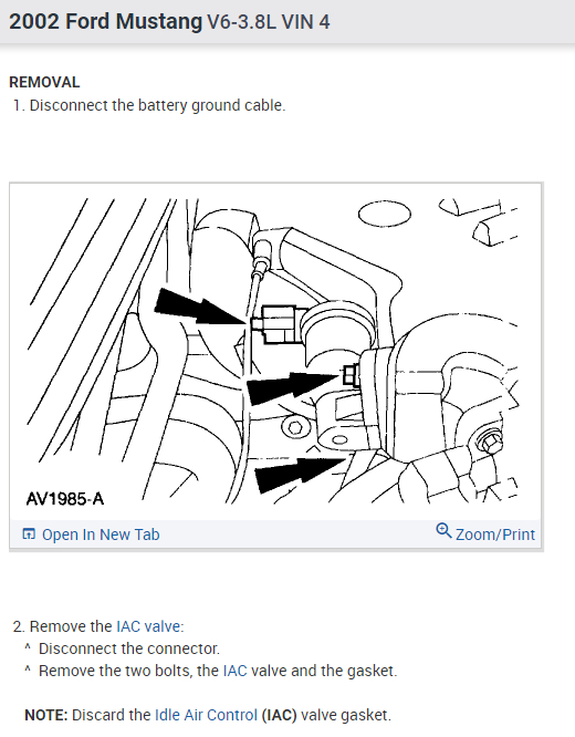

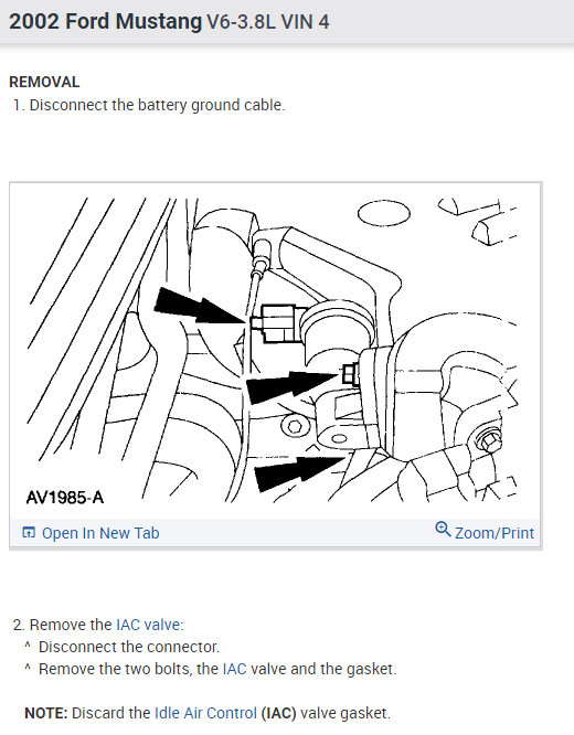

Usually poor idle is caused by faulty idle air control valve.
Many times just cleaning the IAC valve fixes some of the issue.
https://www.2carpros.com/articles/how-a-idle-air-control-valve-works
https://www.2carpros.com/articles/idle-air-control-valve-service

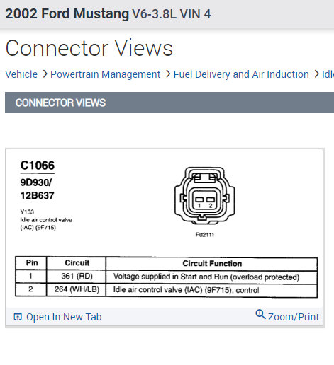

If you let me know little more info, as if you have any trouble codes etc.
I will be able to provide any diagrams you might need.
