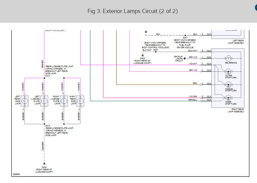

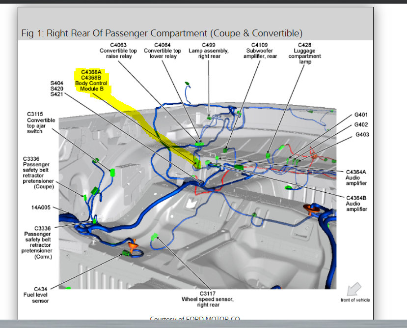

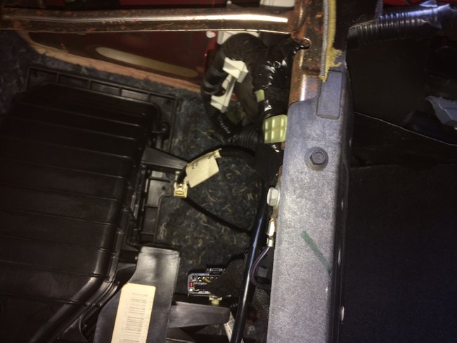

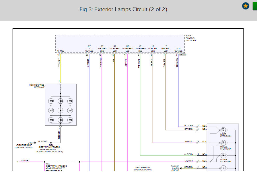

This could be an internal short to power in your vehicle's Body Control Module B (BCM)(B) which is located in the right rear of the luggage compartment. It is after fuse #2, so unplugging the fuse would cause a break in the circuit as you can see in the wiring diagram of your vehicle's external lighting. I have included in the diagrams down below for you as well as a diagram of the BCU B's location. Please go through these guides and get back to us with what you are able to find out.

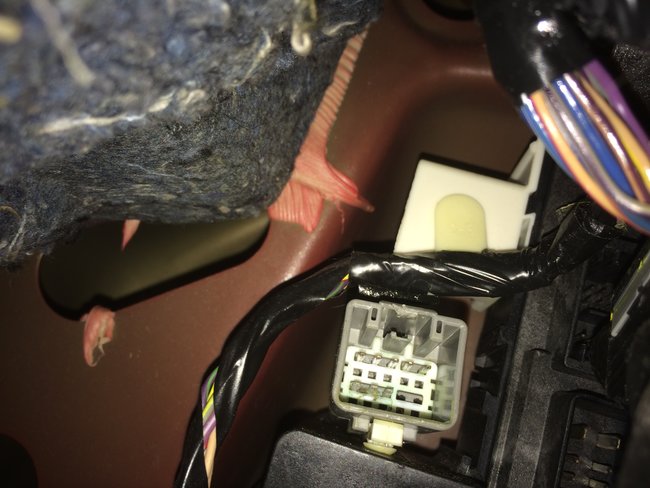

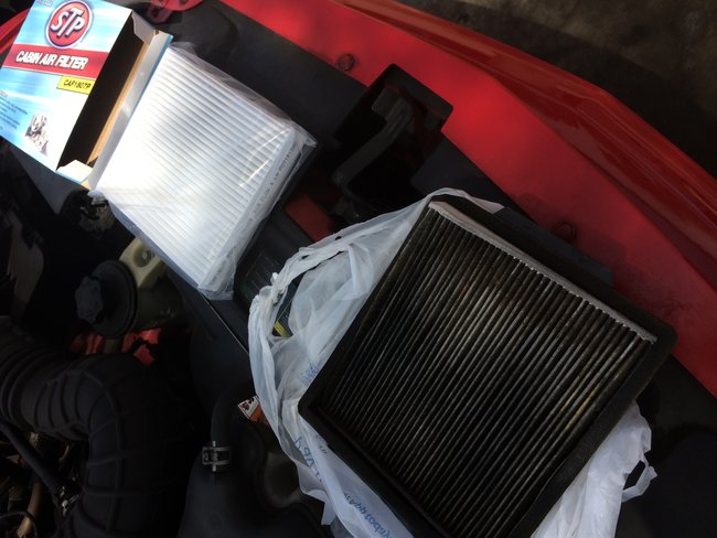

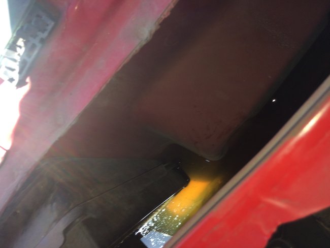

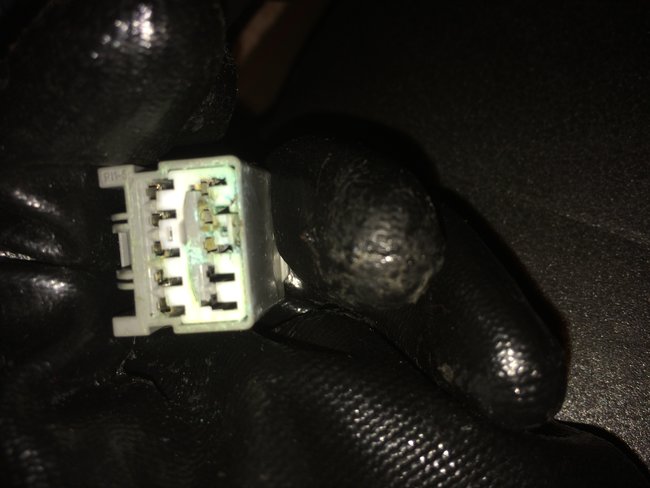

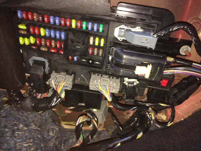

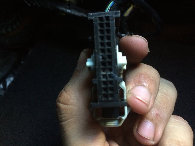

Followed the diagrams, after looking everything over and driving for a bit after going to the car wash. I noticed the lights come back on and the Trac Off light come on once in a while. I noticed my Cowl had water sloshing around and built up, the water went into the Cabin filter, and moistening the passenger side floor next to fuse box, would this be the internal short? I have some pictures and not sure if I found the culprit to the brake lights staying on and the trac light coming on once in a while. If this is the problem will electrician wd-40 work on fixing this and new electrical tape for the wiring since most of it is unraveling on its own and covered in a oily substance? or will this have to be taken care of by a ford service location?

For attached images that did not load.

If it isn't the problem, then it soon will be. Okay, the electrical connectors can be cleaned up yourself. CRC makes a special cleaner for electrical connectors and it should be available at any auto parts store. It is called QD electronic cleaner and again, it is manufactured by CRC. That should clean up the corrosion the is producing the unwanted resistance on these circuits. Next you should probably get a tube of Dielectric Grease and put on these connectors. It is conductive grease that will help to weatherproof them. Finally, you need to fix the original problem, which is the water collecting and getting into the cabin. Wherever it is getting in at needs to repaired, or else this will happen all over again. Please keep us informed as to how things progress.

Oh my goodness! Thanks so much to y’all! I have a 2010 Mustang Convertible V6 with the same exact problem. I noticed water dripping down behind the glove box, which turned out to be from a clogged drain in the Cab air filter as well. It flooded my floorboard with about 2 gallons of water. My brakes have been flashing since. I tried everything you mentioned before I found this thread, I replaced the fuse and cleaned the whole fuse box with fine electronics cleaner. I just now singled out the problem to the wiring harness that deals with TC, ABS, and brake lights apparently! I have worked on this all day, and just sat down out of frustration. Y’all solved my problem! Thanks!
