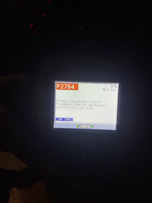

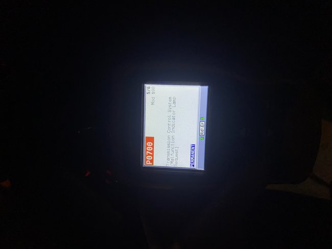

At times when trying to start the car it will turn on fine. Other times it was turned on and the engine will shut off. The lights to the car on the dash will still be on but the engine will not turn on therefore I will sometimes have to gas it when turning it on. I have taken it to advanced auto to get a computerized reading. Below is what I received.
May 30, 2022 at 3:17 PM

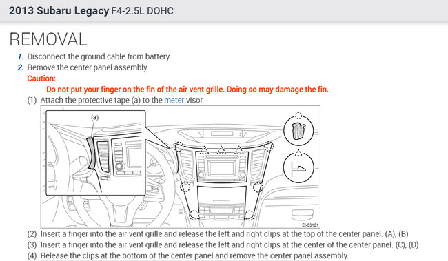

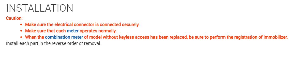

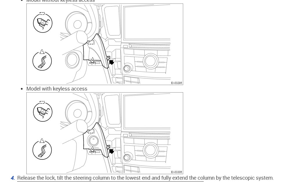

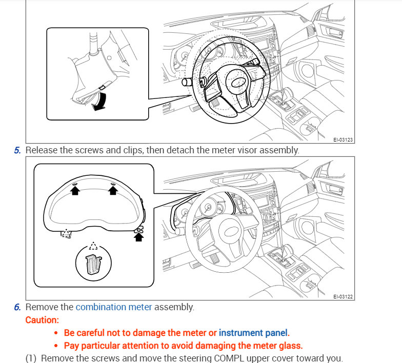

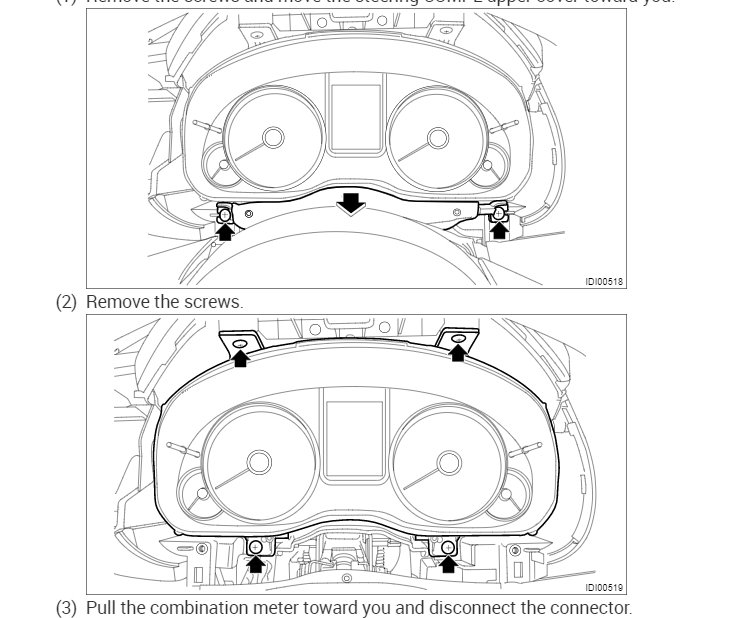

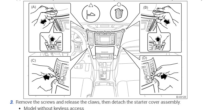

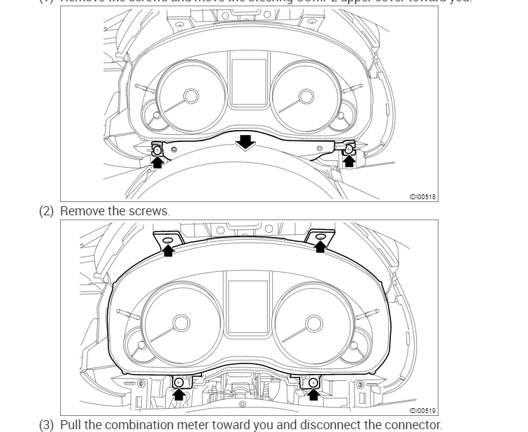

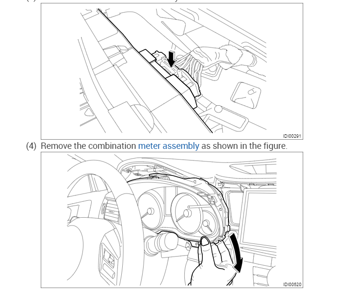

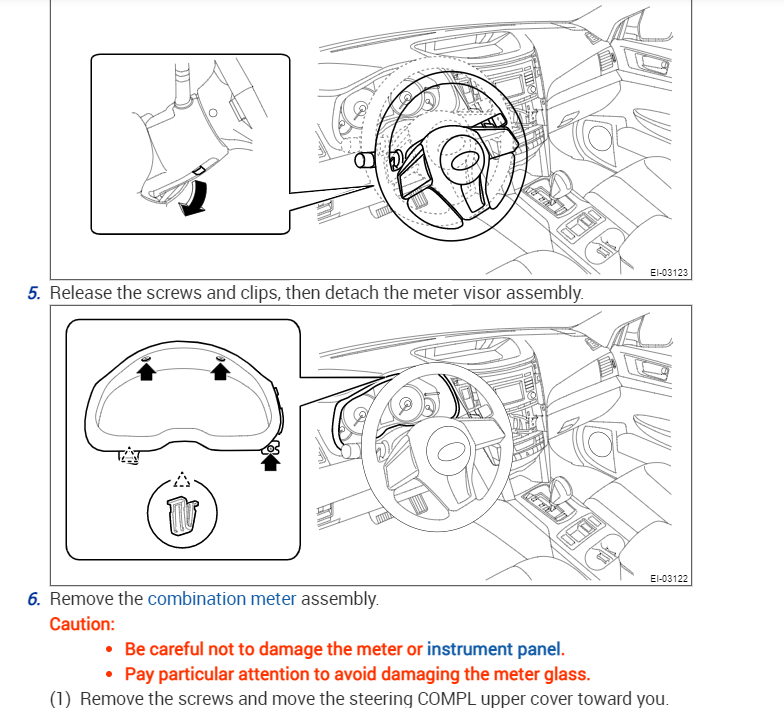

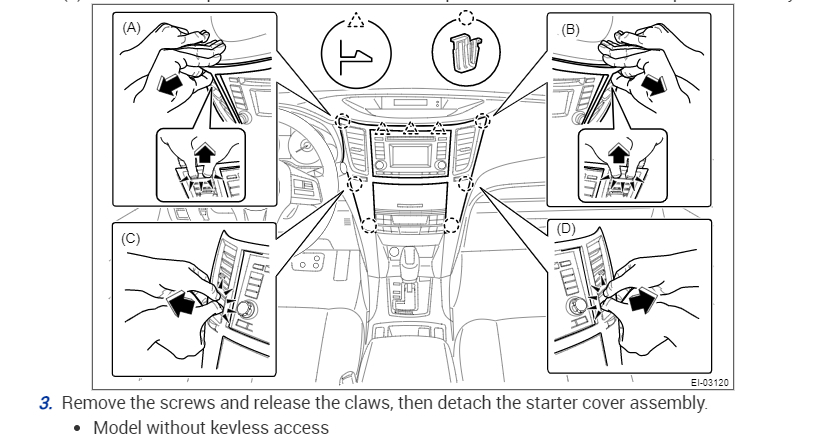

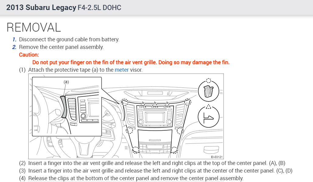

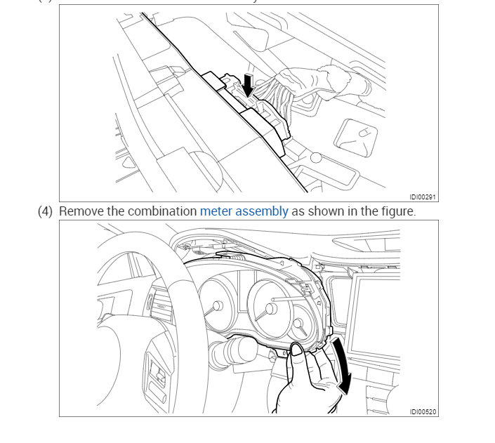

That code will not cause the issues you are having, it sounds like the instrument cluster is bad. To be sure let's do a CAN scan to confirm the issue. here is a guide and video that will help us fix the problem, also I have left the cluster replacement instructions in the diagrams below.
https://www.2carpros.com/articles/can-scan-controller-area-network-easy
The code you have should go away once the cluster is replaced if not, please start a new question for torque converter clutch problem. Check out the diagrams (below). Let us know what happens and please upload pictures or videos of the problem.
May 31, 2022 at 10:40 AM

I also received this one. Does that pair with the previous comment as well?
