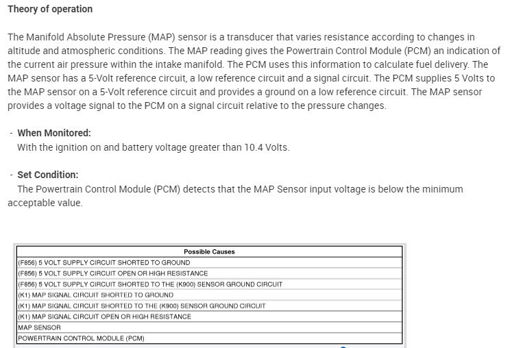

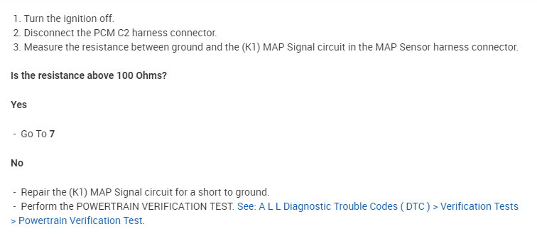

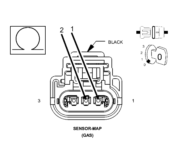

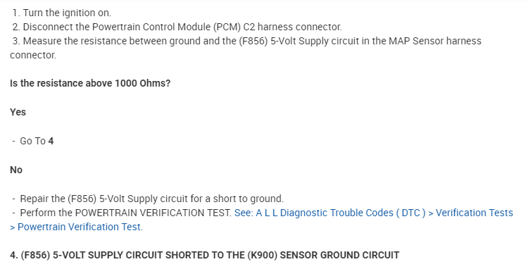

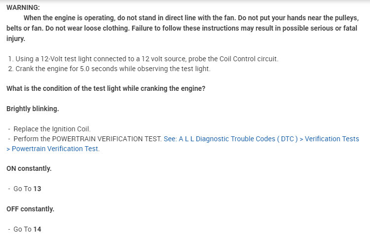

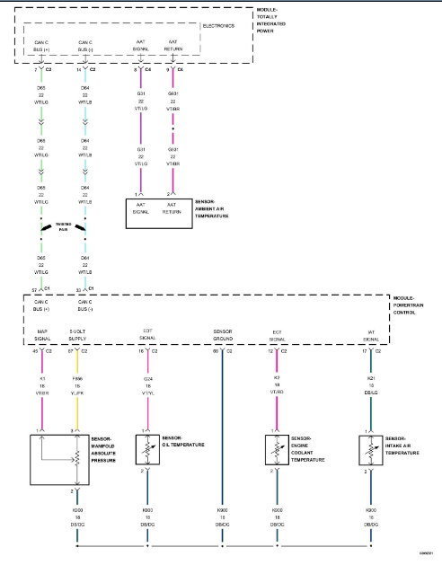

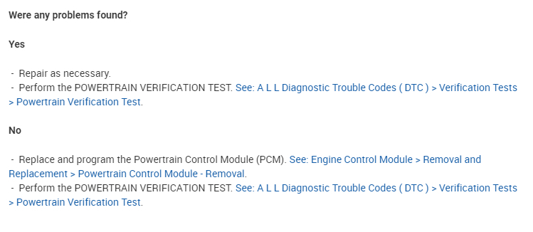

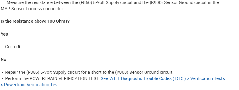

P0300 and p0107.
Sep 21, 2019 at 3:12 PM

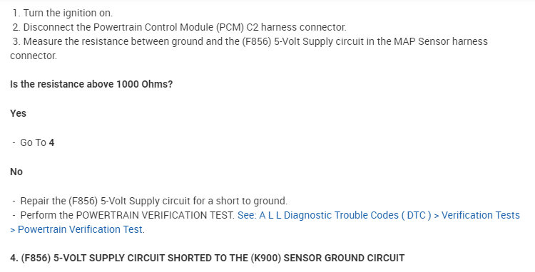

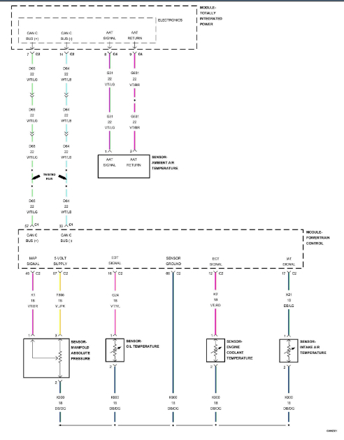

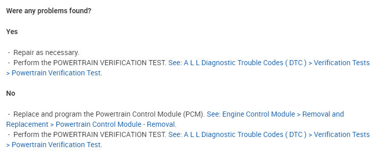

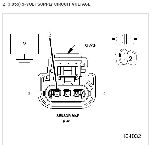

DANNY L
  • 5,648 POSTS

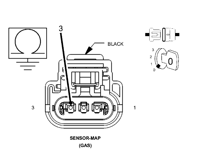

Hello again.

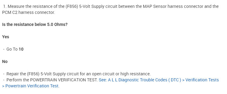

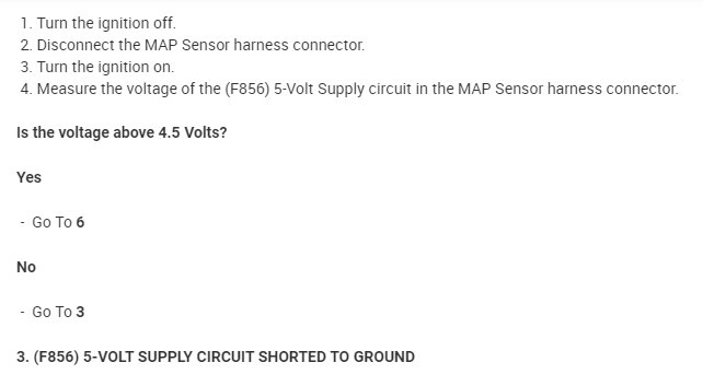

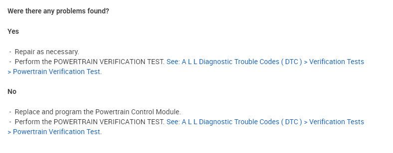

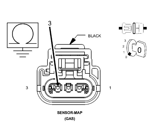

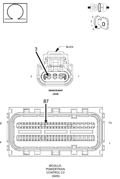

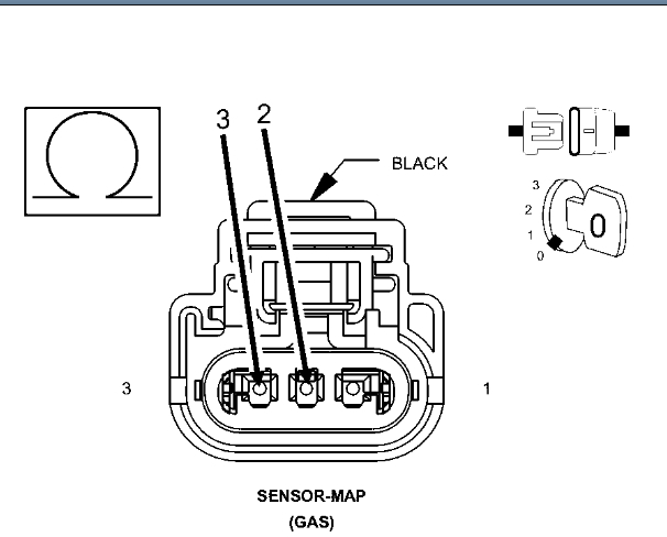

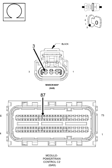

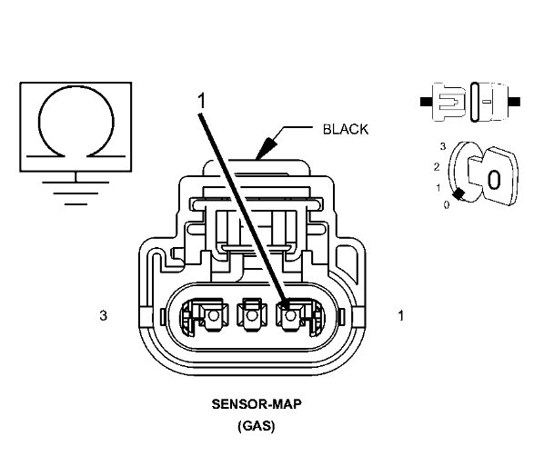

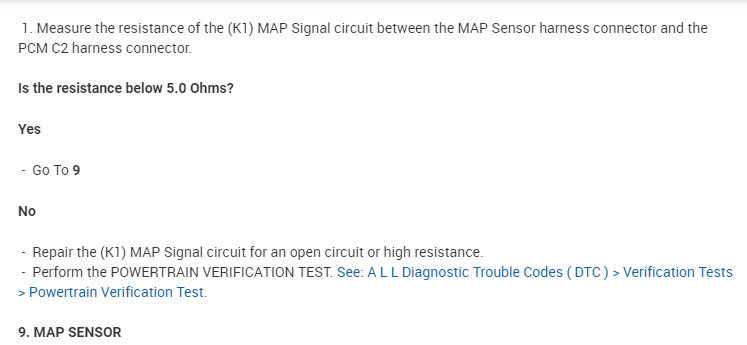

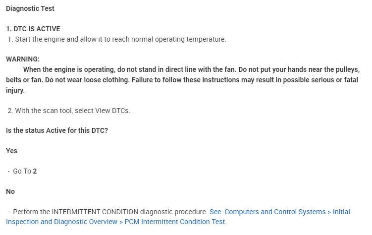

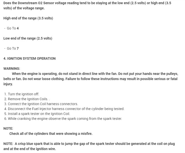

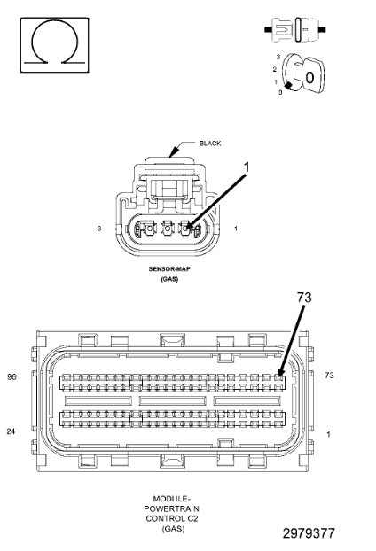

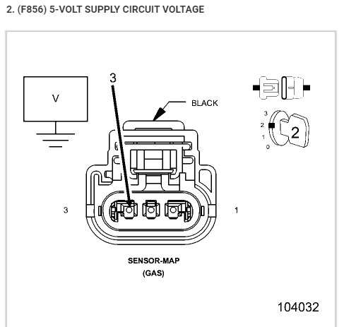

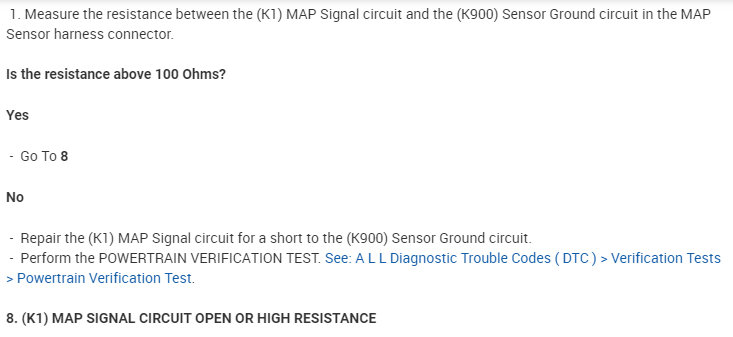

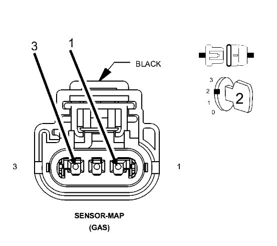

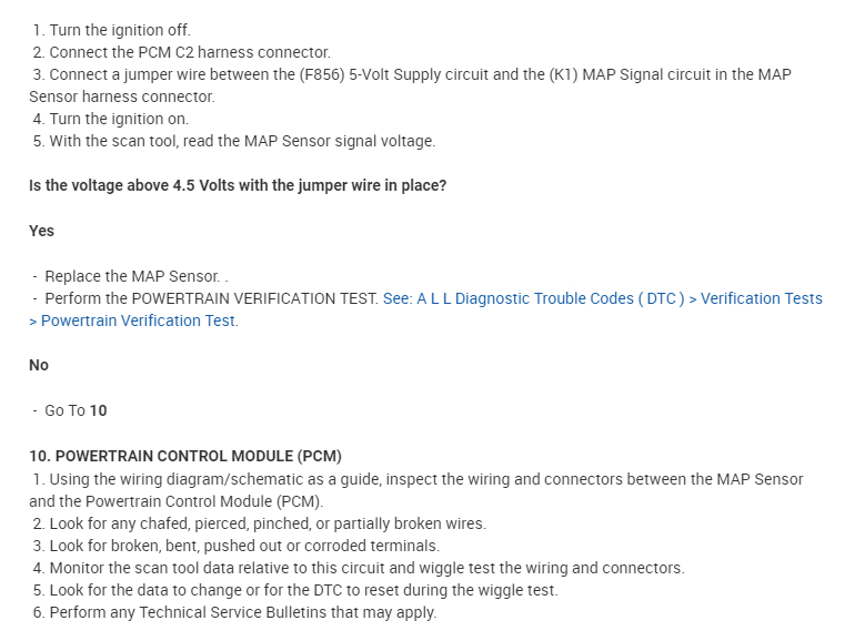

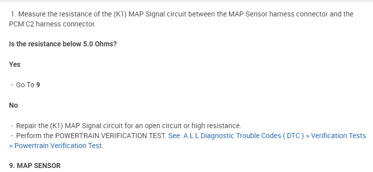

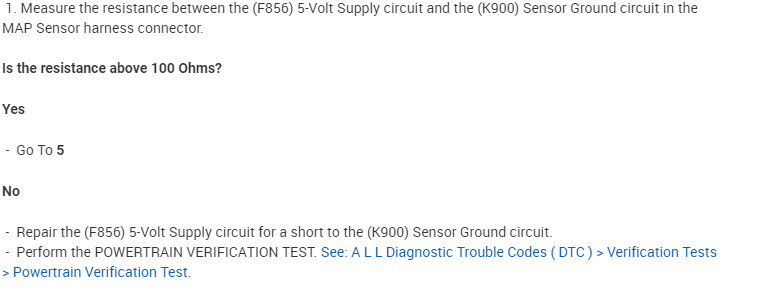

I've attached step-by-step instructions below for the P0107 code. Hope this helps and thanks again for using 2CarPros.
Danny-

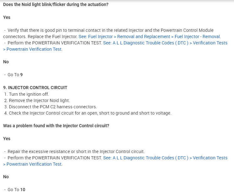

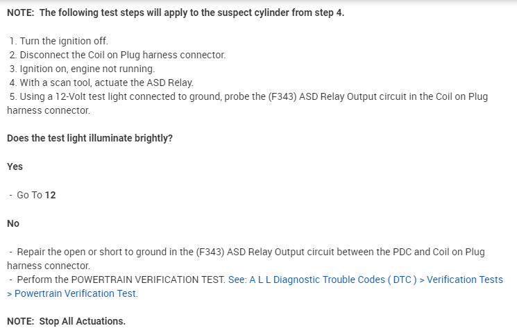

DANNY L
  • 5,648 POSTS

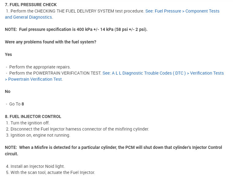

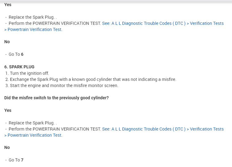

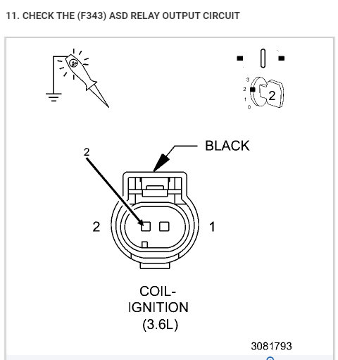

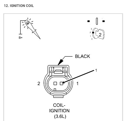

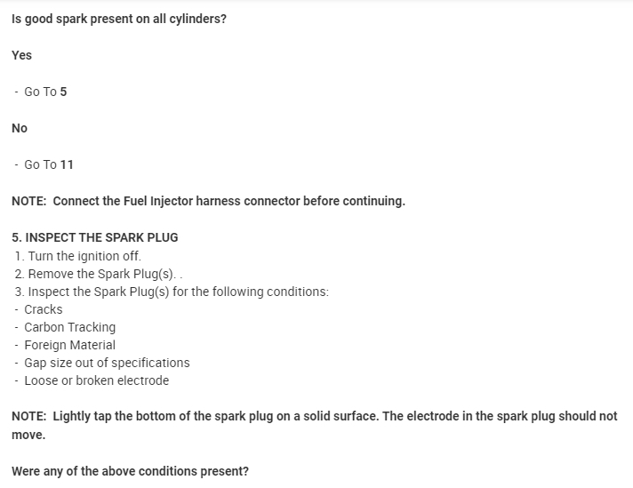

Hello again.

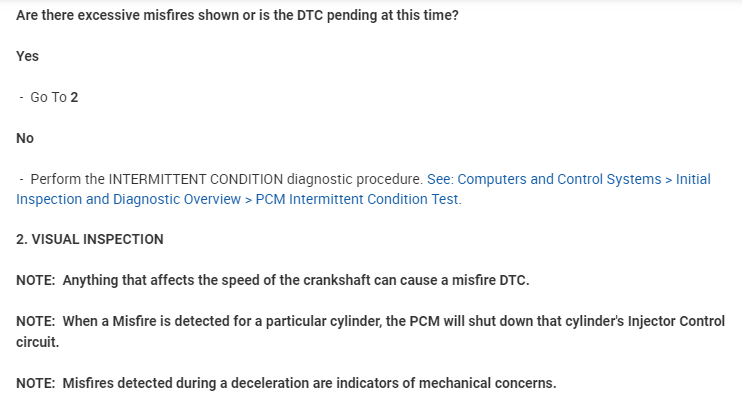

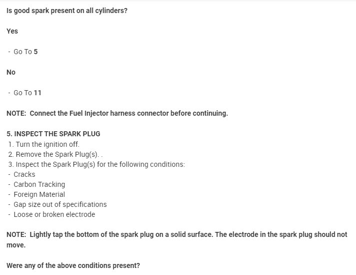

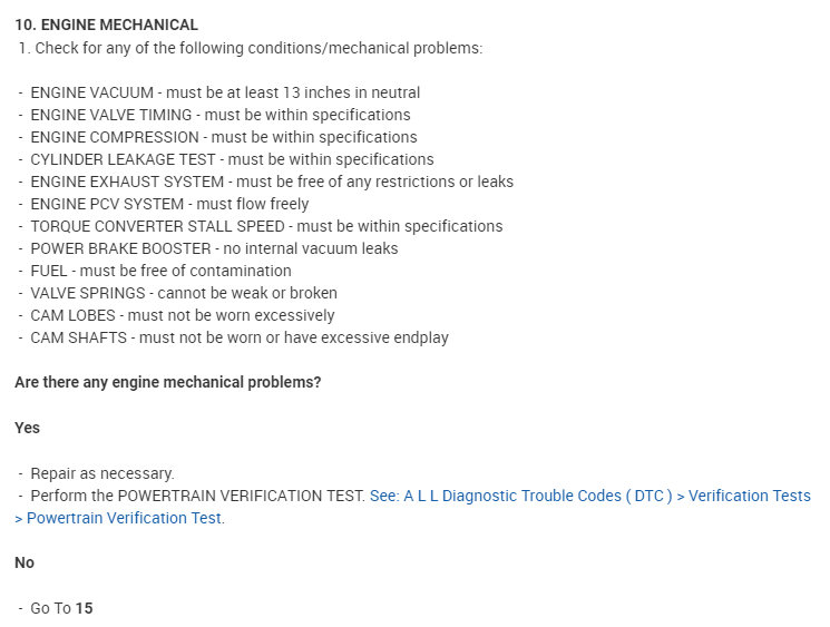

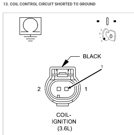

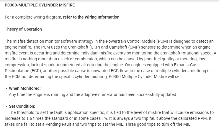

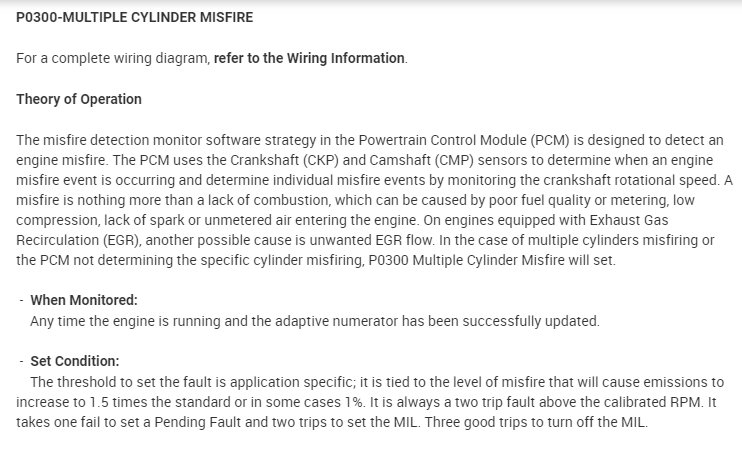

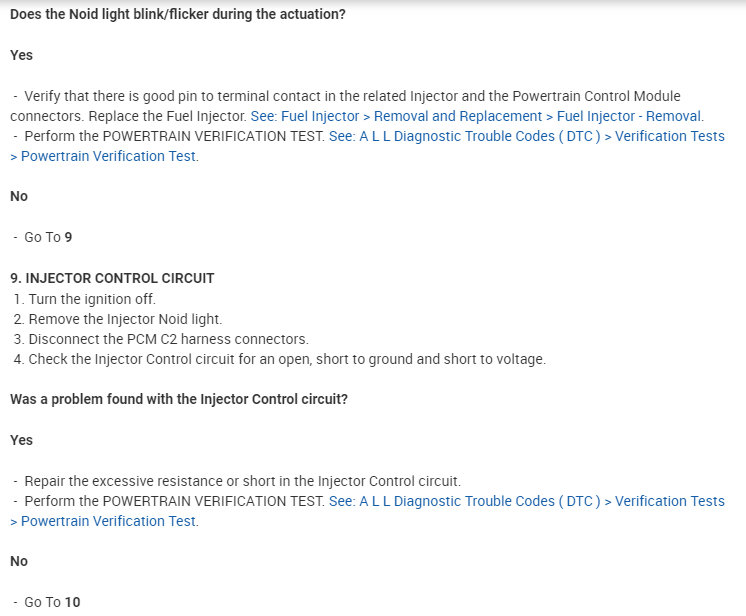

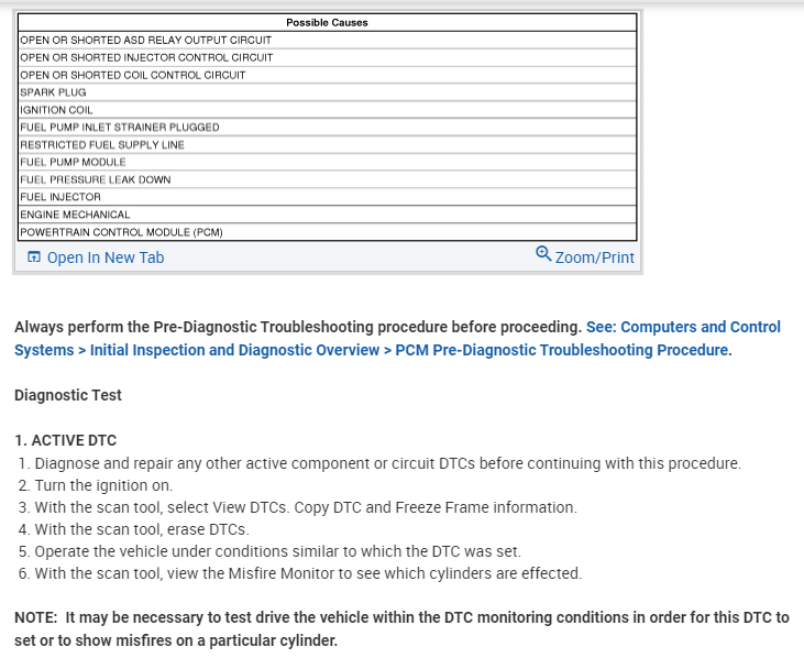

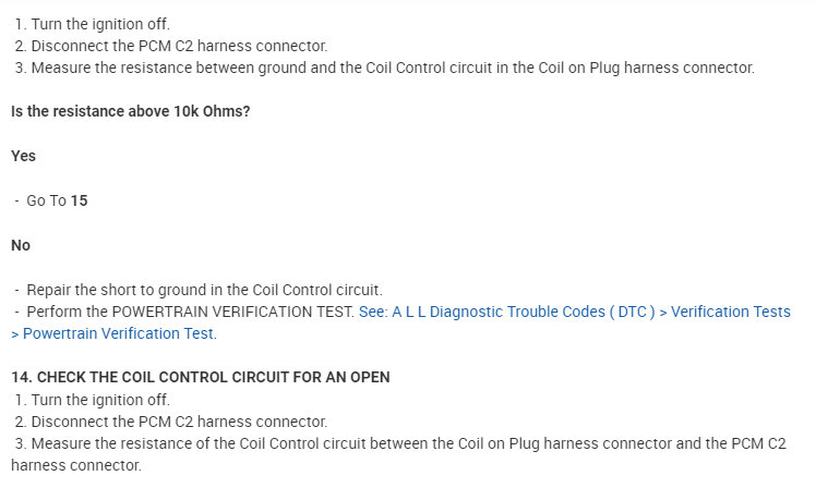

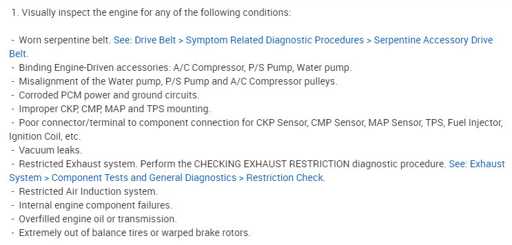

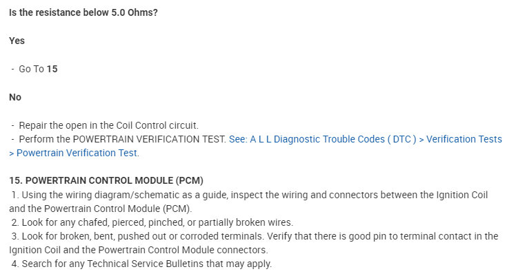

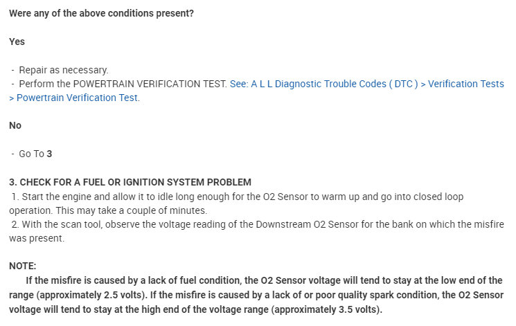

Here is a part 2 response for code P0300. See attached below. If you don't have access to a noid light set or a fuel pressure tester your local auto parts stores usually have a tool loaner program and will rent you one.Here are a few tutorials showing what is involved:
Again hope this helps and thanks for using 2CarPros.
Danny-
