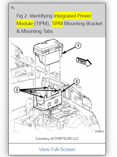

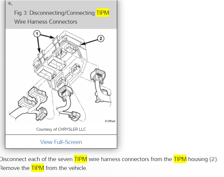

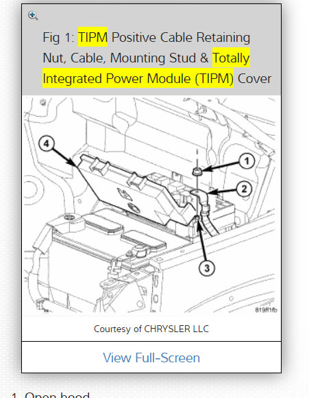

It sounds like you shorted out the TIPM module which is common to go out anyway. To be sure this video will help do a CAN scan to confirm the issue with instruction in the diagrams below on how to change the TIPM which is easy because it self initializes.
