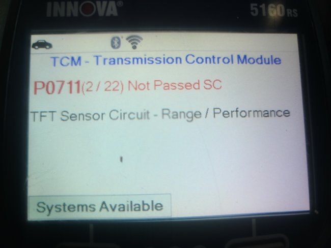

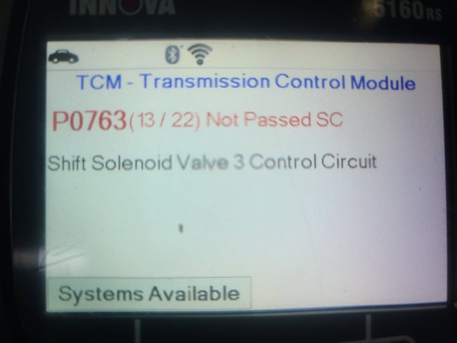

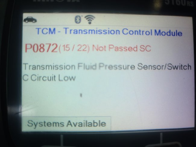

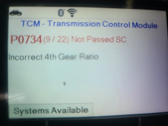

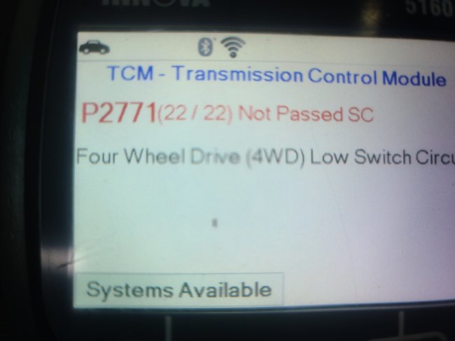

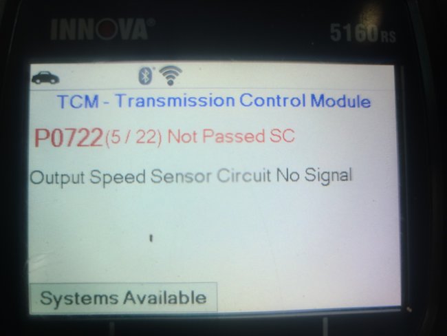

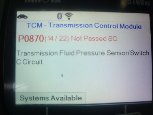

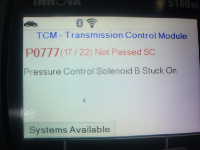

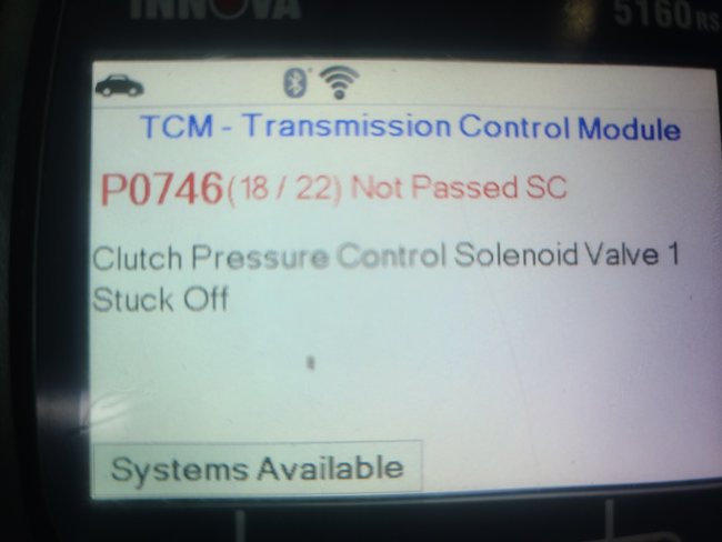

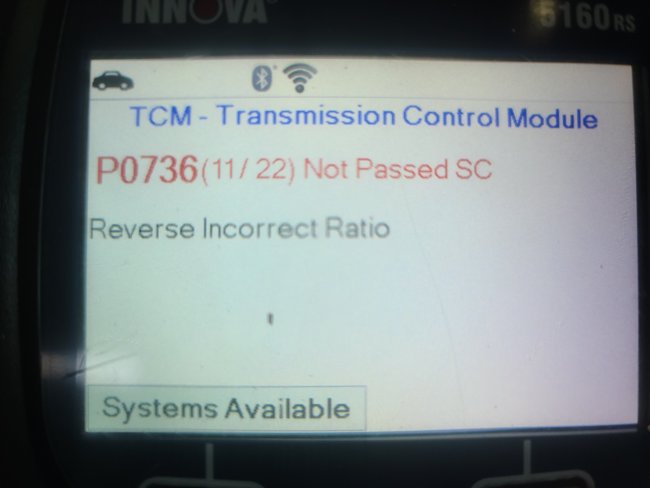

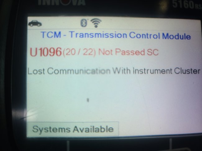

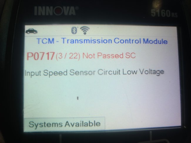

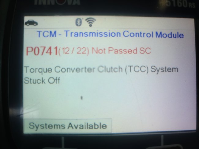

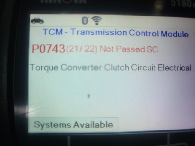

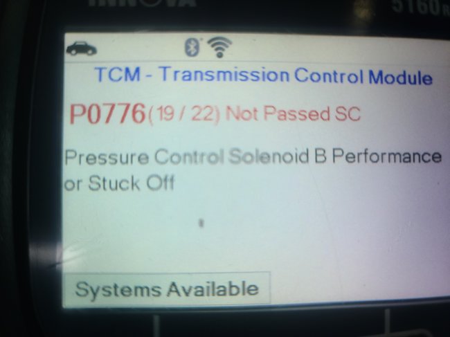

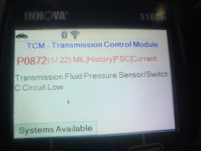

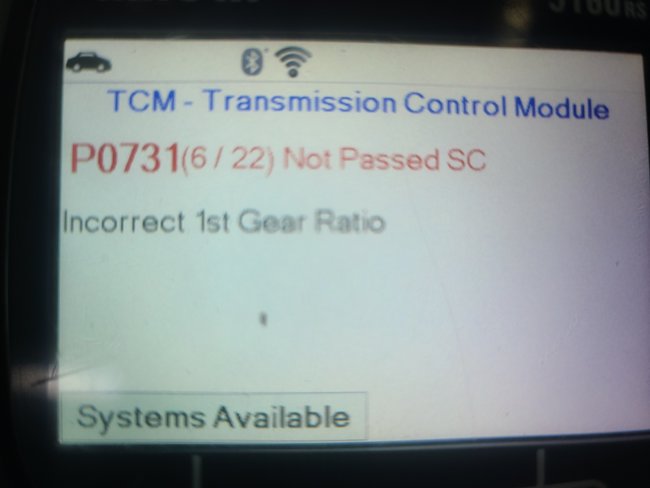

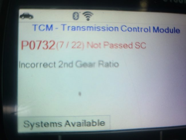

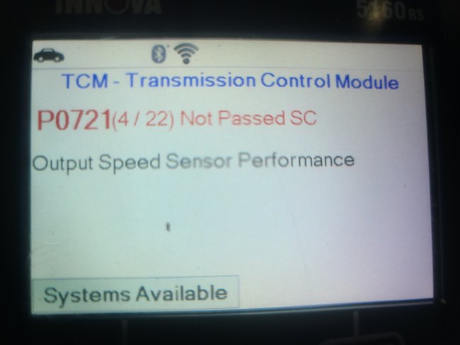

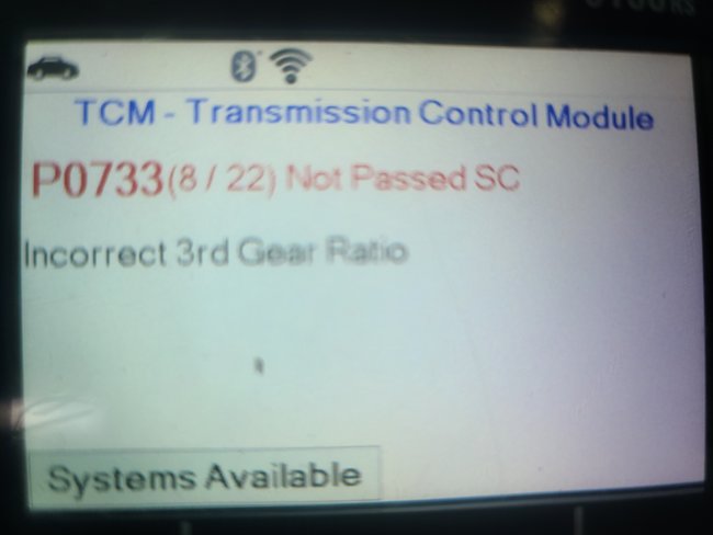

Cont. For some reason the pictures of the codes did not upload with original question. Here are the current active codes hard codes.
May 30, 2022 at 10:33 AM

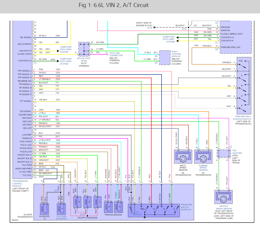

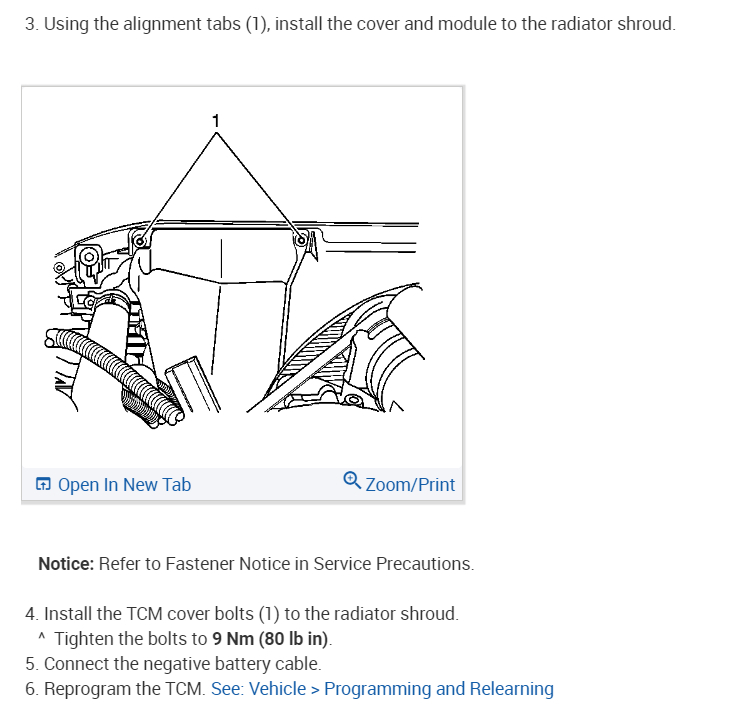

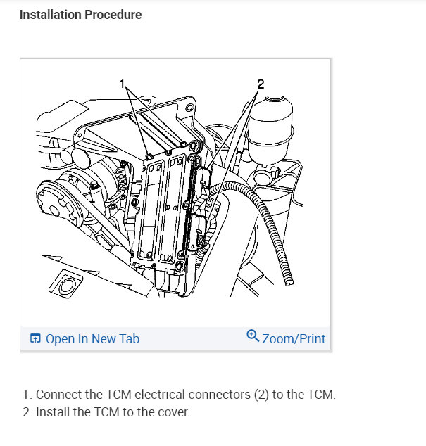

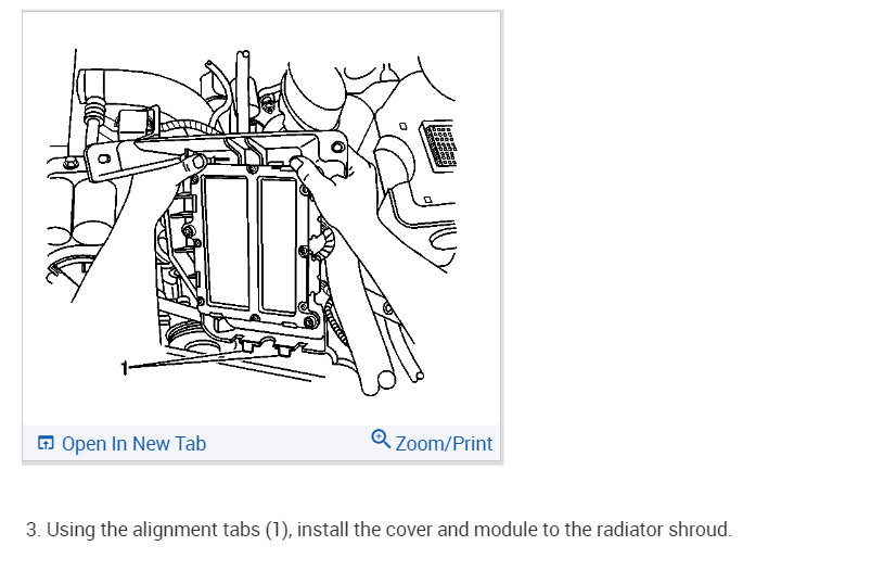

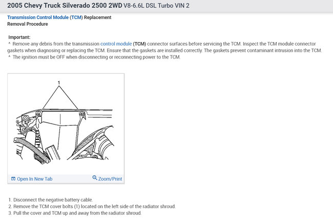

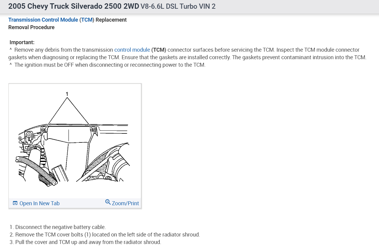

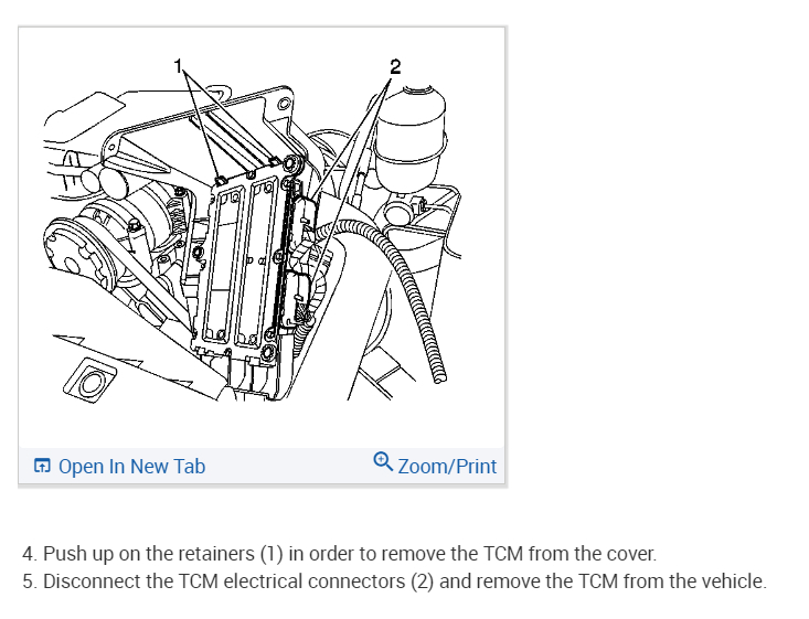

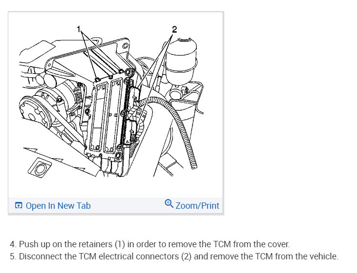

Yes, with this many problems it is pointing toward the TCM needing to be replaced. Here is the location and instructions on how to do so in the diagrams below. Also, you can do a CAN scan to confirm the failure before you begin. This guide and video will show you how:
https://www.2carpros.com/articles/can-scan-controller-area-network-easy

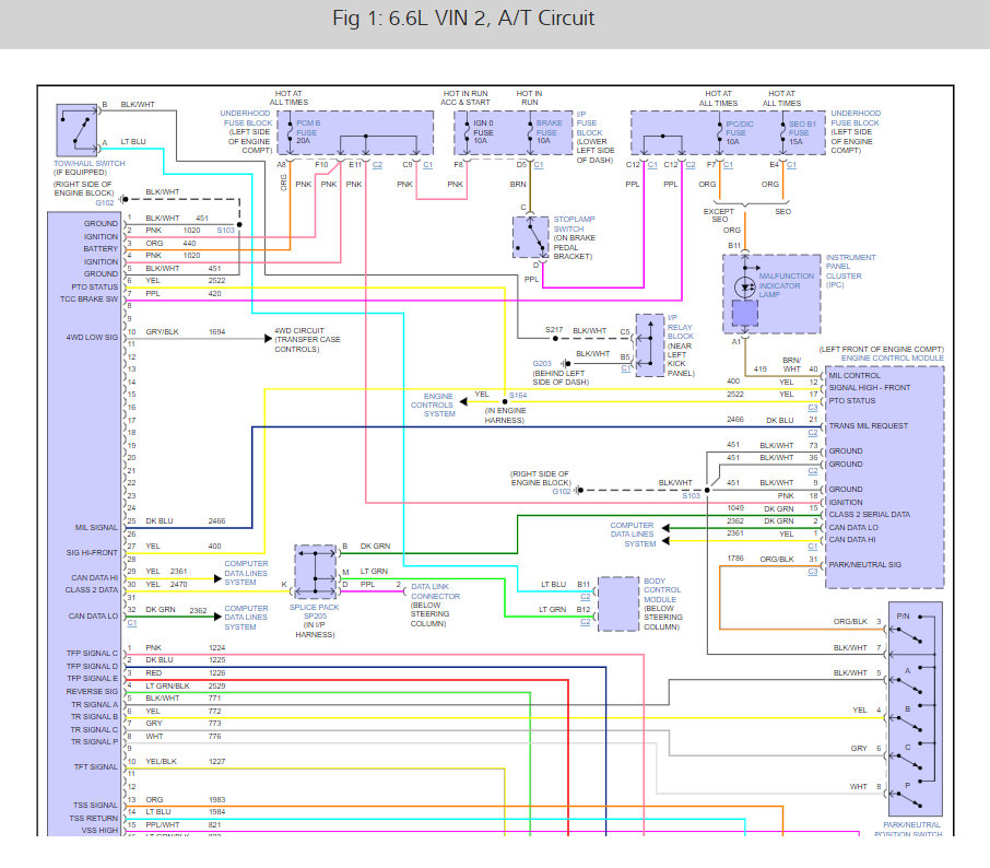

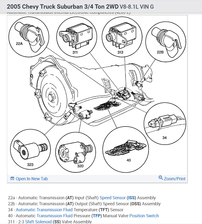

Nice work finding the issue. here is a TCM wiring diagram, so you can see how it works and what the wires go to in the TCM, also a guide to help test the connections as well.
Check out the diagrams (below). Please let us know what you find.

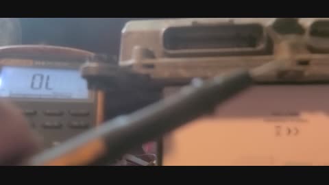

Hi Ken, well, I made a 16g x 10 wire harness x2 along with a male end running into the transmission, fixed a couple wire ends, as I mentioned above, after taking them apart, they were more superficial, but still, I fixed them.
I checked the continuity of the whole harness. TCM to transmission, to fuse box, to under dash, you name it, I followed it. All ohmed out at .3 to .4 at the highest. So, my trouble shooting skills from when I used to be a heavy equip tech kicked in finally and said "hey let's check the TCM" mind you I sent it out, and got it back, the people claiming they tested it. So, grey connector side, TCM out of the truck, on a flat surface, I probed 1 pin, and then checked it across to red side, and yes. over 1 ohm. So, I managed to find multiple pins, which crossed over to the red side, and yes, I can see that happen to a point, but I shouldn't have a dead short on case when testing the pins. Red and Grey side, I had multiple pins that ohmed out as a short to housing of TCM. 1.0ohm on up randomly up and down to no less than 1, I think I had a 500ohm there at one point.
But, with that said, ground is fed to the TCM by plug from the body. The magnesium case or pot metal or whatever the case is made out of shouldn't show continuity to the housing of the TCM correct? Anytime working on equipment, if I had a short to housing ohming connectors and pins that was the last nail in the coffin to confirm bad ECU or ECM.
So, if you can read this and let me know your thoughts, I would really appreciate it. Thank you for all the assistance.
Jun 13, 2022 at 4:08 PM

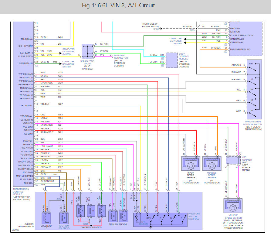

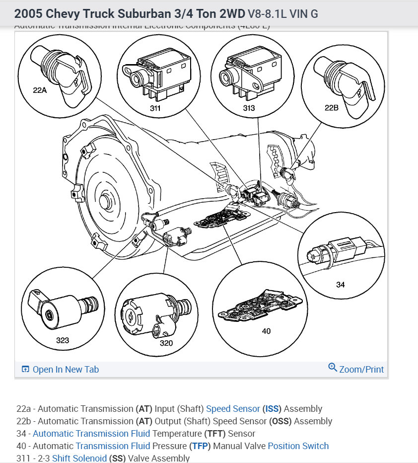

The housing of the TCM can be grounded yes, the ohm reading sounds normal, but I was looking at the codes again and it could be the input shaft sensor is not working correctly. or the transmission may be slipping. We can try the sensor first. Here is the location. Check out the diagrams (below). Please let us know what happens.

Hi Ken, I already replaced the output speed sensor the other day. Here is a crude video of the TCM test. We'll as pointed out by someone else, the transmission can't slip if it's not in gear and throw codes about all the gears being incorrect ratios. Basically, what I was told was, how can the TCM determine gear ratio, without being driven? Or throw a multitude of codes, just by putting it in drive without moving. I put it in park, reverse, neutral no codes. The moment I put in drive within 3 seconds I have 30 codes that pop up and basically throws every single code the transmission has? And locks into 4th.

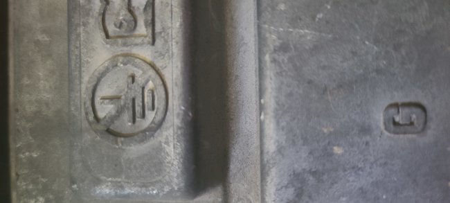

Also, I am pretty sure you cannot ground that TCM, due to this symbol, that's the symbol for ground with a big circle and cross out on it.
Jun 14, 2022 at 10:34 AM
Thanks for the video, it sure sounds like the TCM is bad. I have seen where the PCM goes bad and effets the TCM but it's rare.

1- replaced TCM with junkyard (eBay) TCM - 01 to 05 TCM does not need to be programmed or vin flashed, it will work as a plug and play TCM.
Unless you wanted to be picky to having everything match then you can have it vin encoded, but, i purchased one off eBay for $150 dollars, plugged in ... 1 TCM code ... P0872 stuck solenoid. It's my only code for the TCM instead of the 25 plus i was getting (i have to work outside so it looks like rain and i will get to it in a day or so)

2- the other code I am getting is the U1096 - unable to communicate with the dash, not sure what to do about that one yet, because that was in the list of codes as well. figured I would get to this stuck solenoid first.
Any suggestions on that code? U1096

hmm, I have seen the instrument clusters go out causing the communication error U1096 and this can cause the TCM to seem bad as well, that is the problem with CAN systems, one controller can affect another. This is why I like to do CAN scans. Let me know how it goes.
