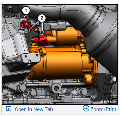

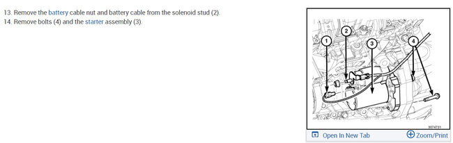

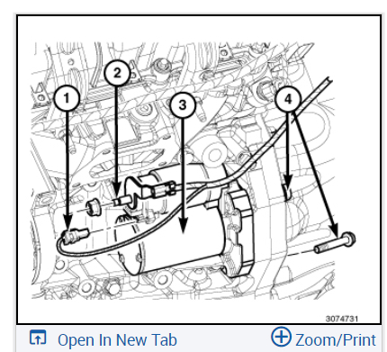

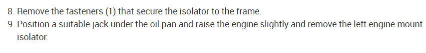

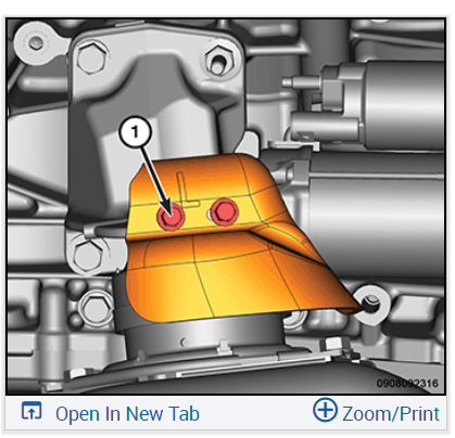

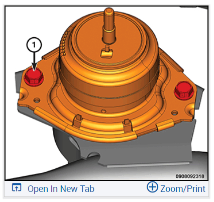

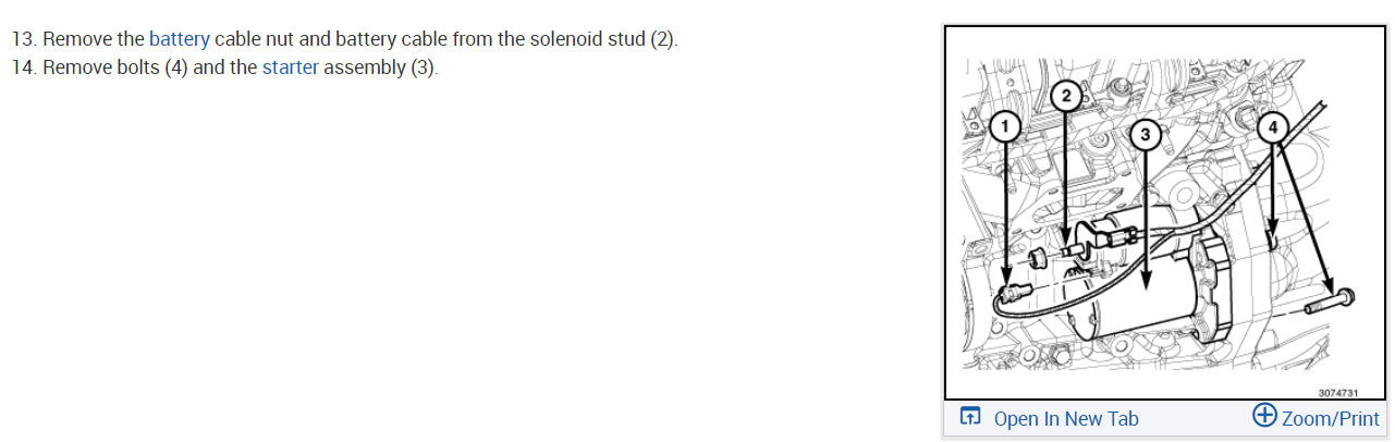

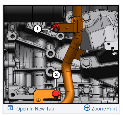

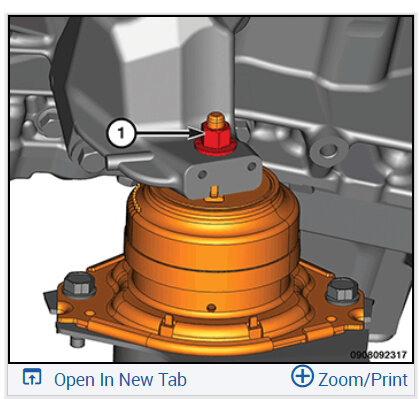

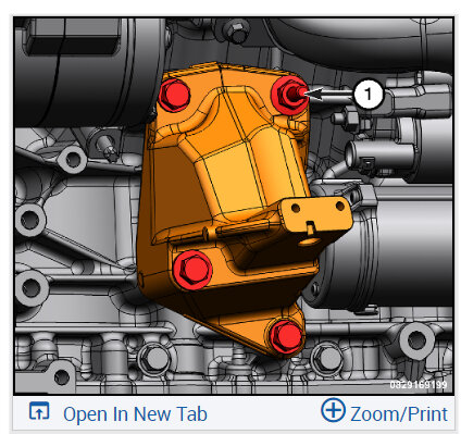

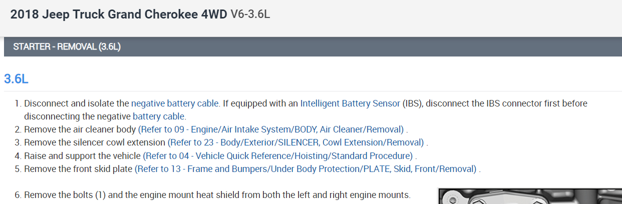

Yep, the only reason for this is bad starters, I would say the connections are bad but then the problem would be with the connection itself, I would make sure the connections are clean and tight at the battery and starter motor. Here is how to change the starter motor correctly. You might want to try a Denso or OEM unit. Check out the images (below). Please let us know what happens.
