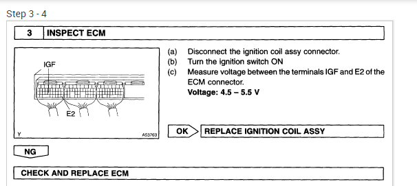

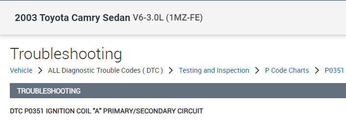

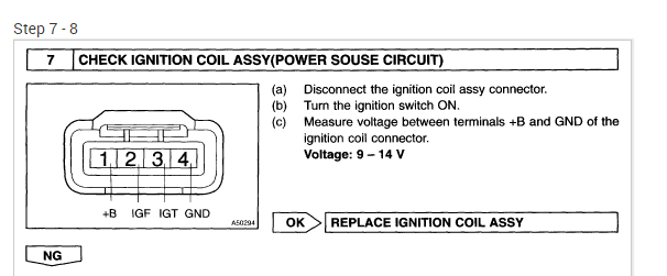

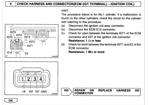

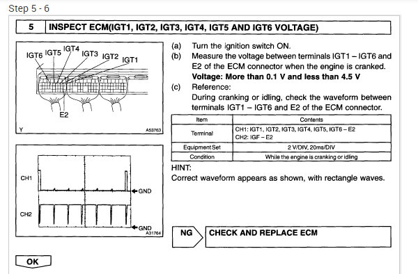

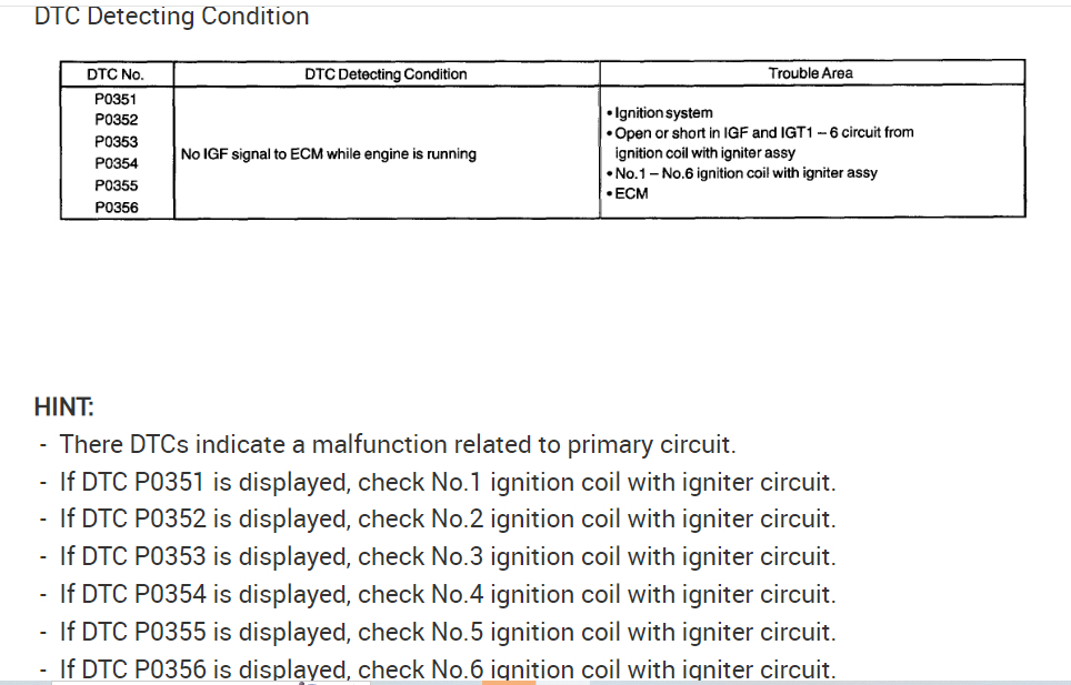

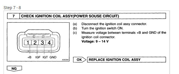

The original code indicates there isn't a feedback signal from the ignitor indicating the coil is working. I'm not sure what may have changed since the work was done. Have you checked to see if there are additional codes stored now?

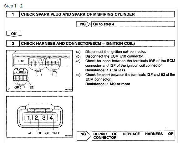

As far as testing, I attached the diagnostics for the P0351 code below. Note that all cylinders can be checked using the same process. Take a look through them and let me know if you are comfortable performing them.

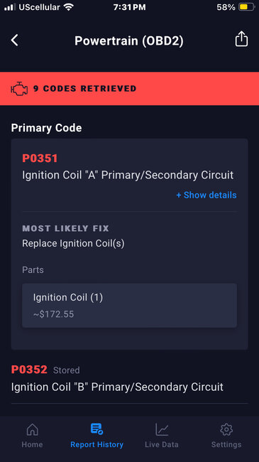

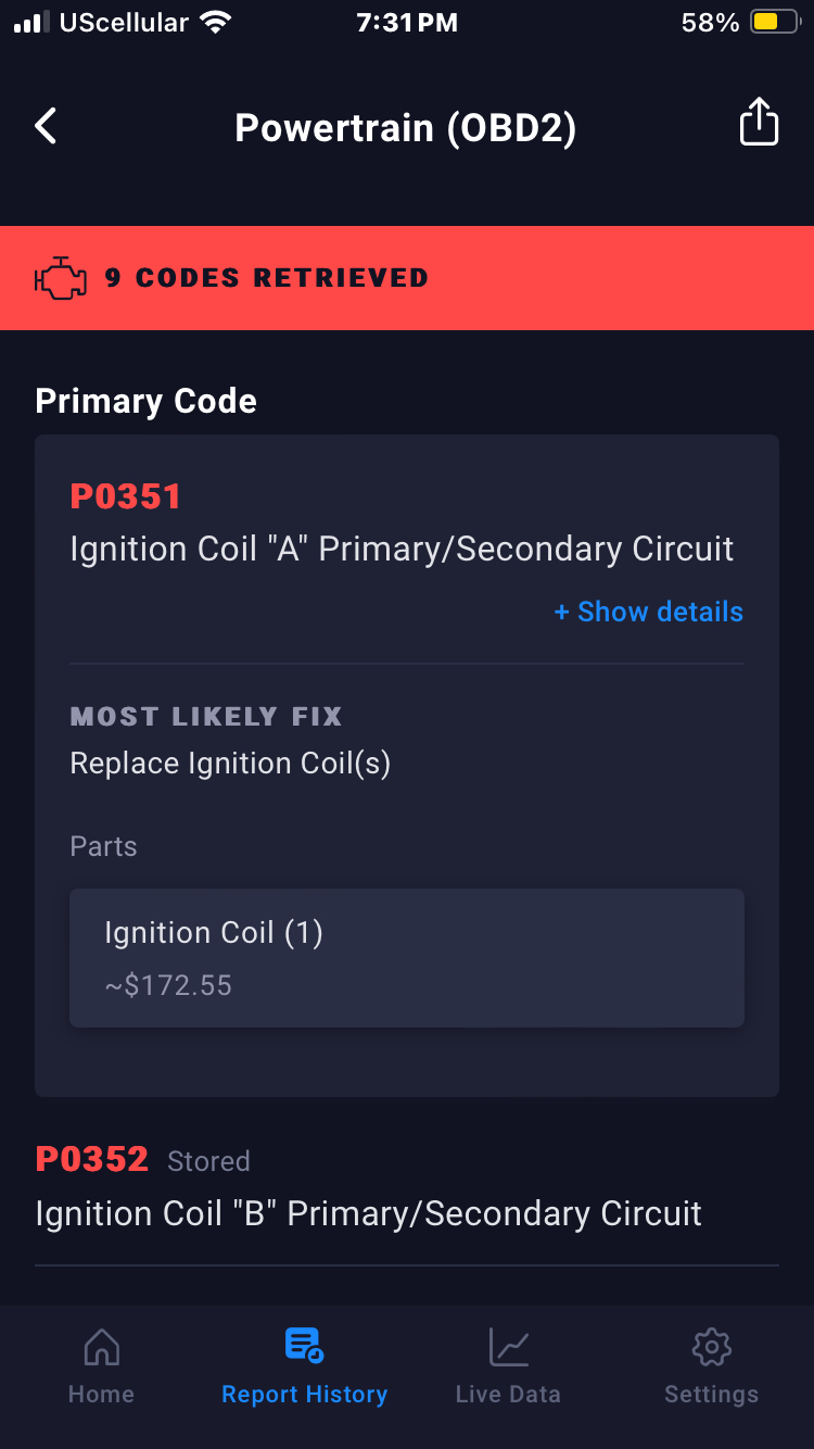

The codes are as follows, but I have another problem now my battery is dead so I have to charge it.
Jun 26, 2024 at 4:33 PM
Is the battery issue due to trying to start the engine? I ask because a weak battery or low voltage can cause all types if electrical issues.
As far as the codes are concerned, the only active one is the P0351. That will require the diagnostics I attached above. Let me know if you are comfortable performing them. Additionally, let me know about the battery. Once it is recharged, you may want to have it load tested at a parts store. Most will do it free of charge.

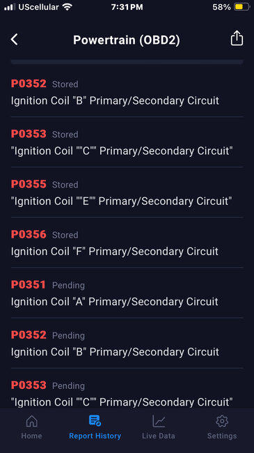

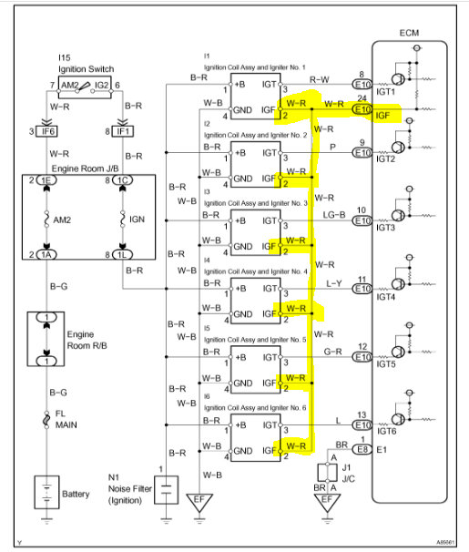

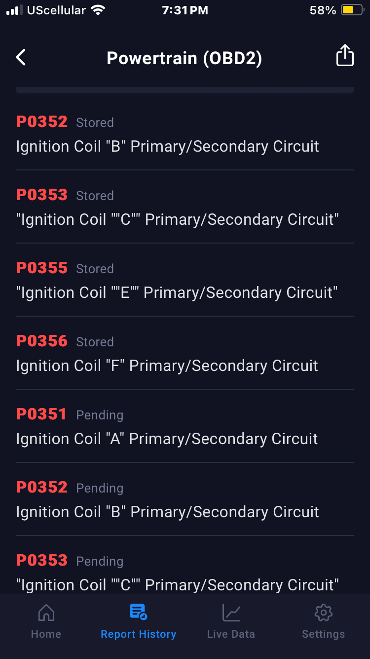

Okay, i have charged the battery and it's up to full cap now. i cleared the codes and the came back PO 351, PO352, PO 353, PO 354, PO355, and PO356.
Jun 27, 2024 at 4:33 PM

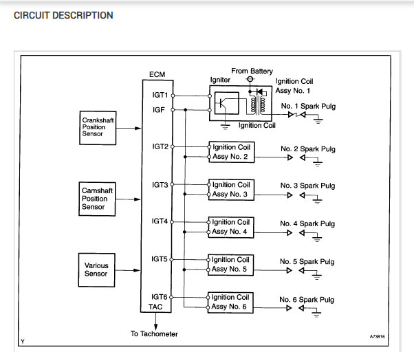

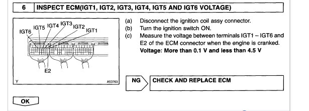

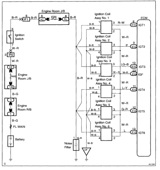

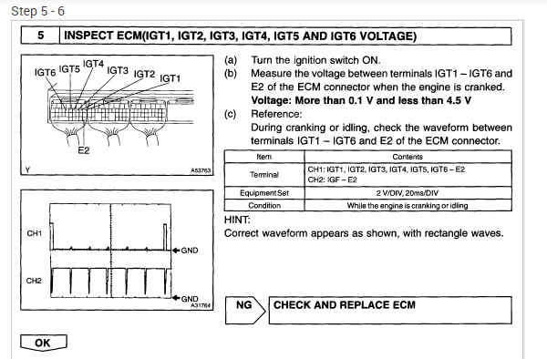

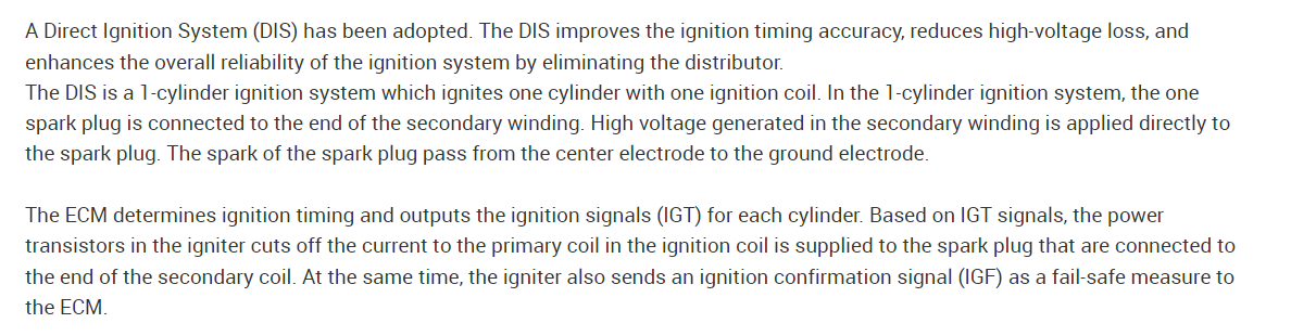

The ECM is indicating there is no feedback from any of the coils. It is very unlikely that all coils failed.
Since all six coils have a common IGF wire to the ECM, that is where I would start checking. The wire may be damaged or there could be an issue with a connector. Worst case is the ECM has failed.
Each coil should have a white wire with a red tracer. This wire ties all of the coils together and then goes to the ECM. See if you are able to locate the wire I'm referring to and check it for damage.
See pic below.
Jun 27, 2024 at 8:28 PM

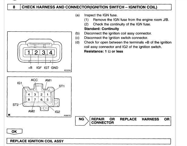

Okay, where do I get a larger photo of this? It is also I cannot just buy the harness for the coil packs the have to be hard wired in. Fuses are good in both places, so it is very likely I have a voltage drop going to the ECM. Also, I need the colors and the pin set for each coil. Please. However, if this wire puts the all the coils in a series there could be just one failure point or multiple failure points in this wire.

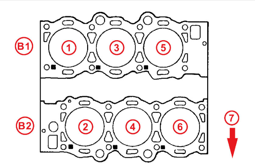

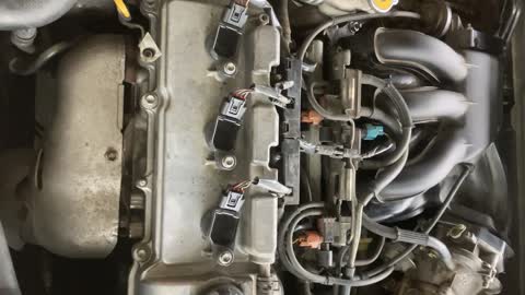

I'm not sure what you need. the wiring schematic above shows the coils and the wire colors.
If you follow the IGT wire back to the ECM, it shows IGT 1, IGT 2 and up to six. Those are the cylinder numbers. If you look at the pic below, I included the cylinder configuration. That way you will know which cylinder to look at. Additionally, the arrow in the picture points toward the front of the vehicle. Therefore, bank 1 is nearest to the firewall.
Let me know if this helps.
joe
See pic below.
Jun 29, 2024 at 7:32 PM
