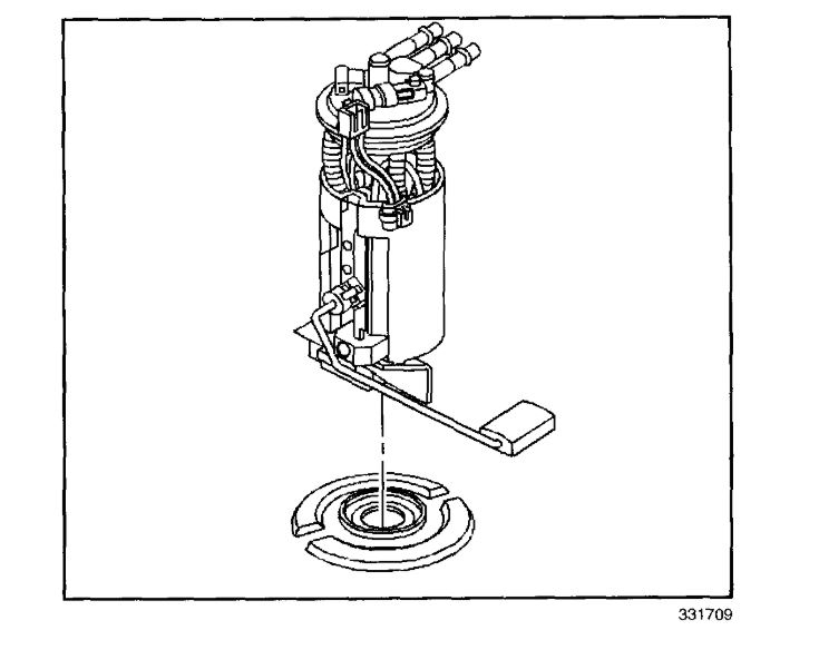

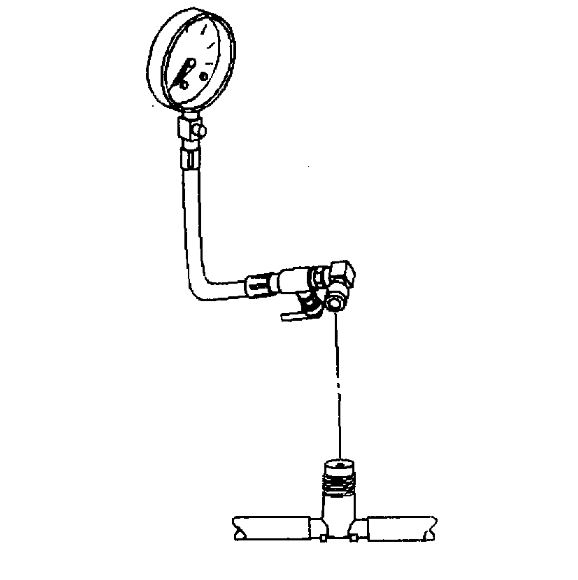

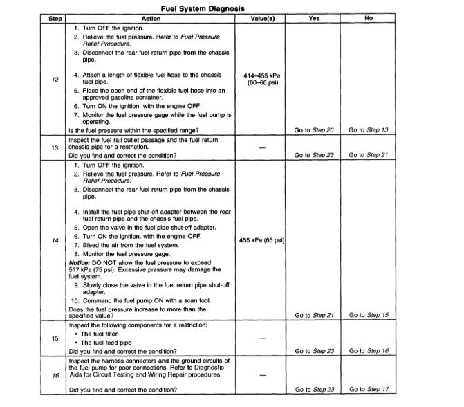

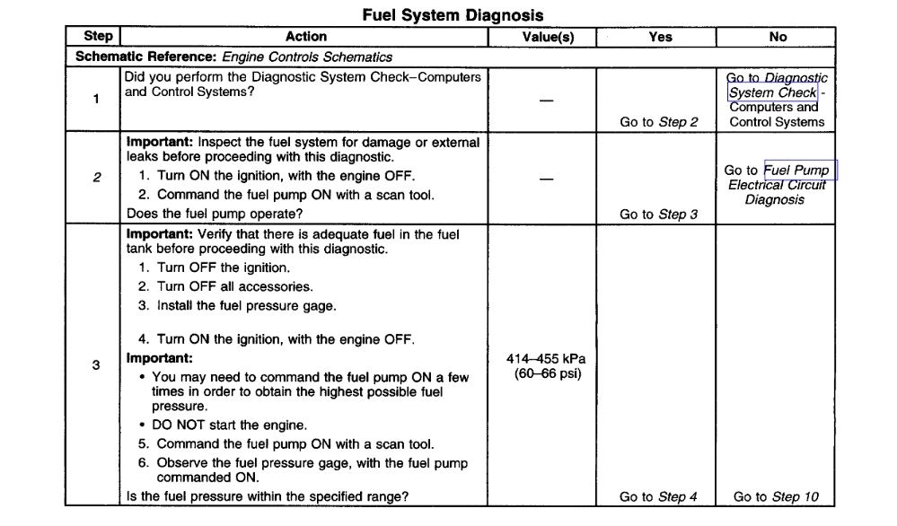

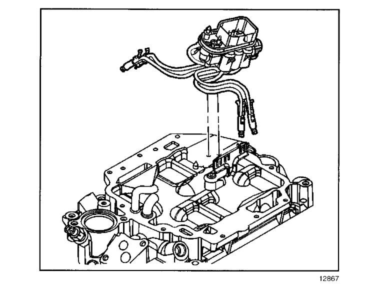

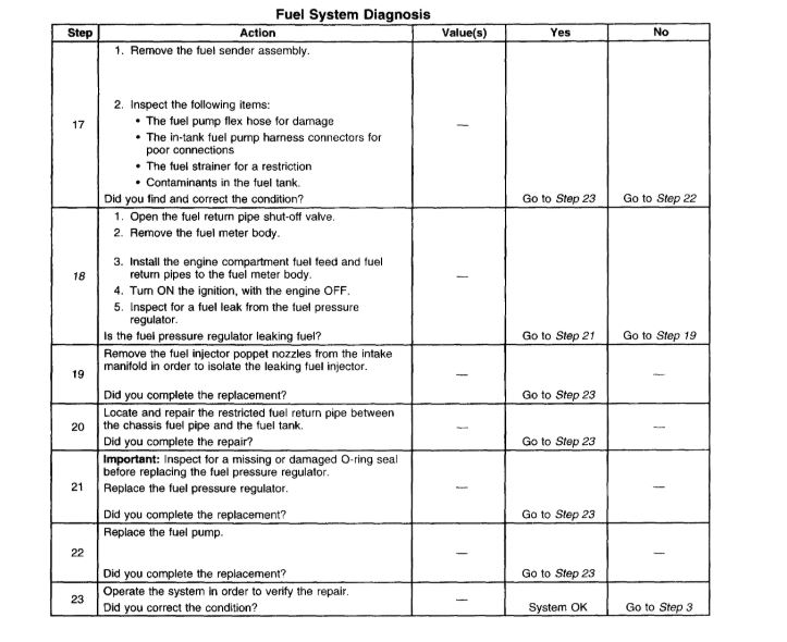

I would check the fuel pressure. Low fuel pressure is the most common cause for this issue.
https://www.2carpros.com/articles/engine-misfires-or-runs-rough

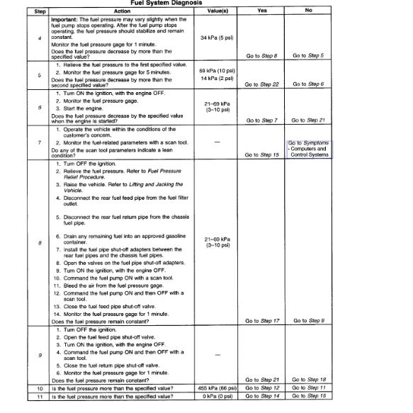

I attached a flow chart for the fuel system fr you to follow and you need a gauge to hook up to test the pressure. It could be the fuel pump or the spider assembly.
