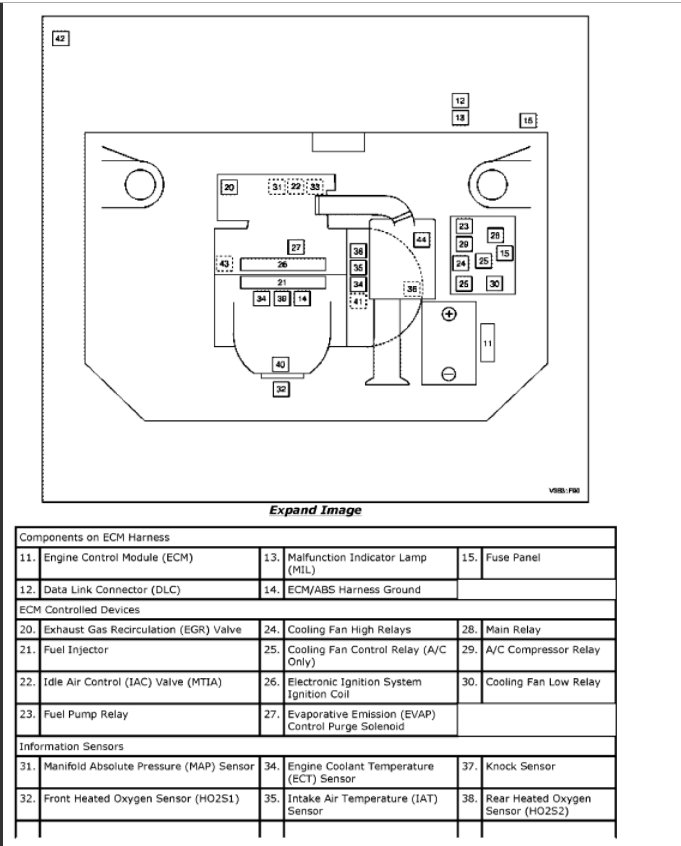

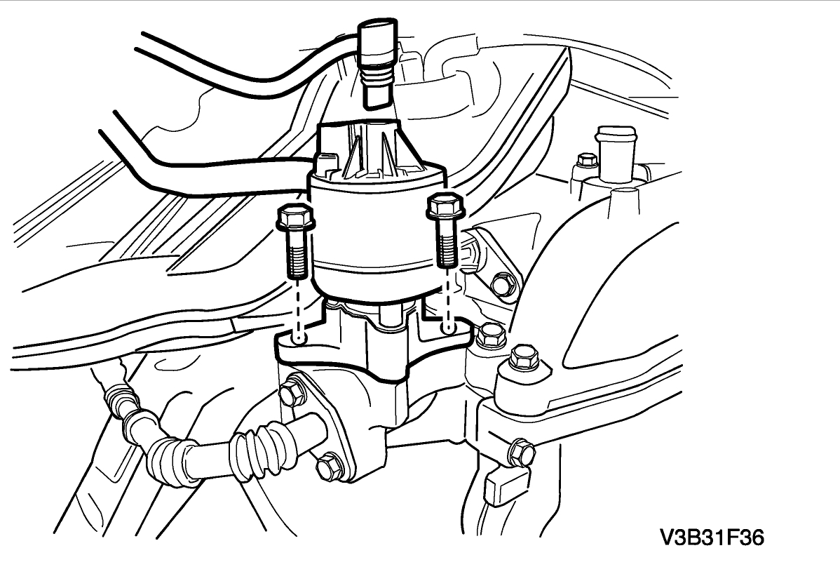

I would think that the open EGR will cause all of these problems. Here is a video and a diagram (below) to help you with the test:
https://youtu.be/DqUCbbKdWf4
They had problems with that style of valve.
Please let us know what happens so it will help others.
