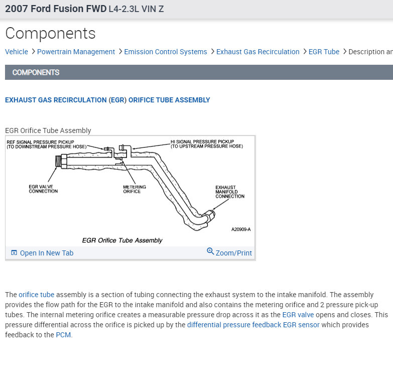

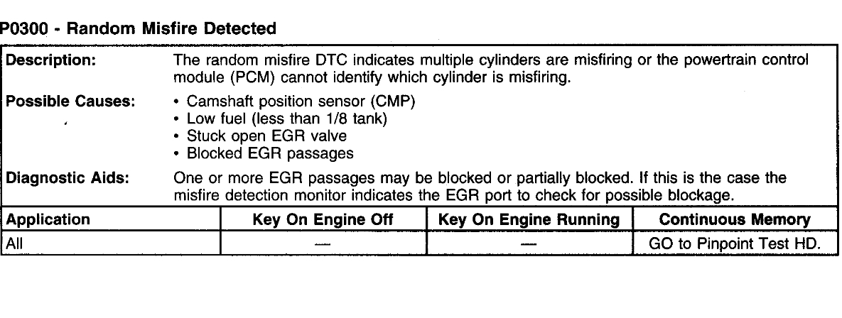

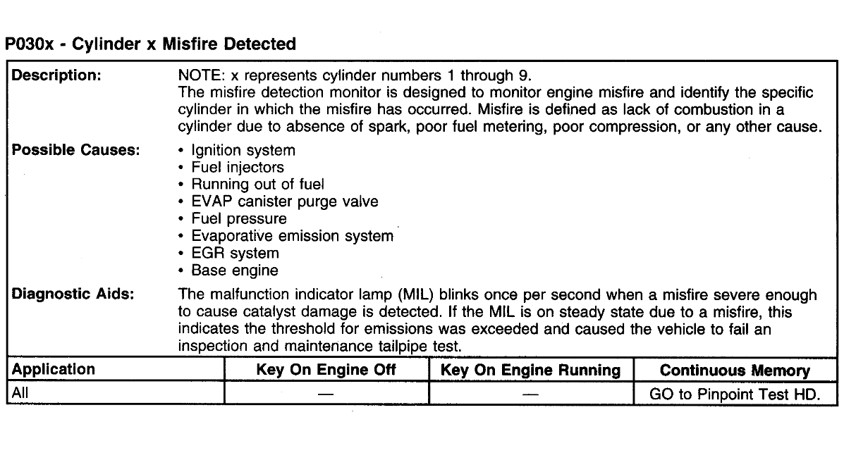

Those random misfire codes can be caused by a number of components/reasons.
It could be due to faulty fuel injectors, blockage in the EGR system, bad EVPA purge valve, improper fuel pressure, it can also happen due to having low fuel and of course due to spark plugs or coils.
https://www.2carpros.com/articles/engine-misfires-or-runs-rough

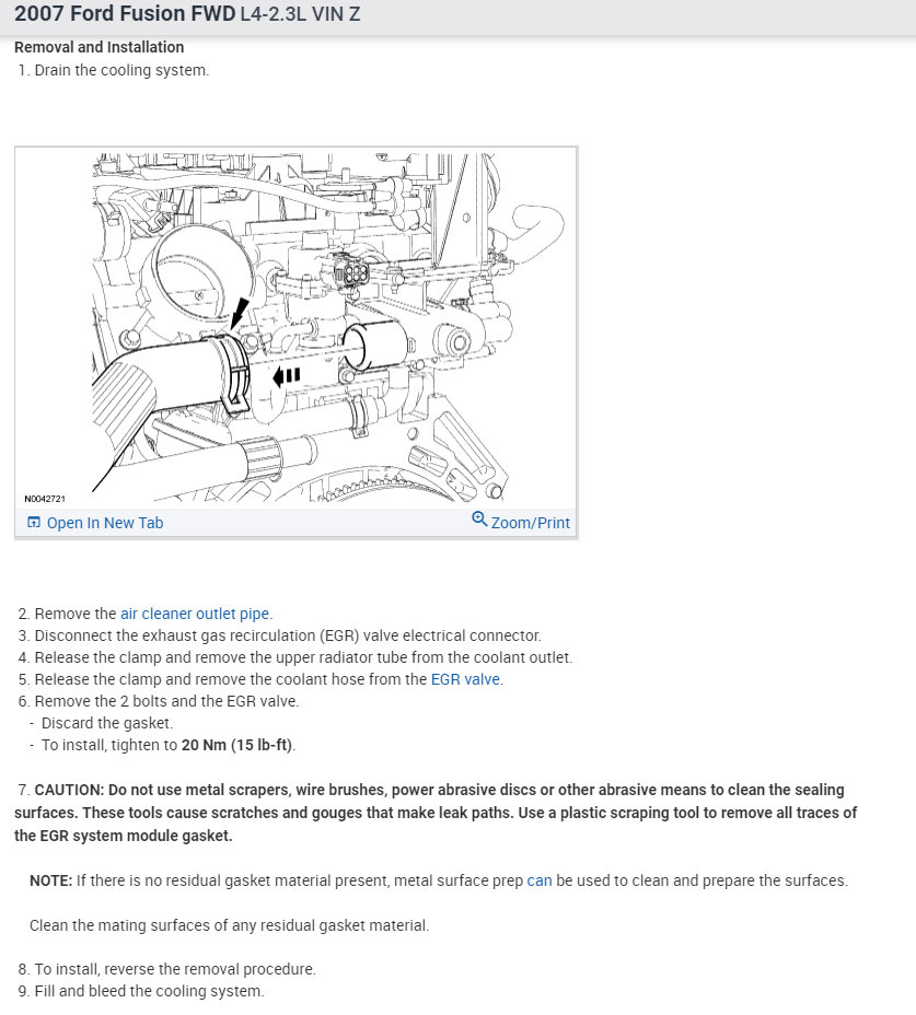

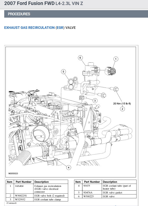

As you have already done the injectors and plugs, checking and cleaning the EGR system would be a good next step.
https://youtu.be/DqUCbbKdWf4
Are there any other codes besides these random misfire codes?
Let me know of any questions.

Thanks for the incredibly thorough response. I'll try to check the EGR system or find someone qualified to do it.
I just picked up an OBD reader today and checked the misfire counts: 148 on cylinder 1, and 175 on cylinder 4. Are EGR, EVPA purge valve, or fuel pressure likely causes if it is very consistently in these 2 specific cylinders?
