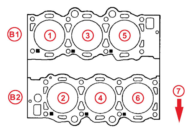

From the data i have cylinders 2,4 and 6 are the front 3 cylinders, bank 2.
You have codes for -
Random misfire and misfires on all of bank 2 (P0300,P0302,P0304,P0306)

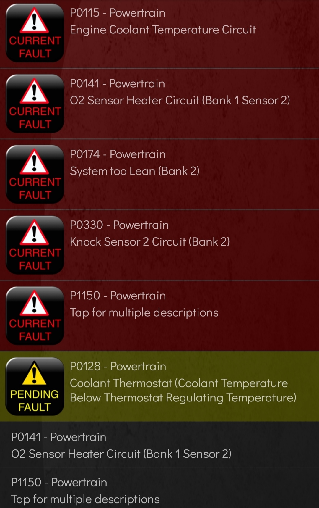

The misfire, lean and rich codes started it all. The car was stalling and had very poor gas mileage.
That was when the mechanic started trying to investigate the cause by changing the fuel pump, the spark plugs and the MAF sensor. There was no success. Then they attempted the timing belt fix and it still didn't solve the problem.
The initial codes are in the image attached.
