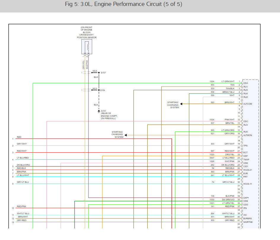

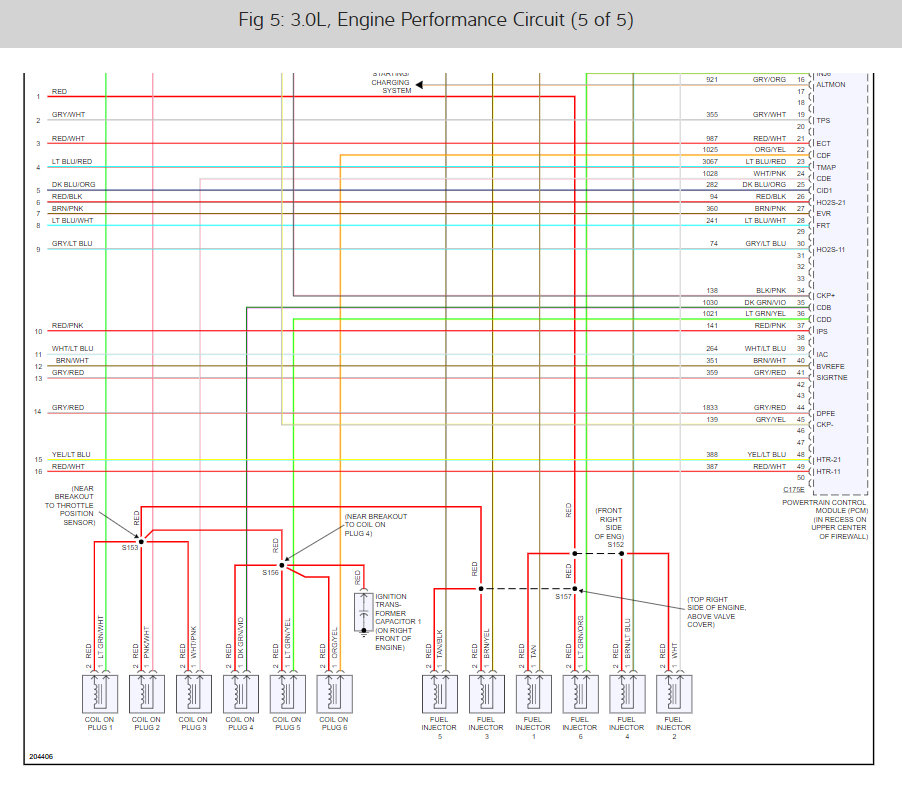

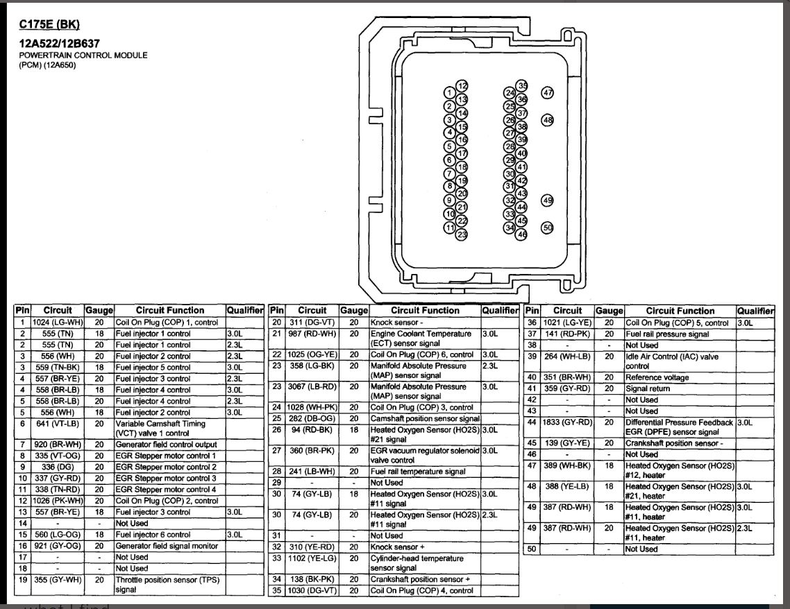

With key on (not running):
Test light connected negative battery terminal to solid red wire on coil connector = light on.
Test light connected to positive battery terminal to orange/yellow wire on coil connector = test light on . Ran the same test on coil # 5 = no light on light green/yellow wire .

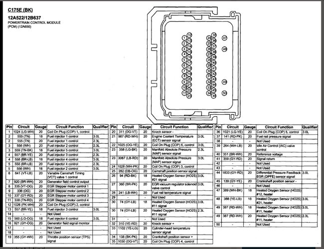

My PCM is a 3 connector type , I would appreciate some help with the proper wiring color/punch out diagram for isolating further this apparent short to ground.
Your assistance is greatly appreciated.
Sincerely, Ian
Sep 2, 2019 at 2:50 PM

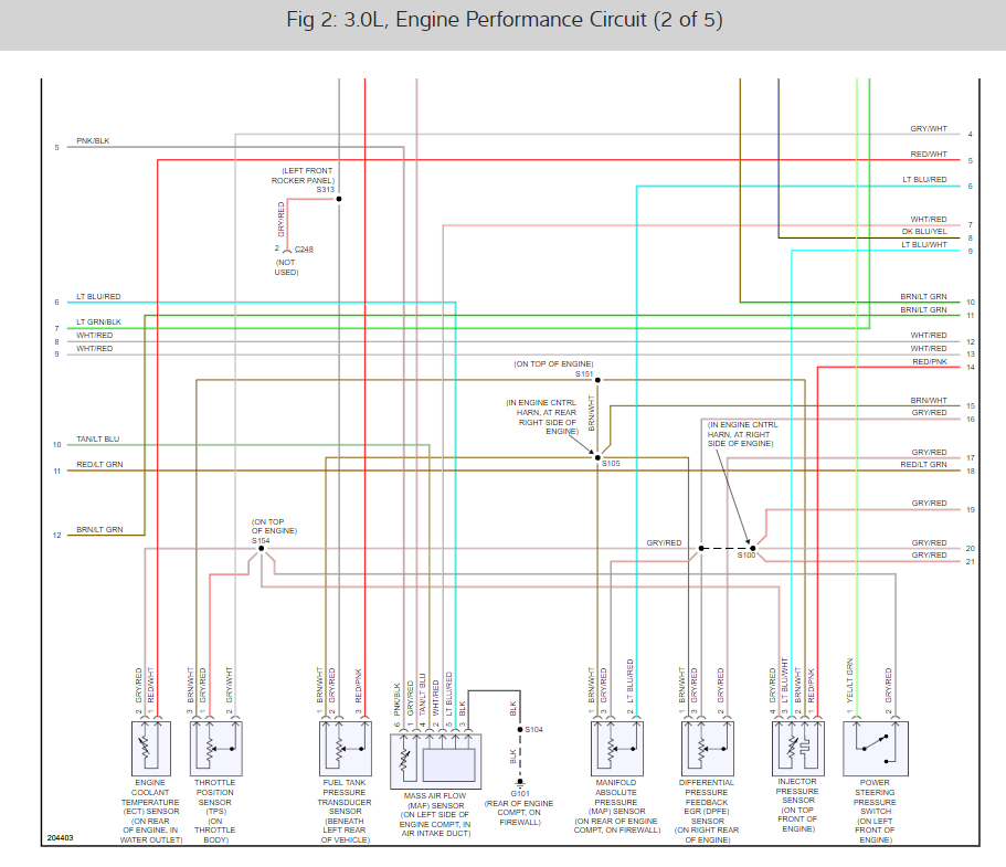

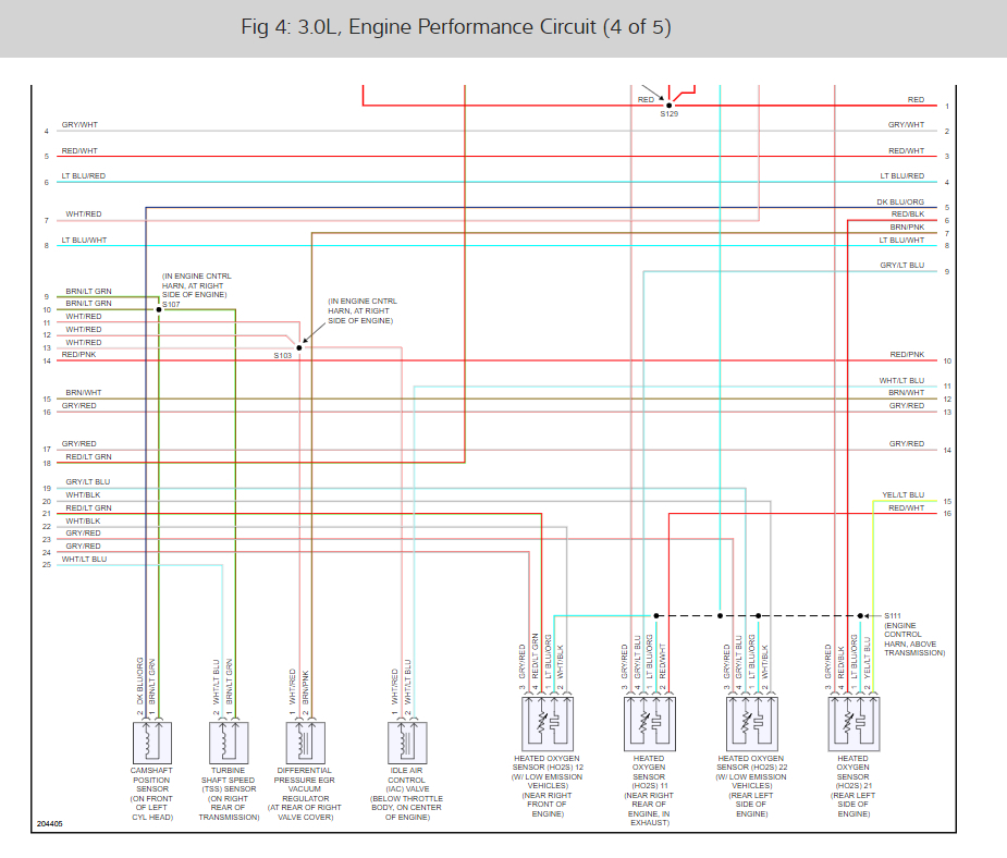

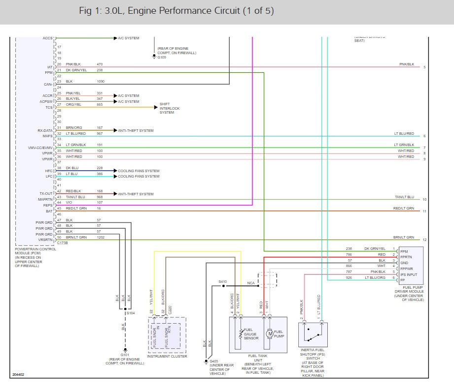

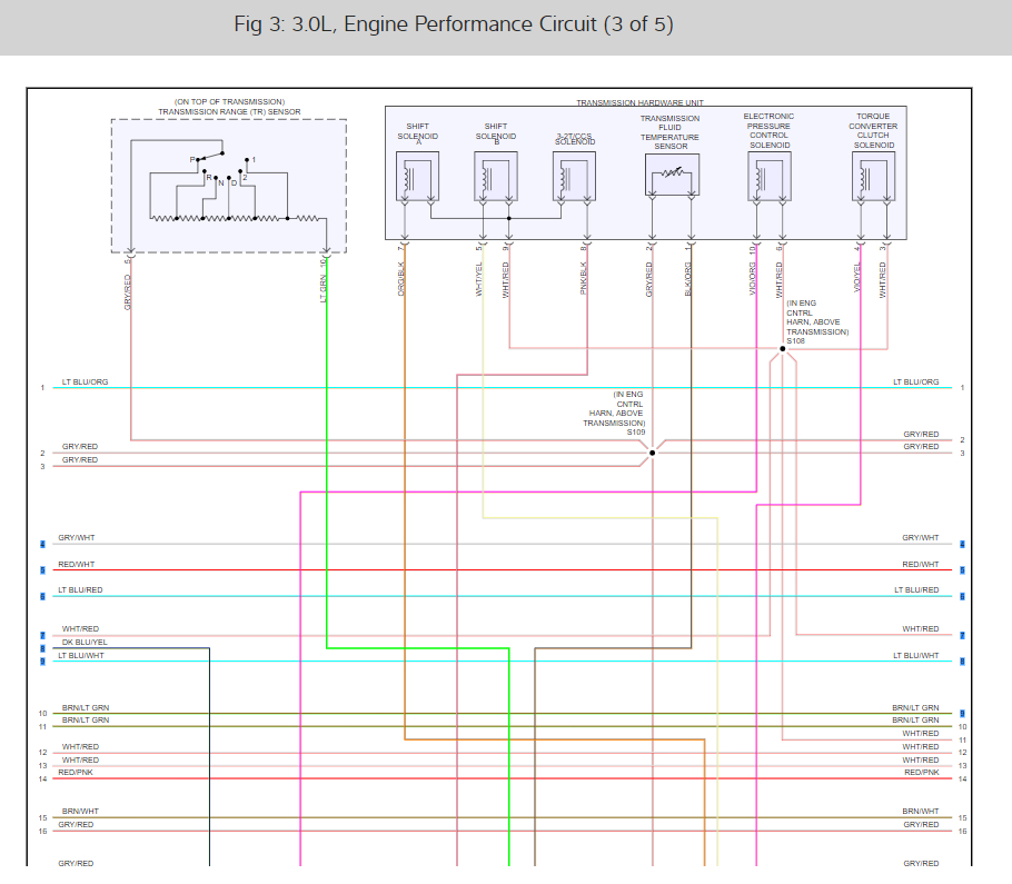

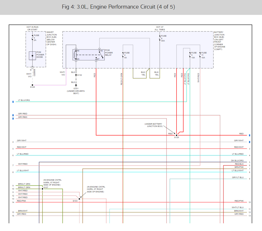

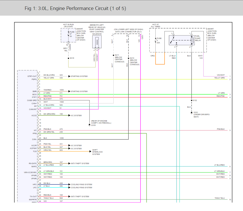

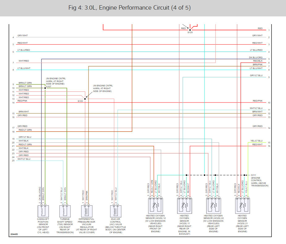

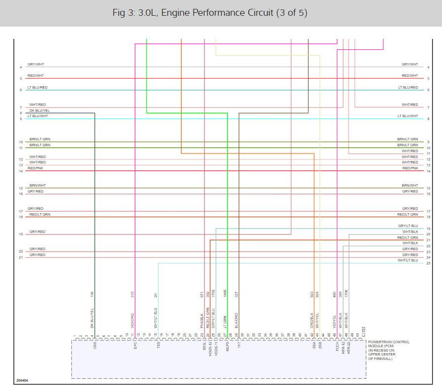

Here is a good guide on how to check the wiring with the engine wiring diagrams below so you can see how the system works and which injector wires to test:
Check out the diagrams (below). Please let us know what happens. Can you please shoot a quick video with your phone so we can see what's going on, that would be great. You can upload it here with your response.
Sep 3, 2019 at 6:47 PM
IAN55
  • 6 POSTS
Ken, thank you very much for the quick response and schematics . Although (diagrams 4 and 5) show this a single PCM connector, I needed the (Red coil wire diagram)(thank you for that ). Interesting during my research using 2carPros I found a previous thread for a 2005 Escape diagram. request providing the attached pinout on a 3 connector type PCM. (fyi attached ).
I did resolve my issue on #6coil / #22 pos. PCM. I ran a new wire: (in sep. loom spliced/soldered/heat shrink at both ends of connectors.) (i know not prof. protocol) but we are back up and running .
Sep 4, 2019 at 12:54 PM
Glad you could get it fixed, that kind of problem can be tough. Please use 2CarPros anytime we are here to help.
