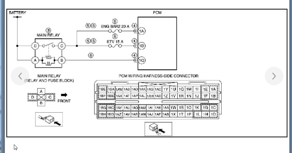

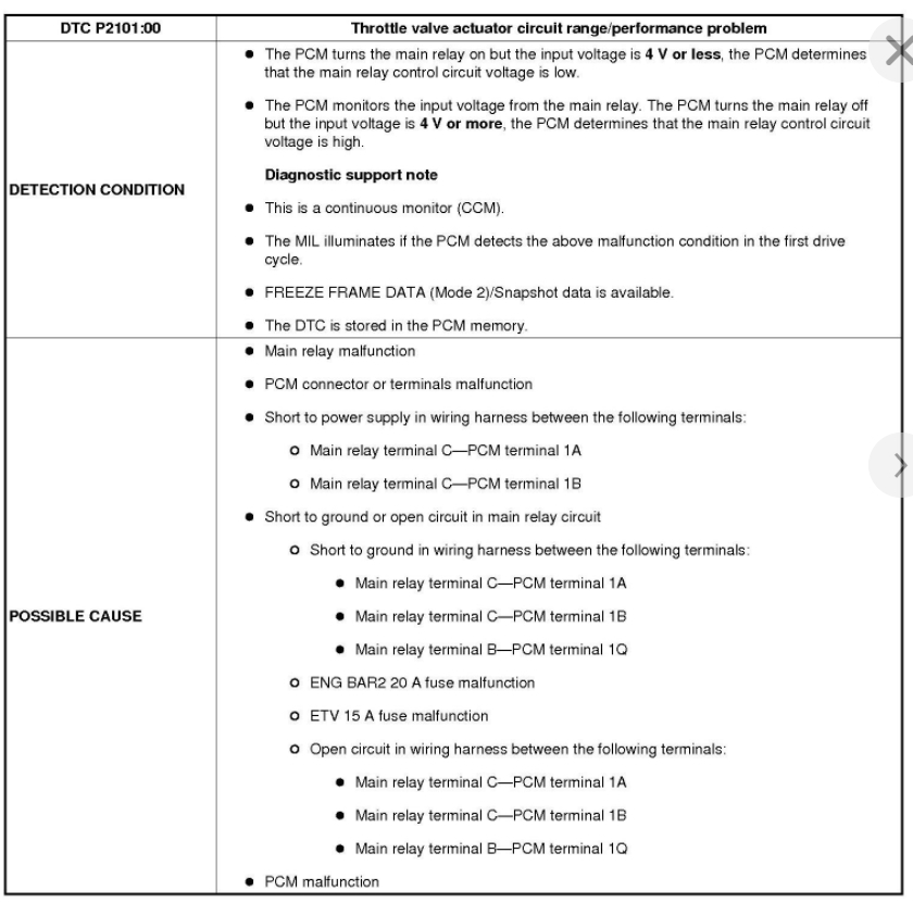

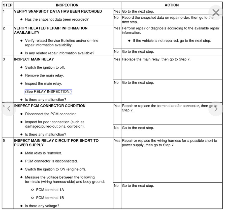

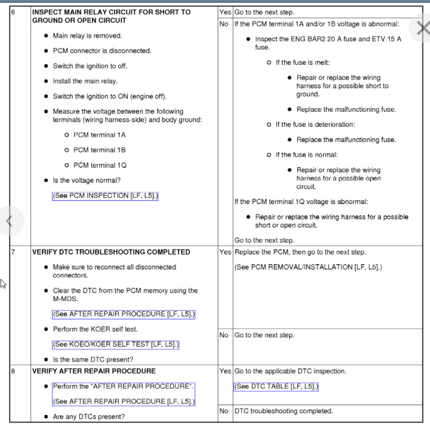

If the engine is not starting then we need to start with the P2101.
https://youtu.be/dCjmRL3p4Cs
This main relay is going to directly cause a no start so basically the PCM is not seeing proper voltage and it takes the voltage away.
Does this happen all the time? If not, then we need to start with this and go from there.
Sounds like the misfiring is a different issue so let's start with the testing below and go from there.
