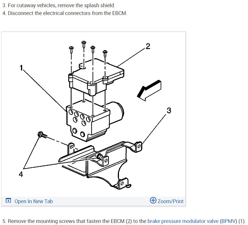

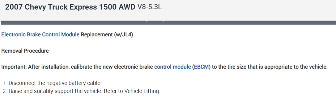

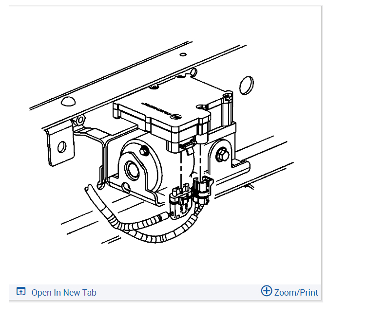

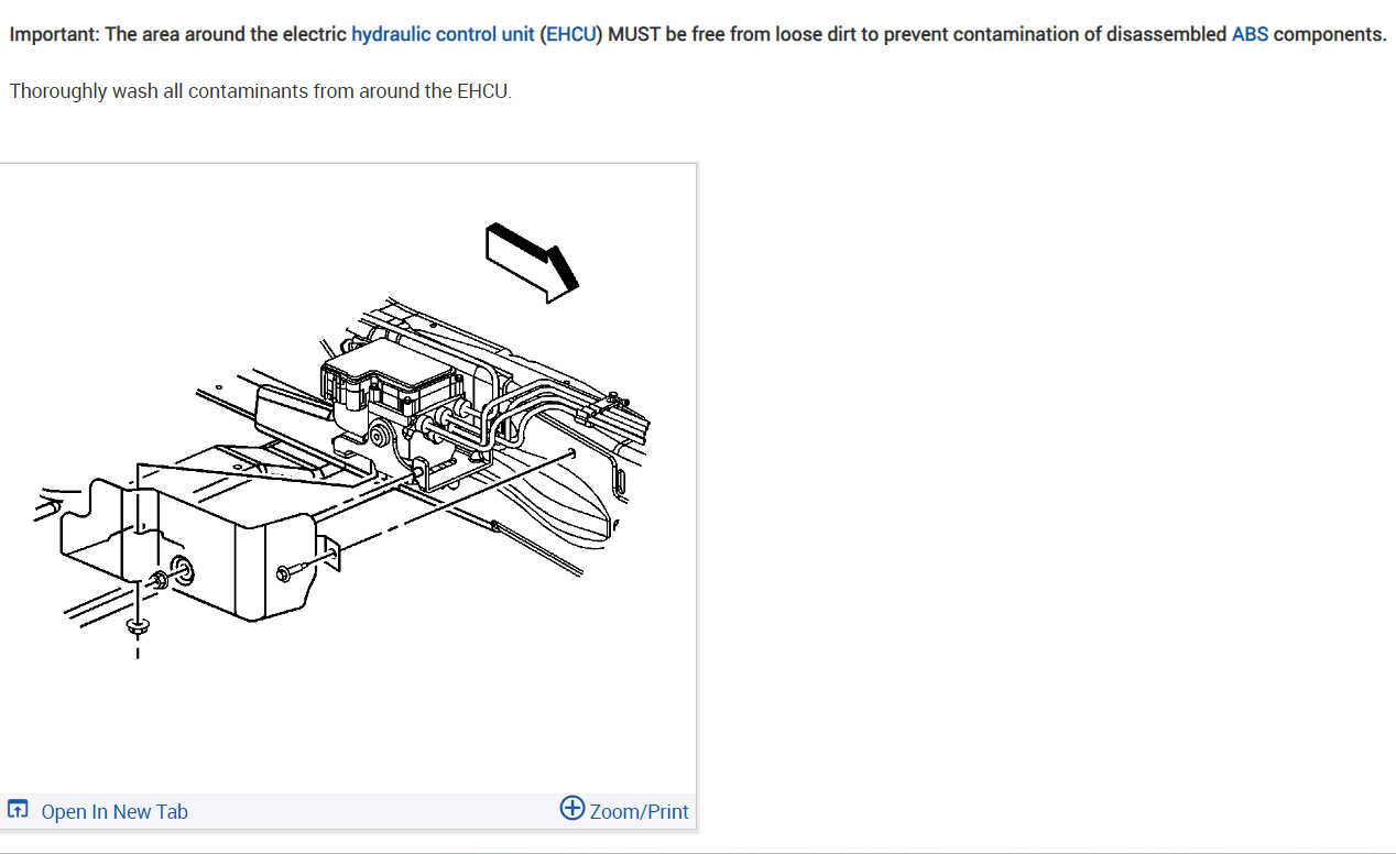

Yep, it looks like the processor inside the ABS control module has gone out. There is no way all three sensors when out at the same time unless someone cut all of the wires.
C0035: Left Front Wheel Speed Sensor Circuit
C0040: Right Front Wheel Speed Sensor Circuit
C0055: Rear Wheel Speed Sensor Circuit
Here is how to change the ABS module out in the images below and I have included a video to show you how the job is done.
https://youtu.be/lUotkKXG9dY?si=19HPm1332WDS3Aht
The codes will clear on their own once the repair is made. Check out the images (below). Let us know if you need anything else.
