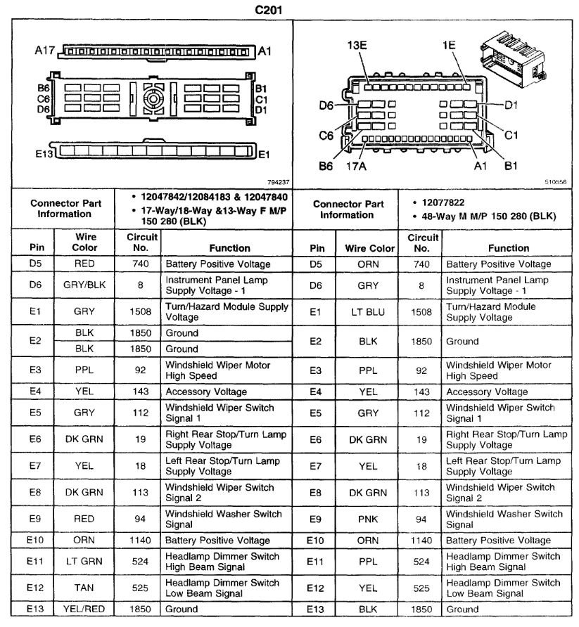

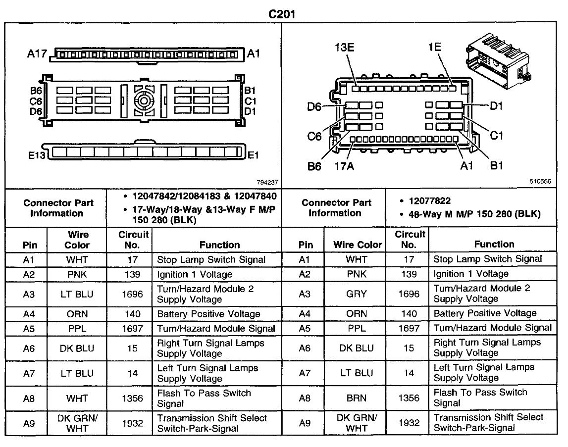

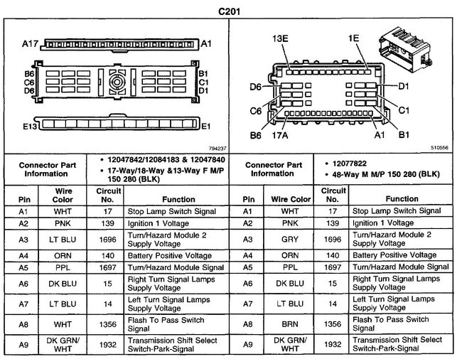

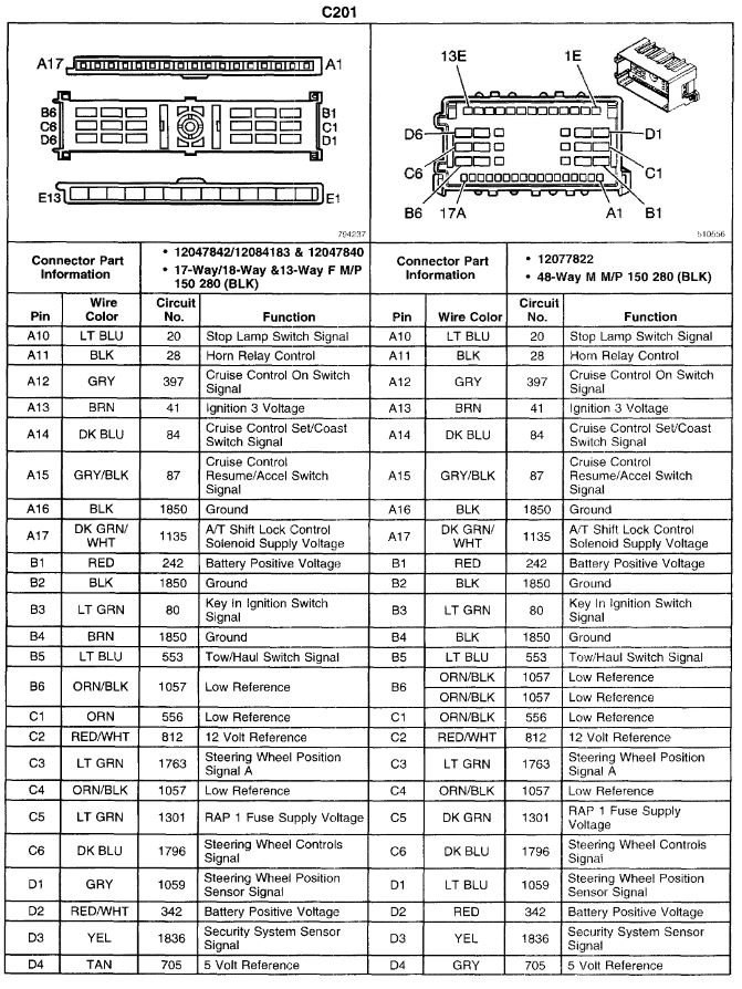

I recently changed my multi-function switch due to the cruise control going out. whenever I removed the old multiplexing switch the pins came out of the connector. I put all them back, in what I thought was the right position obviously I was wrong because now my brake lights stay on and whenever I press the brake pedal, even with the ignition off and key out, the radio comes on and the headlights come on. If you could please supply me with a pin out for the plugins on the multifunction switch itself I would greatly appreciate it..
