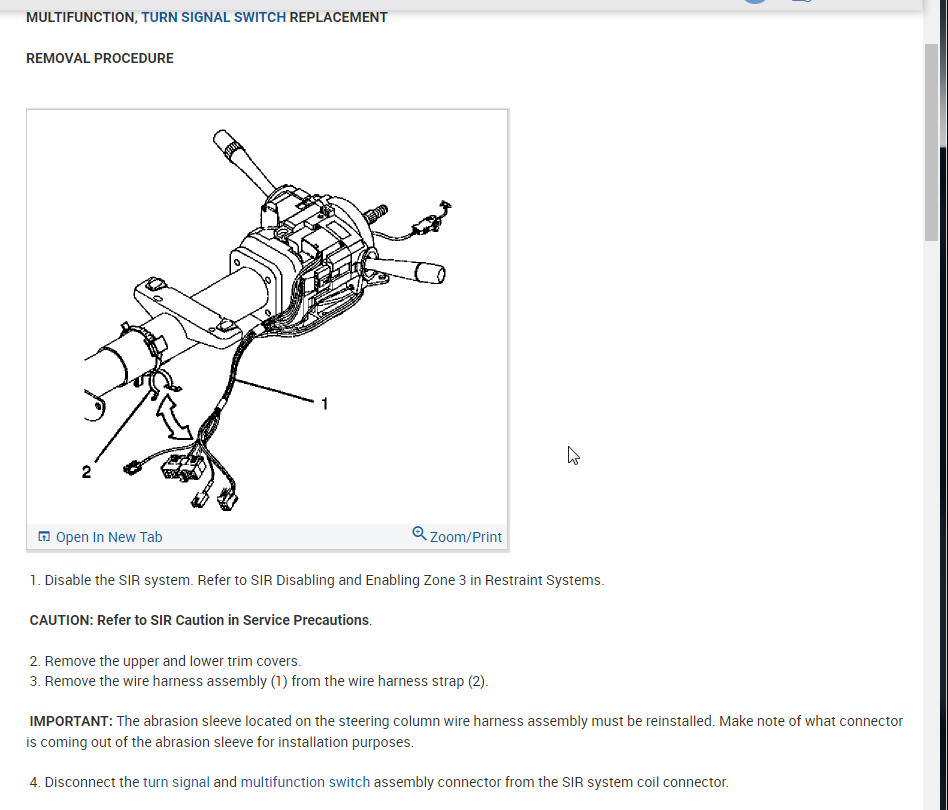

I believe the wires that go to the multi function switch (turn high beam etc) are bad so I need to replace the switch an you help me?

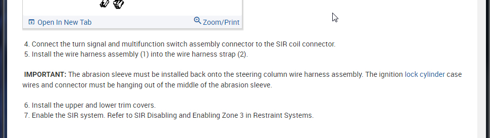

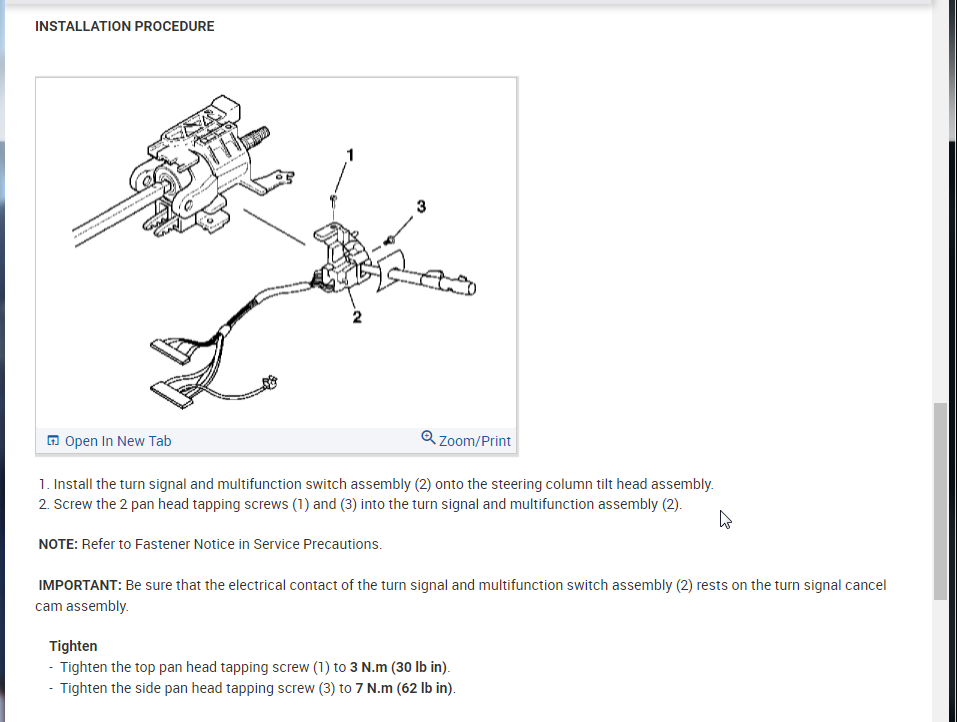

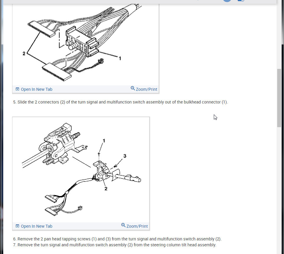

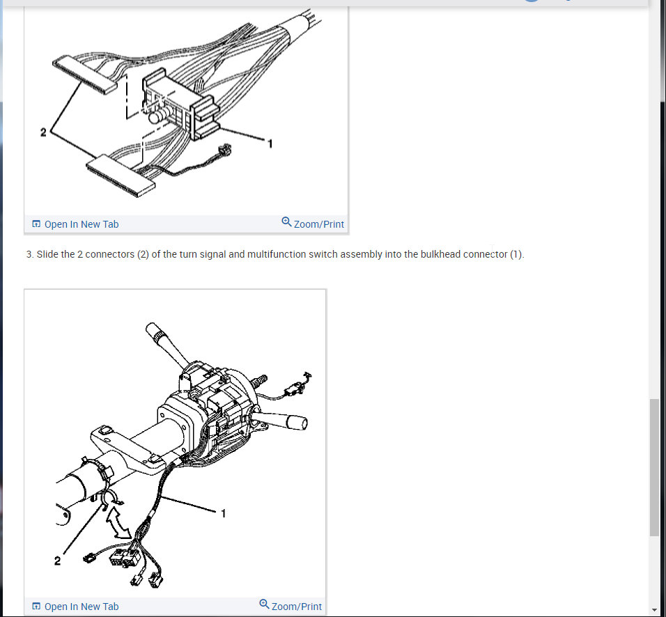

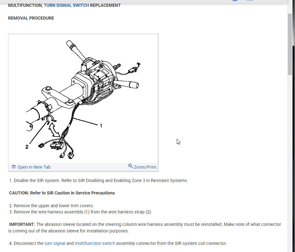

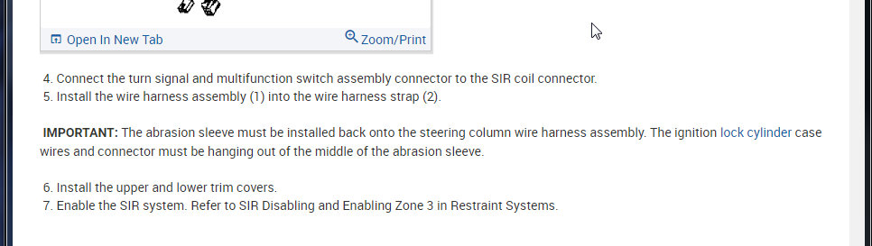

Please find the process below on how to replace the switch from the manual. Please run through this and let us know if you have other questions. Check out the diagrams (Below). Please let us know if you need anything else to get the problem fixed. Thanks
