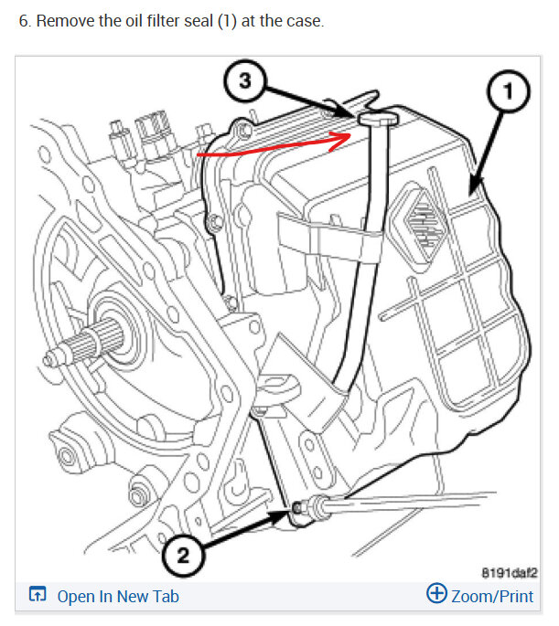

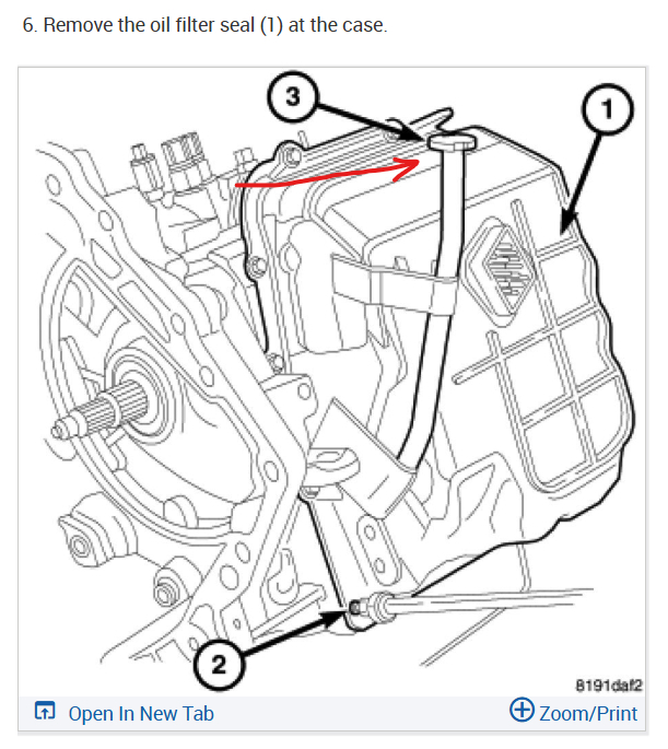

This can be the transmission fluid is low, also, do you have any warning lights on like the check engine light? If so, we should run the codes, this guide can help:
Here is a guide to help you check the transmission fluid and condition, you should smell the fluid to see if it is burnt.
https://www.2carpros.com/articles/how-to-check-and-add-transmission-fluid
MOPAR(R) ATF+4 (Automatic Transmission Fluid) when new is red in color. Check out the images (below). Please let us know what happens.
