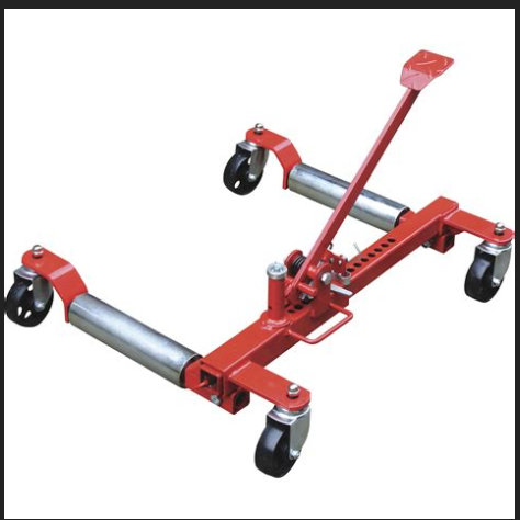

Unfortunately you cannot unlock the steering without disconnecting the steering shaft. So I would suggest using a floor jack or individual wheel dollies and lifting the front tires and you can move the vehicle around. Hopefully it is on pretty level ground and pavement. If not, you are going to have to get a key that can turn the ignition cylinder which will unlock the wheel.
