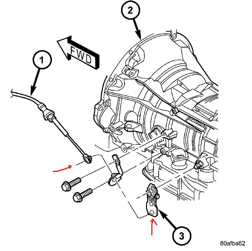

Lost key to my truck. Had only one. Had it towed to mt apt. Need to move it about 50 yes to be on apt property. I saw video on lifting the shift linkage arm off the gear selector, but he was showing this on a Dodge Caravan. Where is this located on my truck?

Here is the location for your truck, make sure the parking brake is set before moving the lever because it will roll as soon as the lever is moved. For your truck you will need to get under it to disconnect the shift cable. Check out the images (below). Please let us know what happens.
