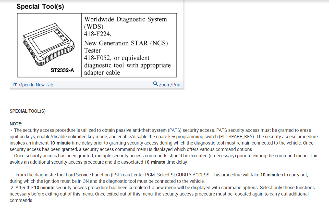

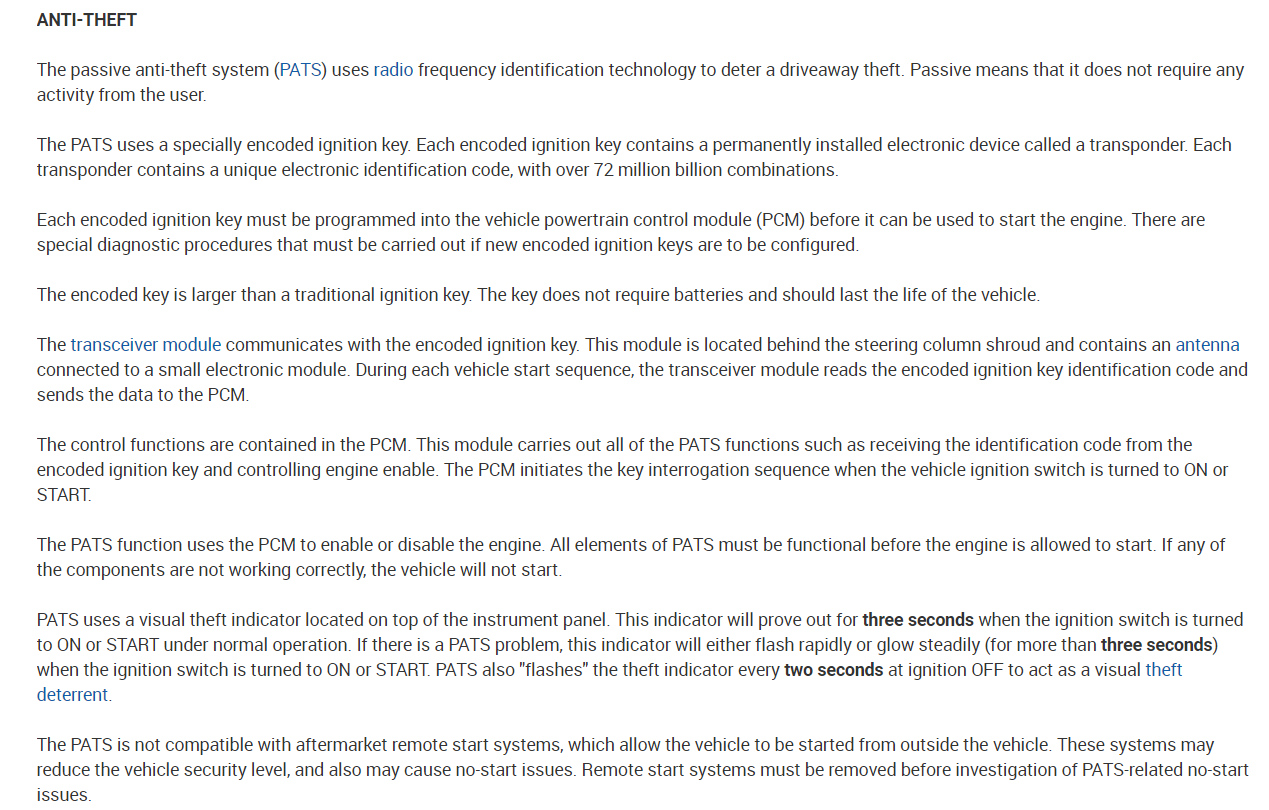

When you turn the key to the on position, does the anti-theft light come on and then go off? It must do that. If it does not then there is a security issue with the antitheft system.
I attached the description of the system as well as the procedure for setting it. Special tools are required for this procedure. It would be easier for you to call a locksmith and have him come to you and he can do that on-site for you.

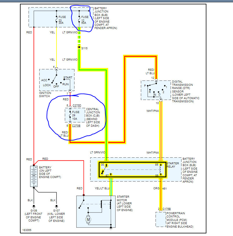

I also attached a wiring diagram of the starting system. Check the fuses I circled to be sure there is power on both sides of the fuses.
