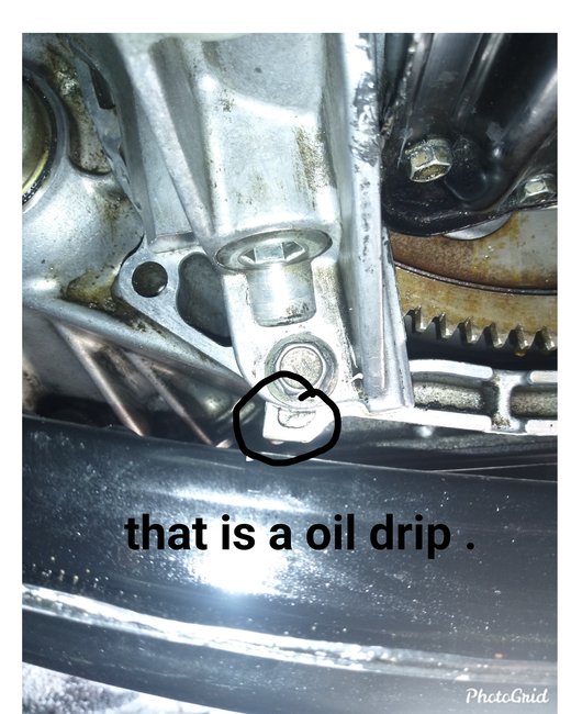

Hi, I recently did some engine work on my car listed above.I installed some bearings. When I put everything back on and added its oil, transmission fluid, and coolant, I go and started up and everything seemed fine until a friend of mine told me to stop the engine. so I did and he told me to look under the car and there it was a oil leak. now I am not talking just a few drops am talking more long almost like if I was draining the oil. It was coming down between the engine and transmission so I thought it was the rear main seal. so I took replaced it but it still leaking from the same place. what can it be?

Can you post a picture of the area of the leak for me to see?

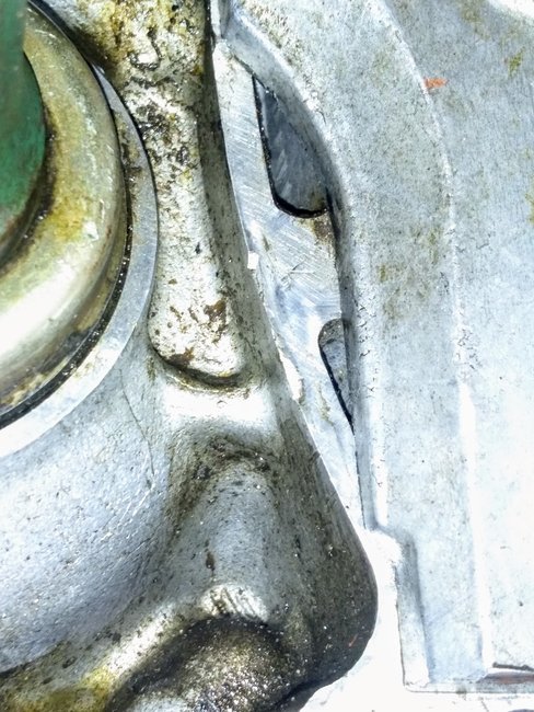

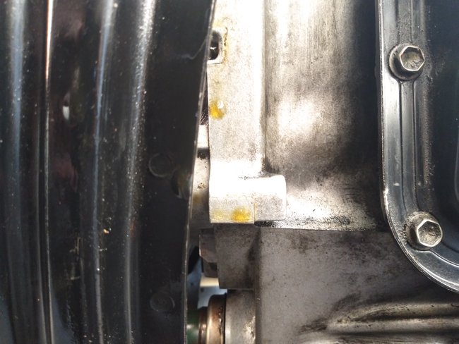

The last picture is where the transmission connects with the engine.
Oct 10, 2019 at 3:11 PM
Okay, make sure the valve cover gasket is not leaking down the back of the motor.
If that is good, then it looks like the rear main.
