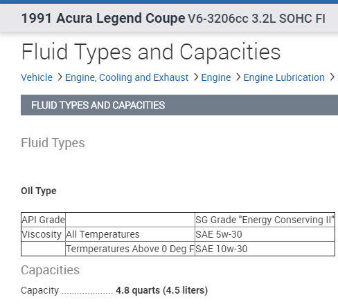

Just got this car second generation. I don't know what kind of oil to put in. please help.

I've attached a picture below. Check out the diagrams (Below). Please let us know if you need anything else to get the problem fixed. Hope this helps and thanks for using 2CarPros.
