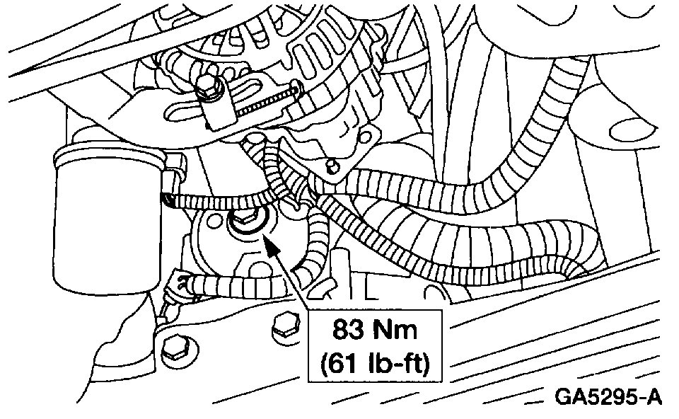

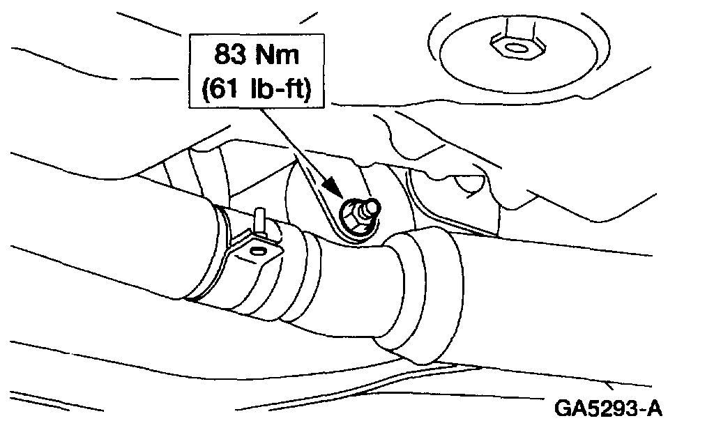

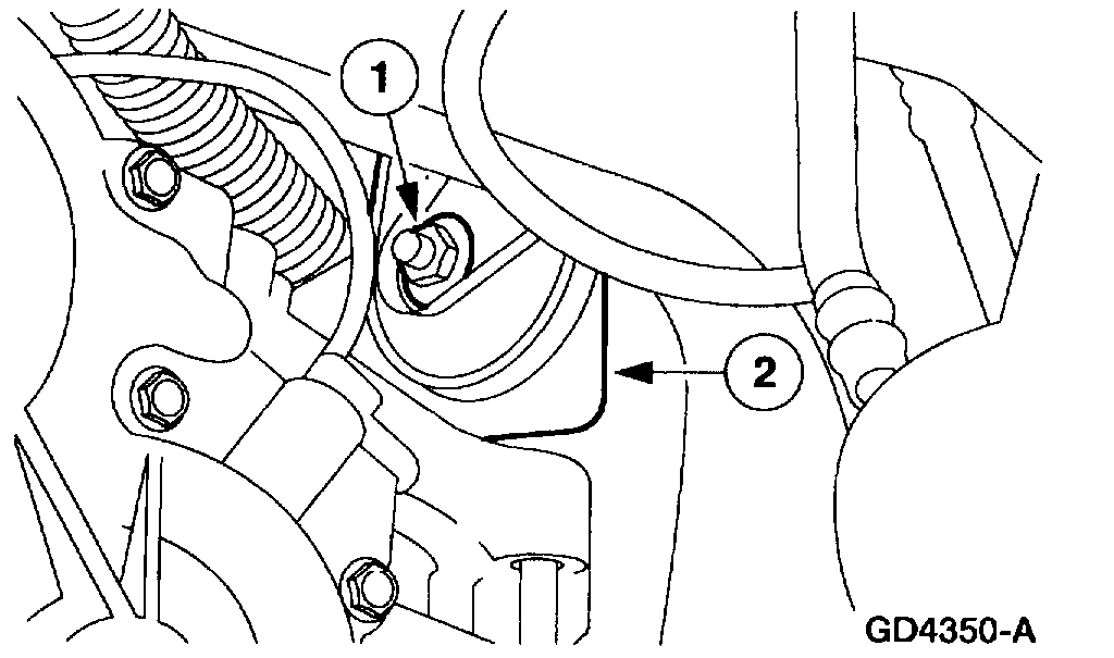

4. Unclip the Heated Oxygen Sensor (HO2S) wire harness.
pic 2

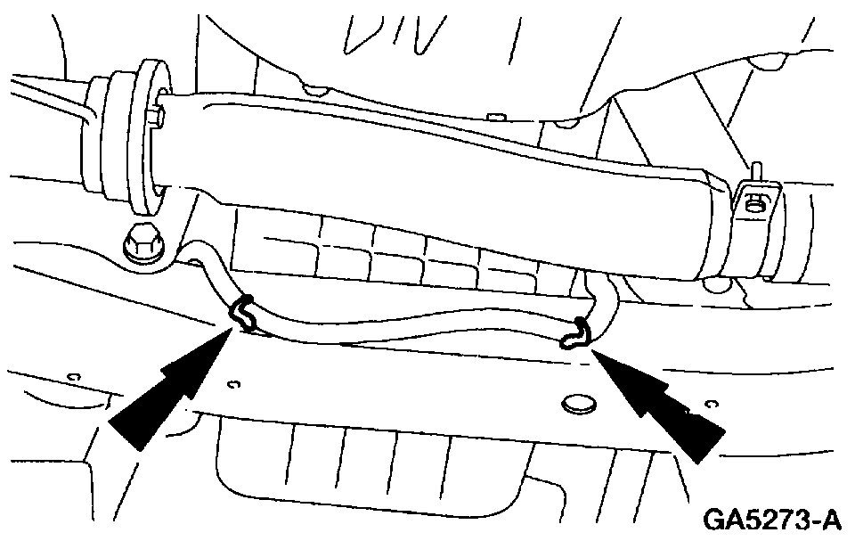

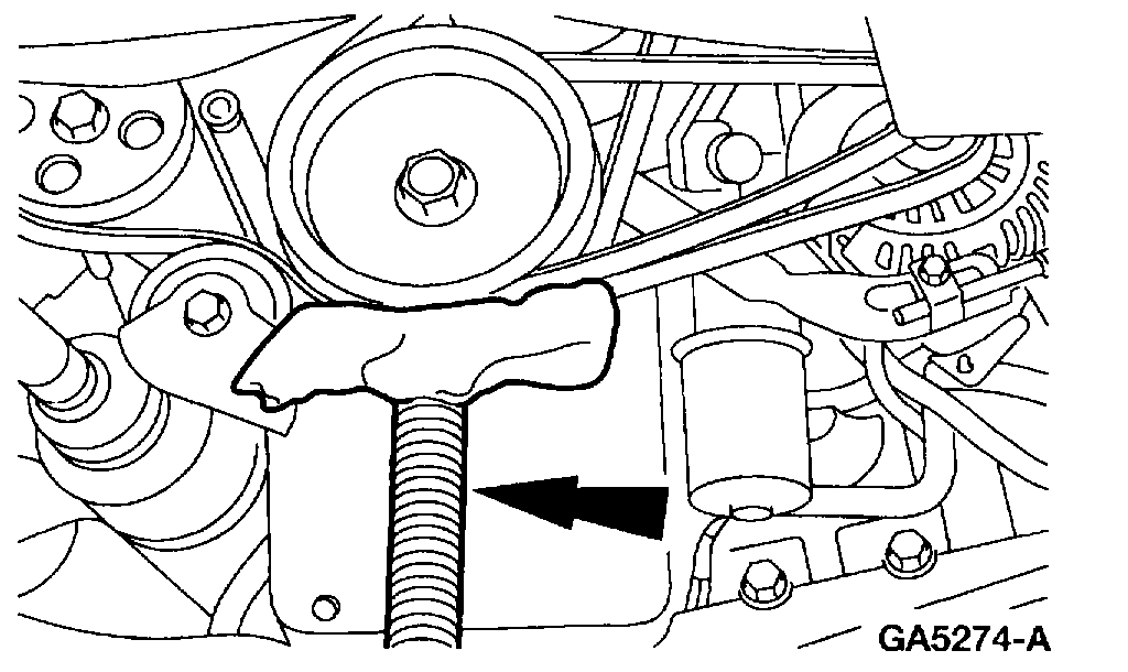

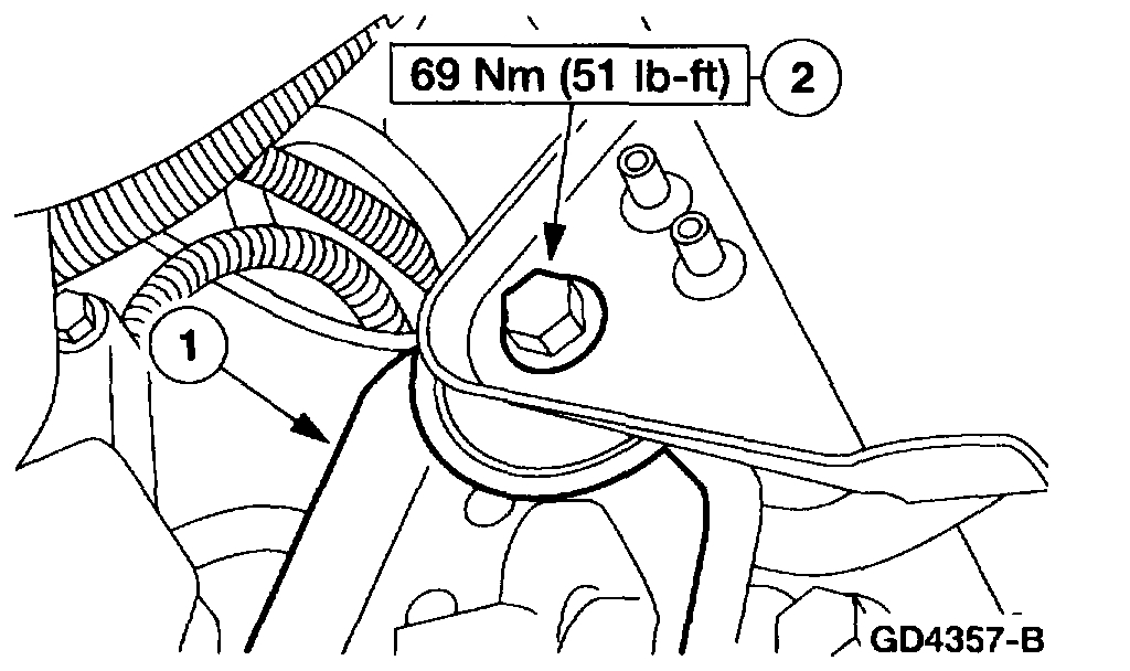

5. CAUTION: Cover the screw-type jack with a shop rag to prevent damage to the crankshaft pulley.
Position a screw-type jack under the crankshaft pulley.
pic 3

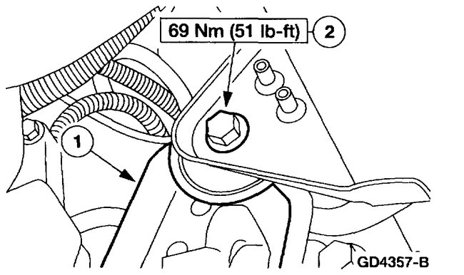

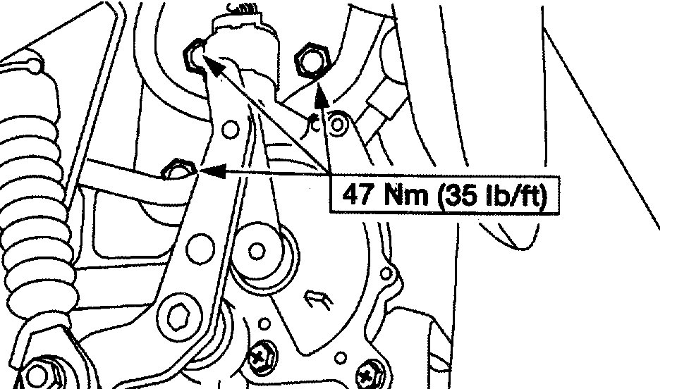

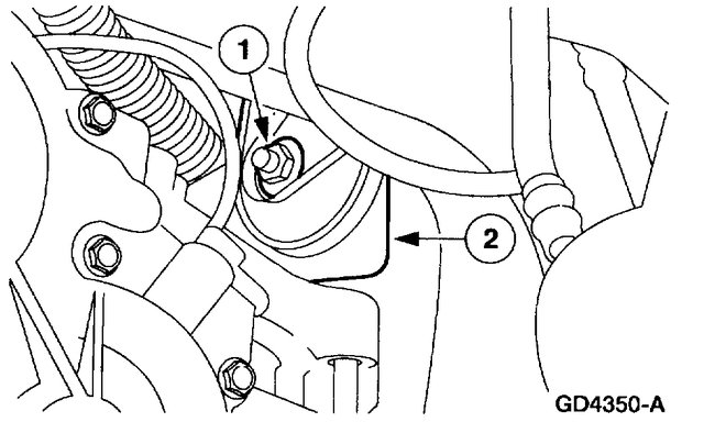

6. Remove the RH engine support insulator through bolt and nut.
pic 4

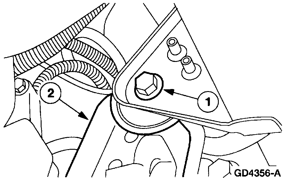

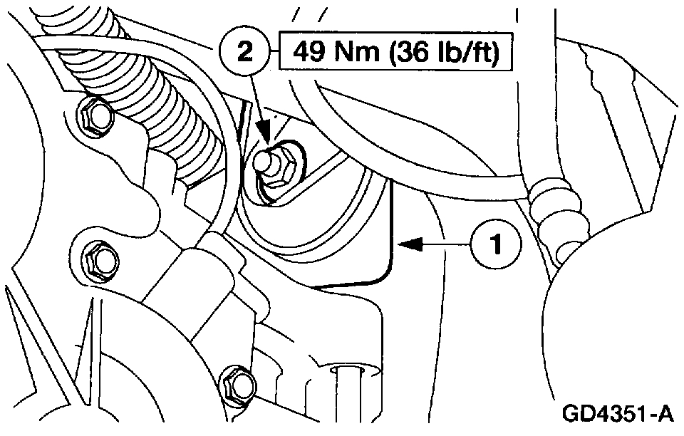

7. Remove the LH engine support insulator through bolt.
pic 5

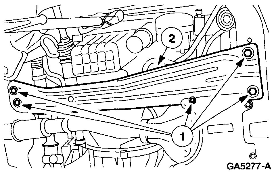

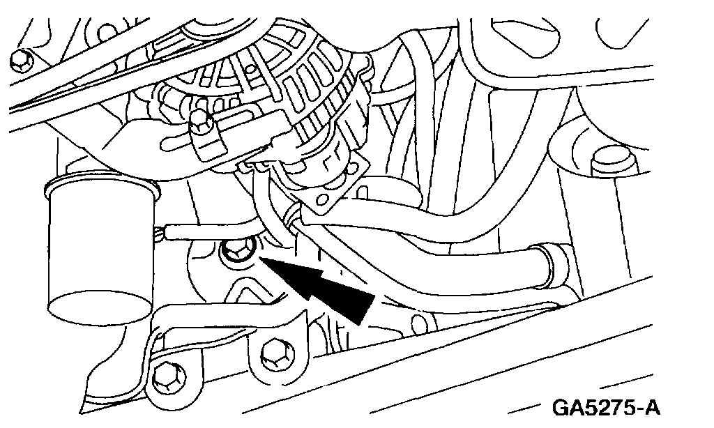

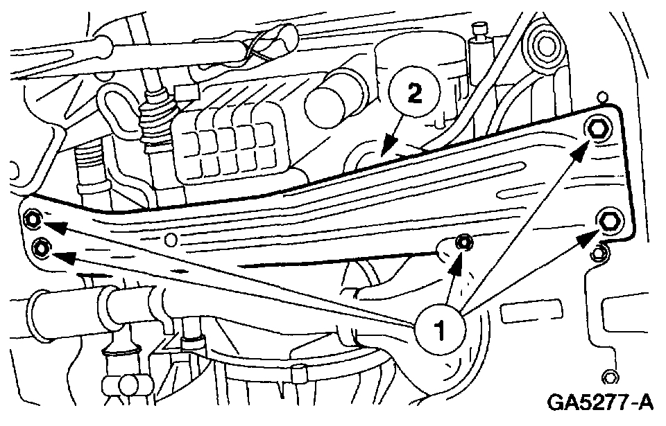

8. Remove the transverse member.
1 Remove the bolts.
2 Remove the transverse member.
pic 6

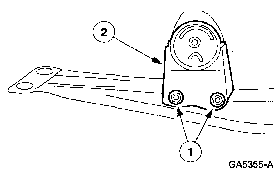

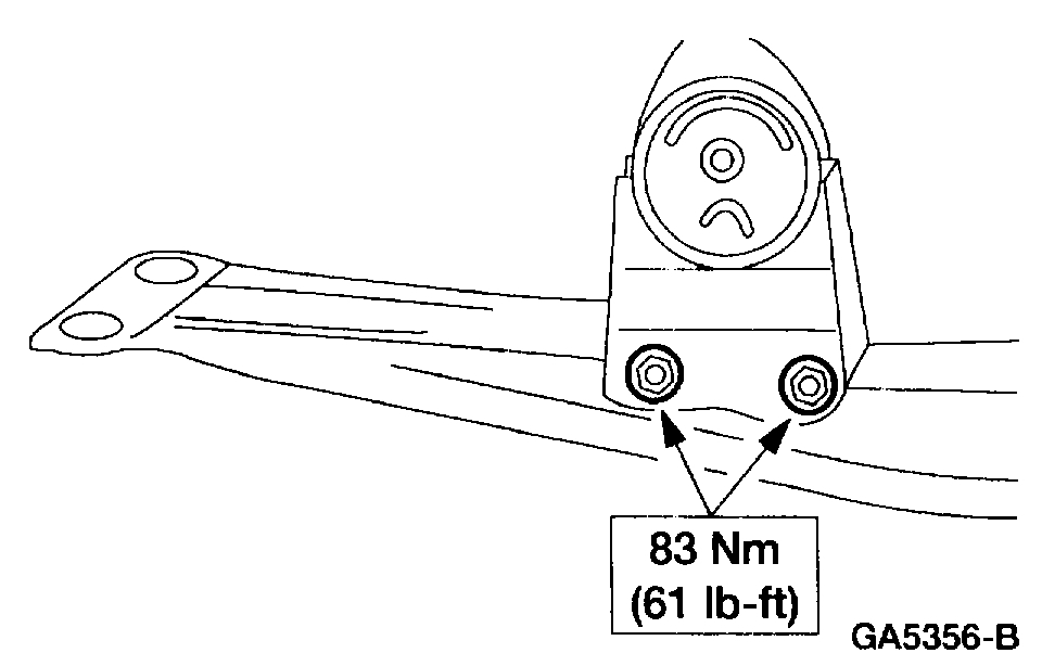

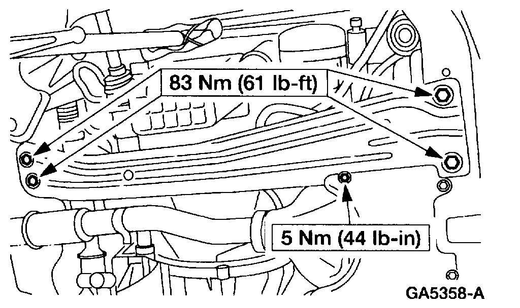

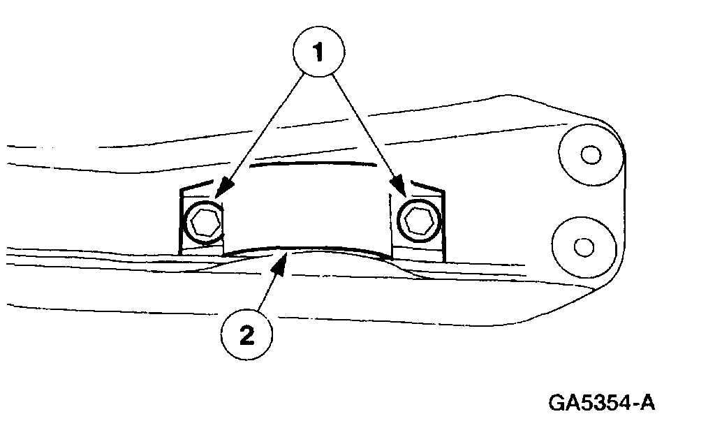

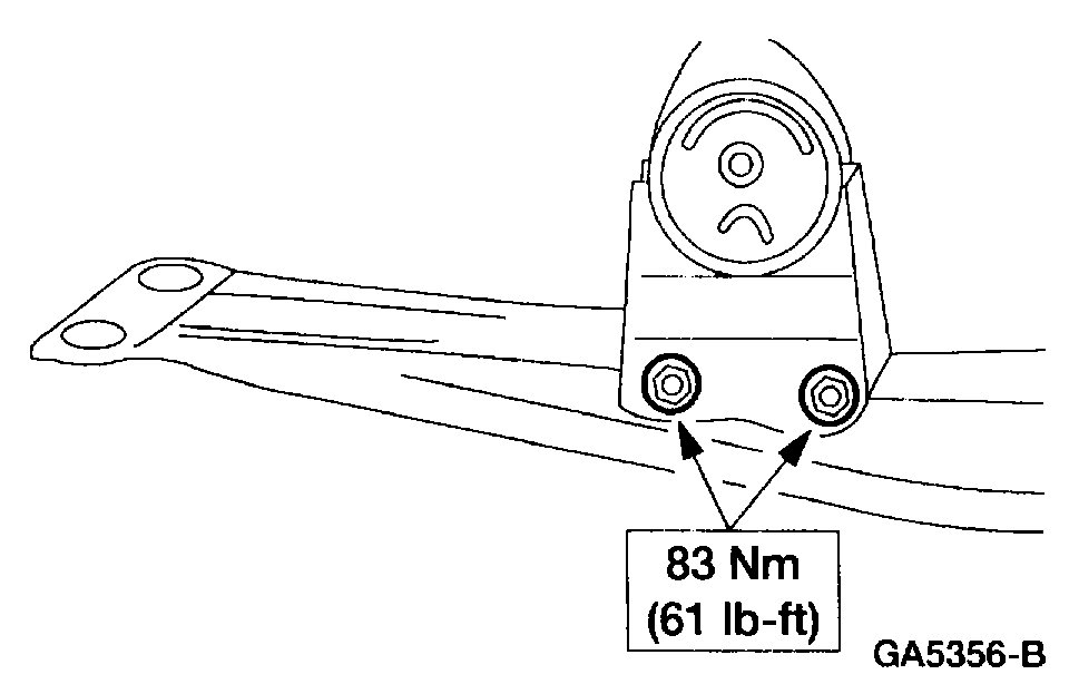

9. If removing the RH engine support insulator, remove the RH engine support insulator.
1 Remove the bolts.
2 Remove the RH engine support insulator.
pic7

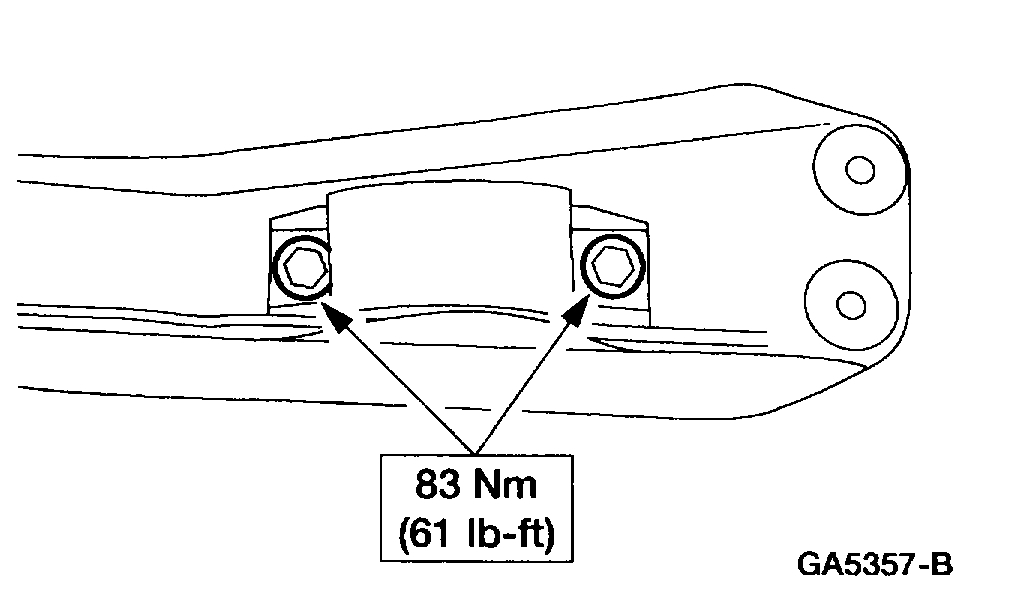

10. If removing the LH engine support insulator, remove the LH engine support insulator.
1 Remove the nuts and bolts.
2 Remove the LH engine support insulator.

1. To install, reverse the removal procedure.

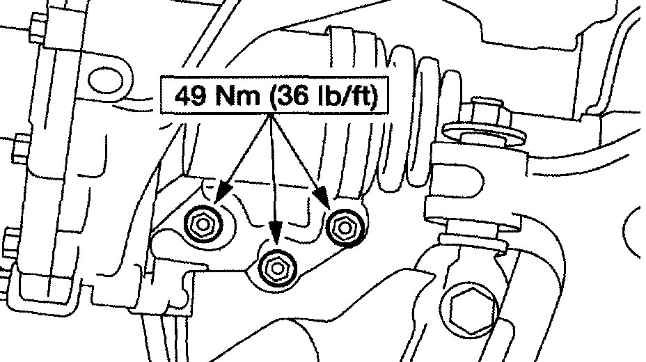

Removal
1. Raise and support the vehicle.
2. Support the transaxle using a suitable jack.
pic 13
3. Remove the lower rear transaxle support insulator nuts.
pic 14
