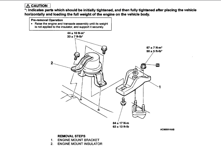

I am having trouble removing right front motor mount. Three bolts and three nuts from the front right motor mount, but it will not budge and come out. I have checked underneath the motor mount in the wheel well and have found no further bolts holding it down. what am I missing?
Sep 27, 2020 at 12:21 PM (Merged)
Good morning,
Can you post a picture of what you see? I want to see what you are doing. Check out the diagrams (Below). Please let us know if you need anything else to get the problem fixed.
