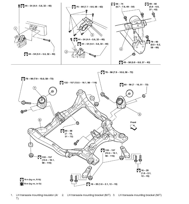

I bought a motor mount for my vehicle and bought one with no sensor, but little did I know that the one on my car has a sensor on the motor mount. My question is if I can reuse the sensor from the motor mount that I took off and install it on the new motor mount?

I don't see why not if it will reattach securely to where it came off of and is still serviceable. Please let us know if there is something else that we can help you with.

I found a diagrams that can help in the engine mount replacement. Check out the diagrams (below). Please let us know if you need anything else to get the problem fixed. Can upload a picture of what you are talking about?
