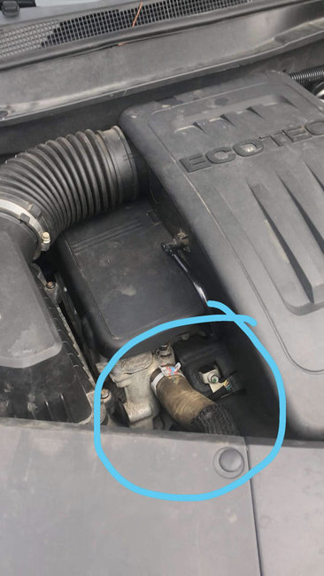

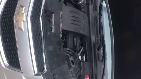

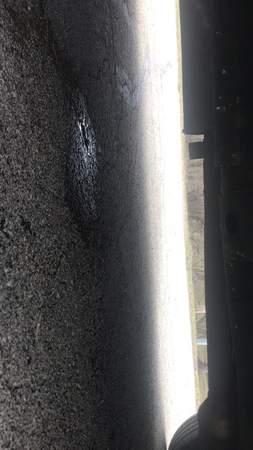

I have no idea what it’s leaking I haven’t figured that out yet. and I thought I uploaded a video and picture of the puddle under the car. Anyways, the color of the oil indeed is a tan/light orange milky color. I also uploaded a picture of what the radiator hose looks after it was returned and I just replaced that also.

You are welcome. I wish I could do more for you. If you have a chance, let me know how things work out for you. I'm interested in knowing. Also, if you confirm the leak is actually motor oil, let me know. Keep an eye on all the fluid levels to see which one is dropping.
