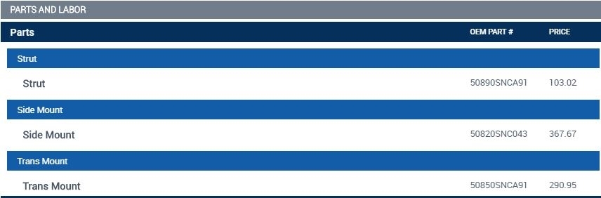

So I'm looking in to replacing my motor mounts because they are toast and along with my transmission mount because it is broke as well as my torque struts. but I'm curious on I found the parts in a kit for way cheaper then what the shop had told me. but my problem is will 1.8l mounts and torque struts work on a 1.3l or will i need to actually find the 1.3l ones for this project?

I looked up part numbers for both engines and they are totally different. Based on that, I would say you can't cross them.
I attached a picture. It shows the manufacturer's part numbers for your vehicle 1.3L. Use the part numbers to see if you can find them for less money.
