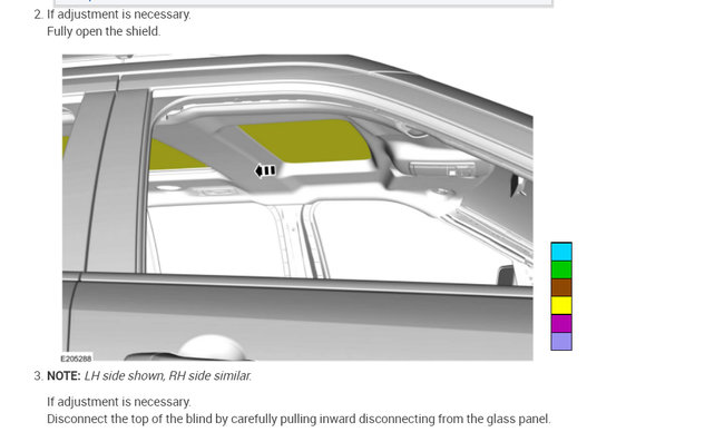

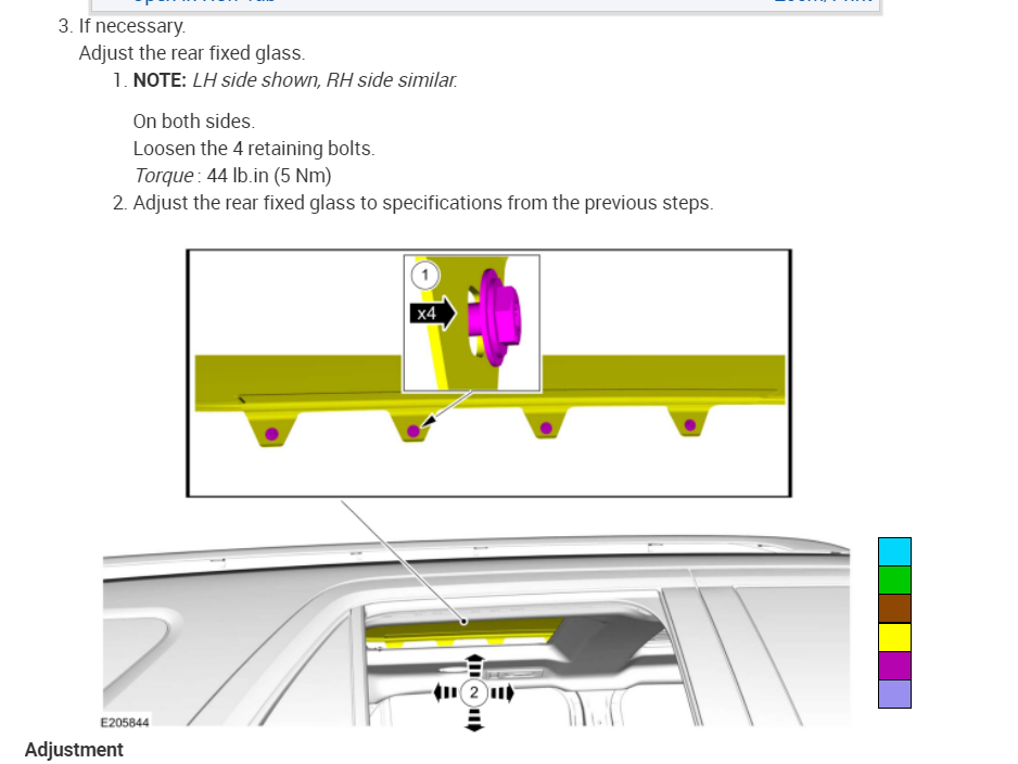

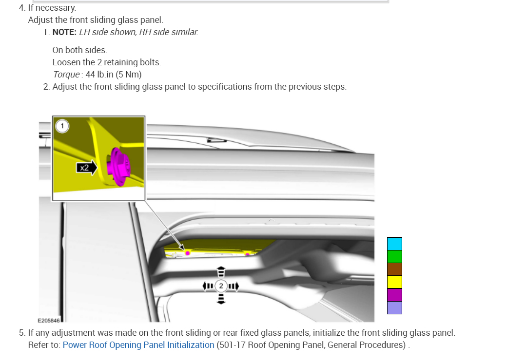

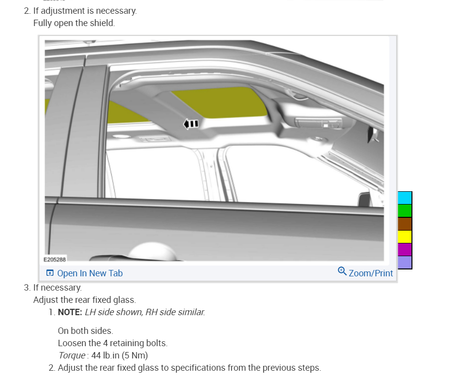

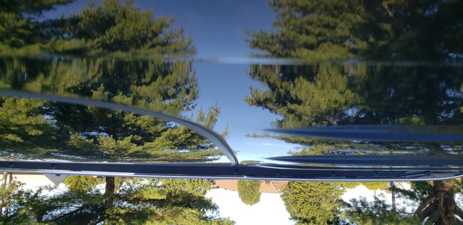

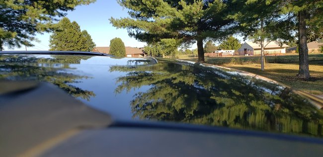

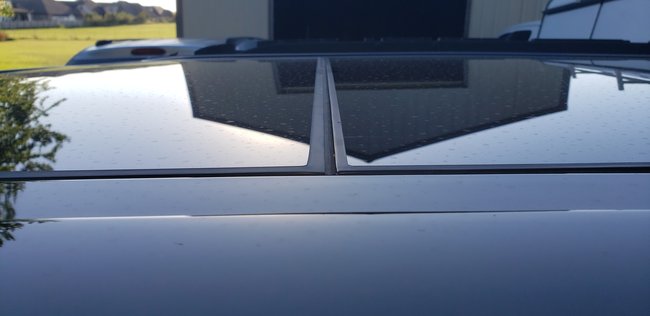

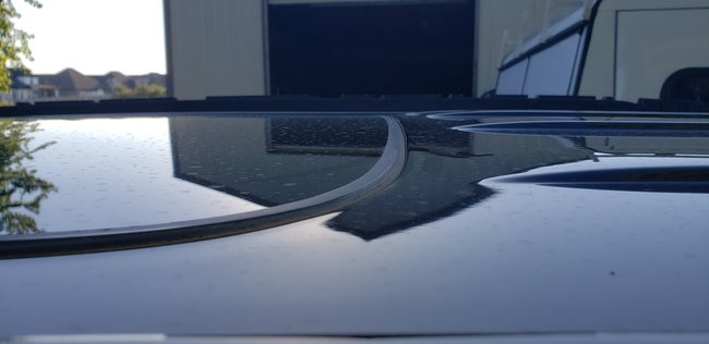

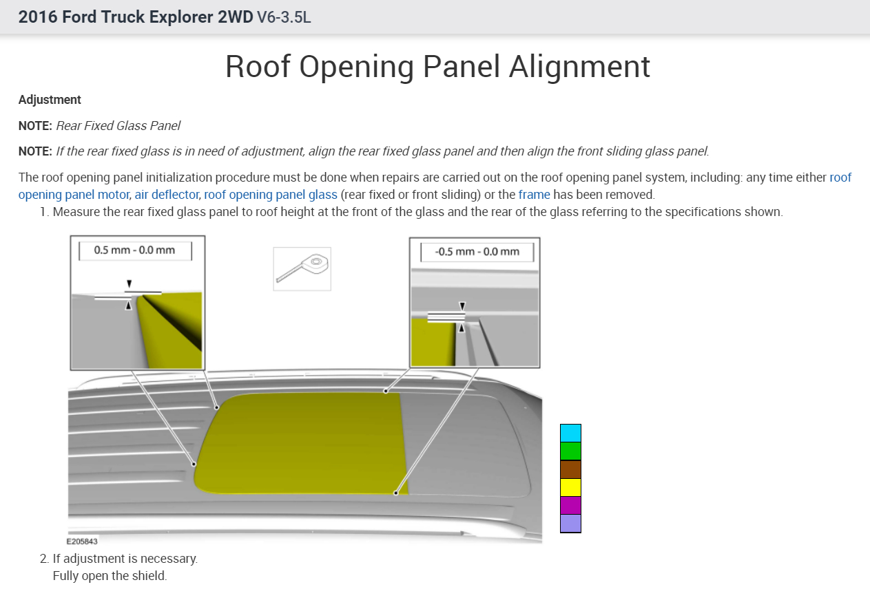

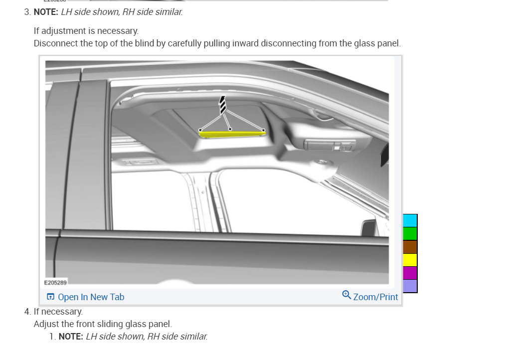

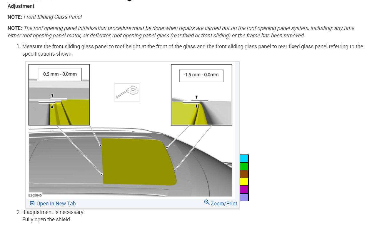

The tilt function will only operate if the sunroof is in the fully closed position. So, if the alignment is off the tilt function will not work, here is how to align the sunroof to help return the tilt function. Once complete open the close the sunroof fully to reset the system. Check out the images (below). Let us know what happens and please upload pictures or videos of the problem.
Sep 23, 2022 at 10:56 AM

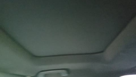

PHNELS68

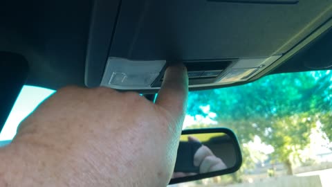

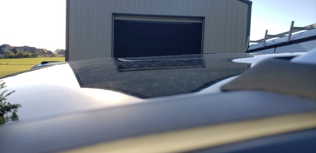

The alignment looks good. I'm not sure why pushing tilt makes the front shade and window open. It doesn’t give me a chance to push and release before holding it to reset.
Sep 26, 2022 at 4:30 PM
Thanks for the videos, the alignment looks good. Let's try to relearn the sunroof operation:

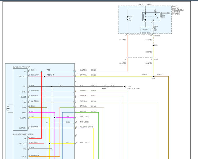

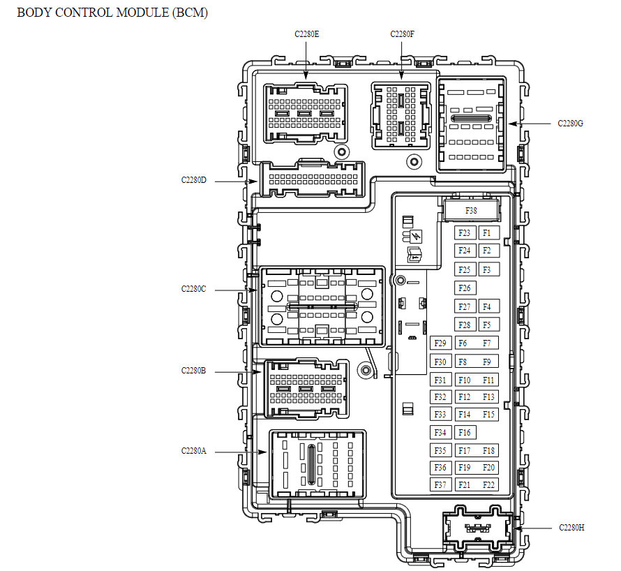

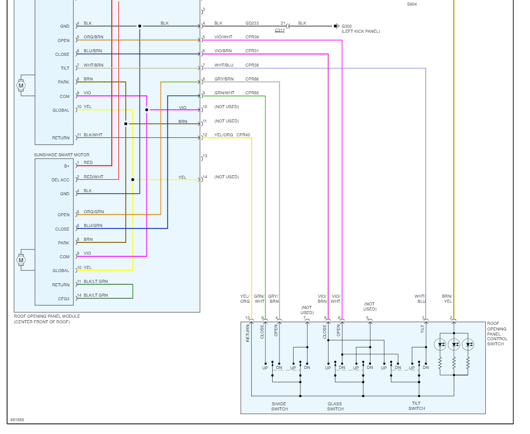

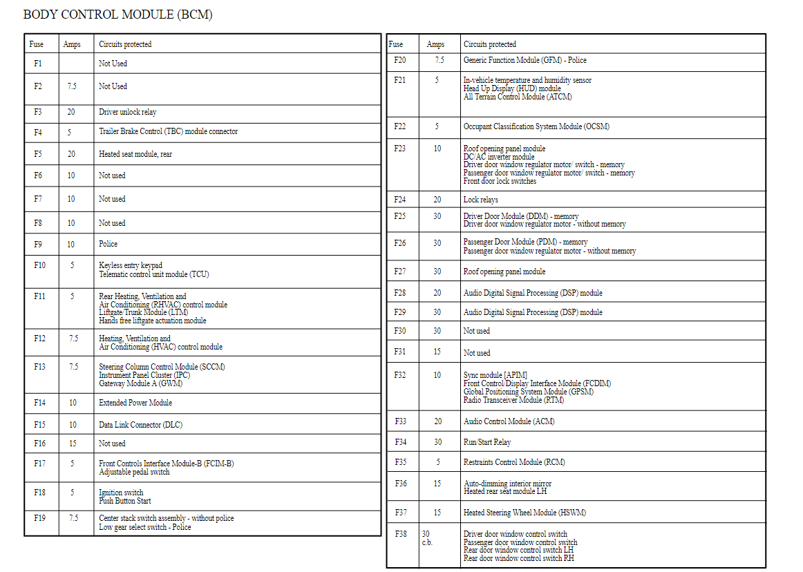

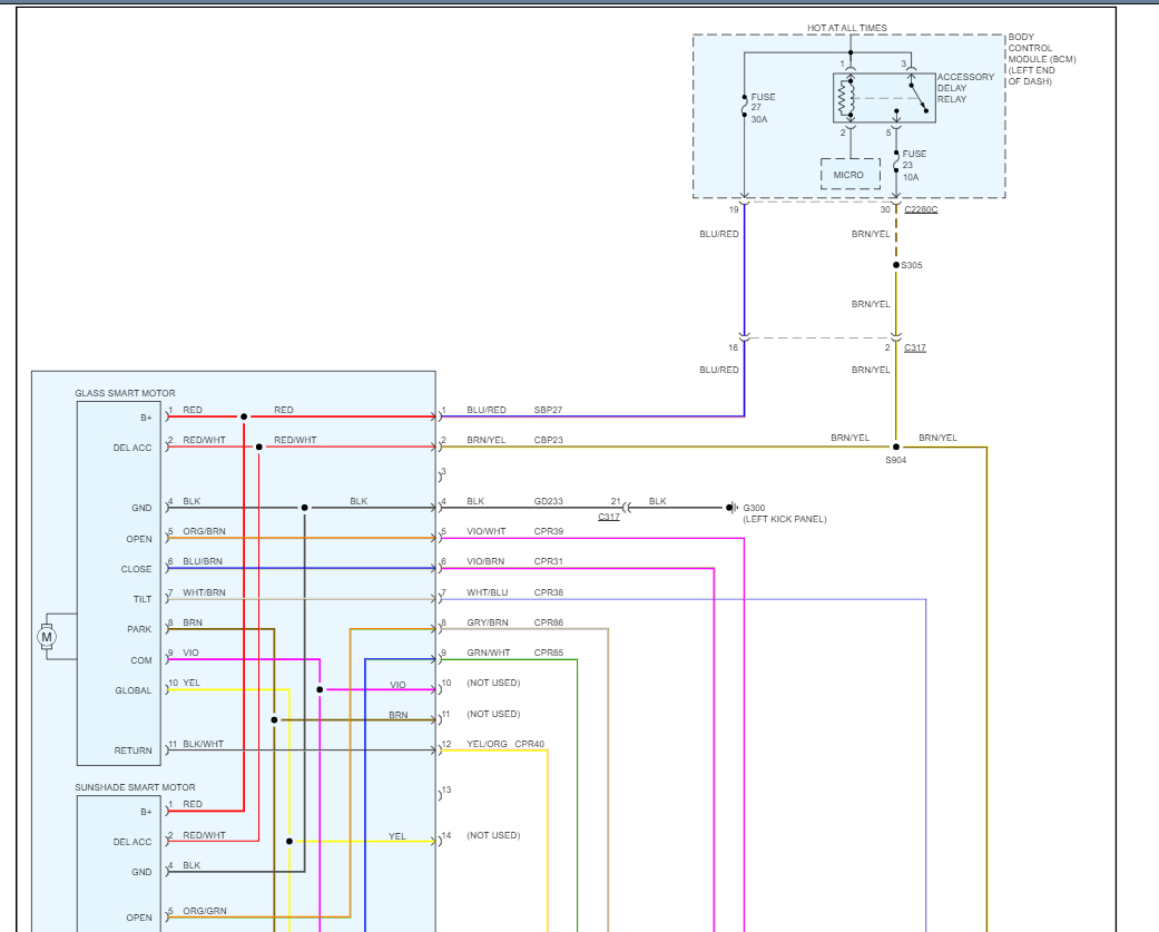

If this doesn't work you have a bad roof opening control module, here are the wiring diagrams so you can see how the system works. BTW did you check the #27 and Fuse #23 in the left side of dash fuse panel? There is an accessory delay relay which is interrogated into the BCM if you don't have power at fuse #23 with the key on. Check out the images (below). Please let us know what happens.
Sep 27, 2022 at 12:22 PM
