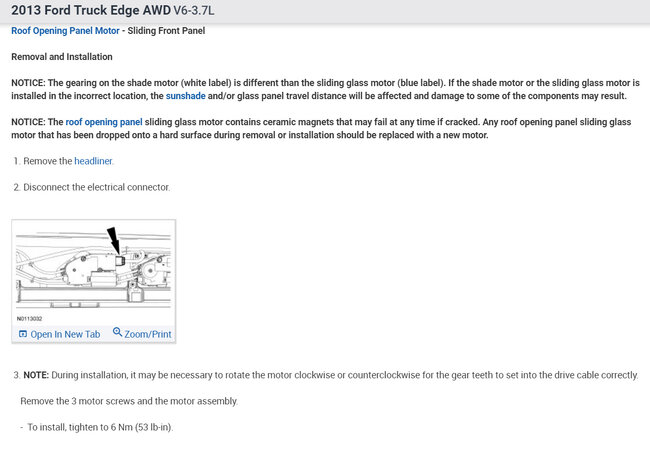

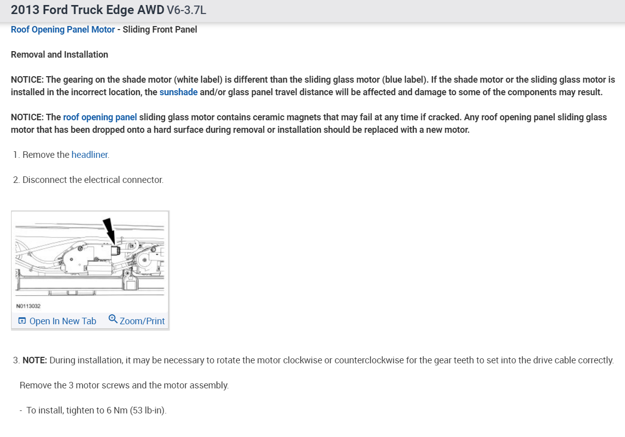

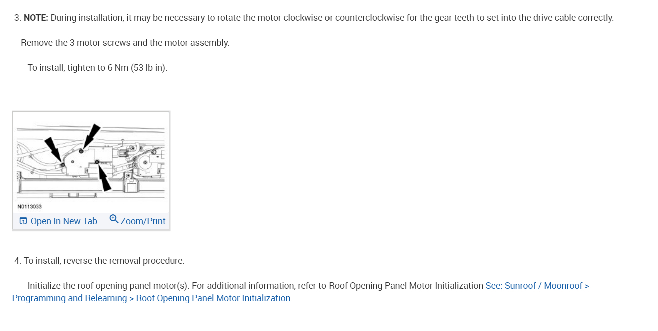

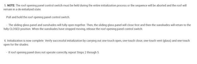

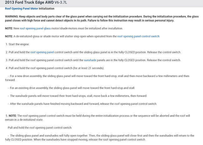

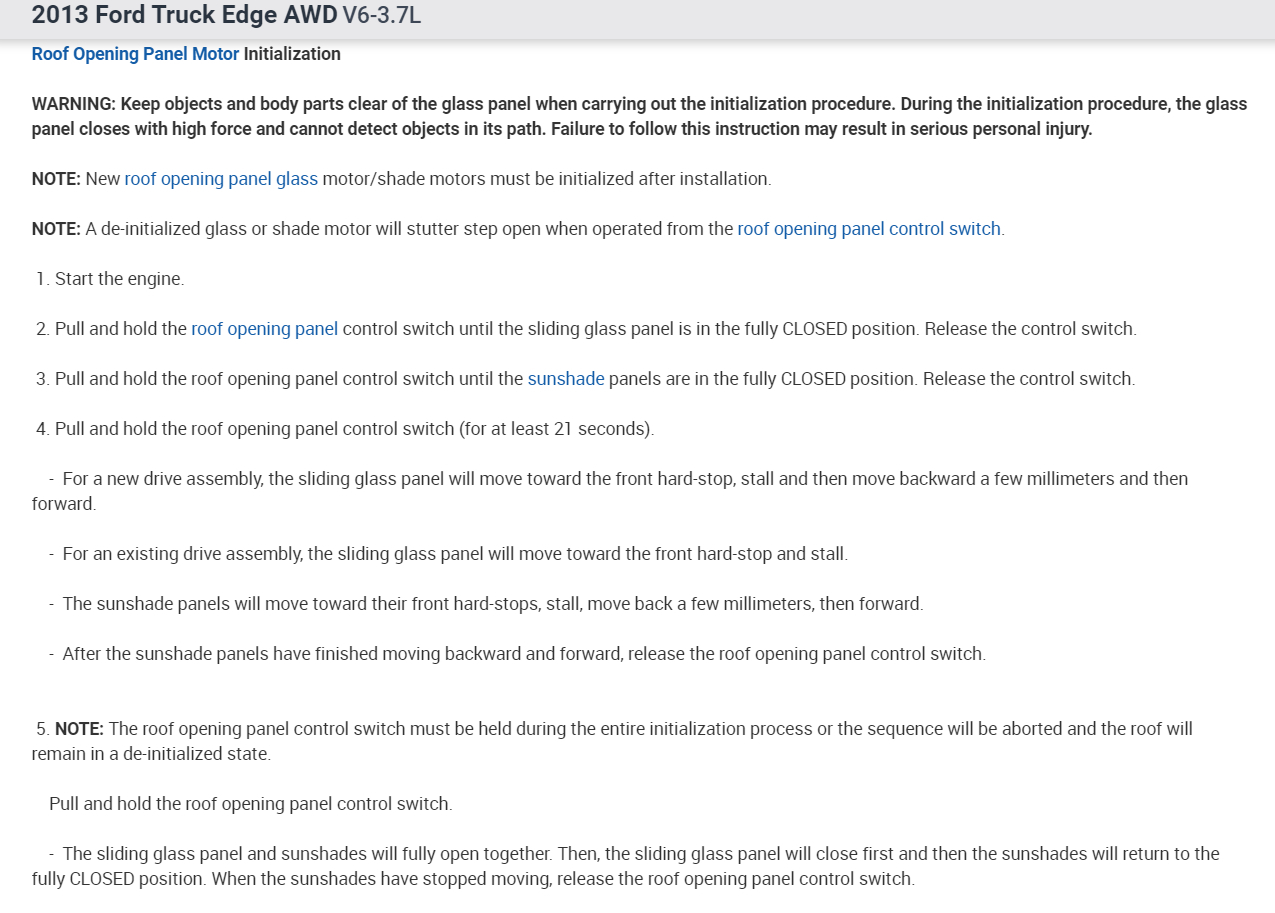

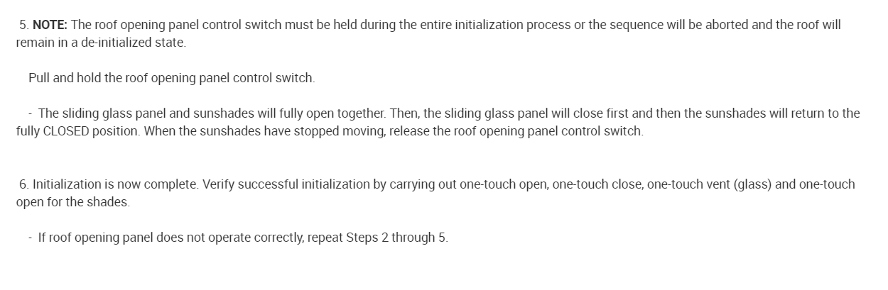

So, what happens on these is the motor has a resistance maximum level and when it reaches it the sunroof will stop closing. I would use wd40 and spray the tracks down on each slide. If this doesn't work, then the sunroof motor will need to be replaced. here are the instructions to do so in the images below. Make sure you do the initialization procedure that I have included as well. Check out the images (below). Please let us know what you find.

Sounds good, please let us know if lubricating the rails works.
