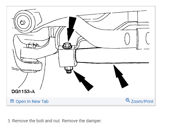

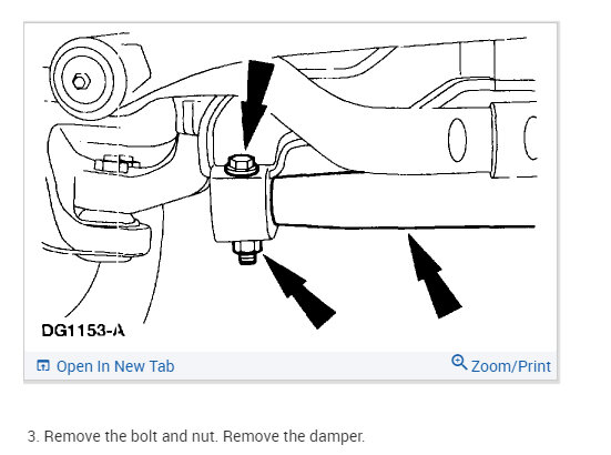

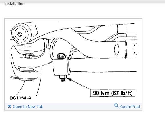

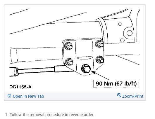

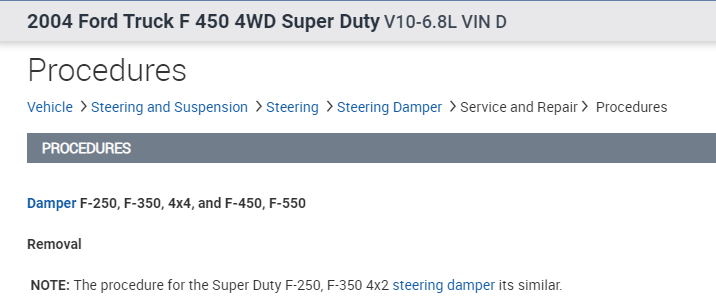

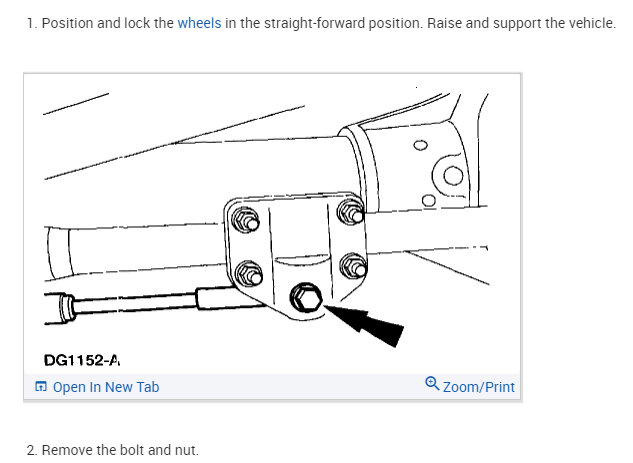

I'm not sure what you are asking. If you are referring to a Twin I Beam suspension, I believe they used that on the 2wd vehicles.
As far as the damper is concerned, I attached directions for replacing it.
Let me know if this helps.
See pics below.
