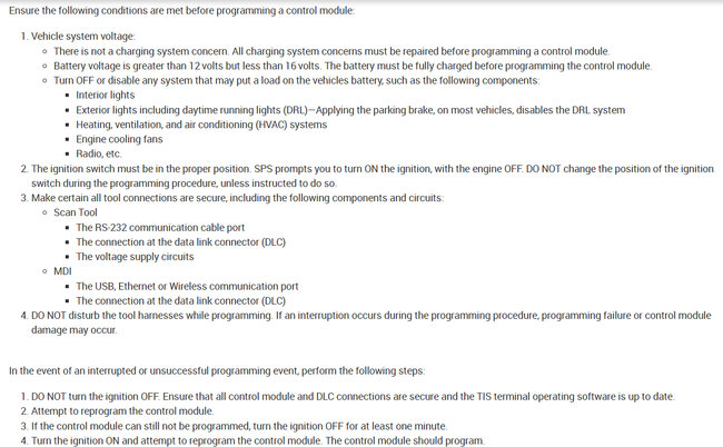

I replaced the fuel pump control module and auto zone said it was programmed. Well it wasn’t. What is the specific type of scanner I need to reprogram the module. So many and all do something different.
Mar 1, 2026 at 5:57 PM

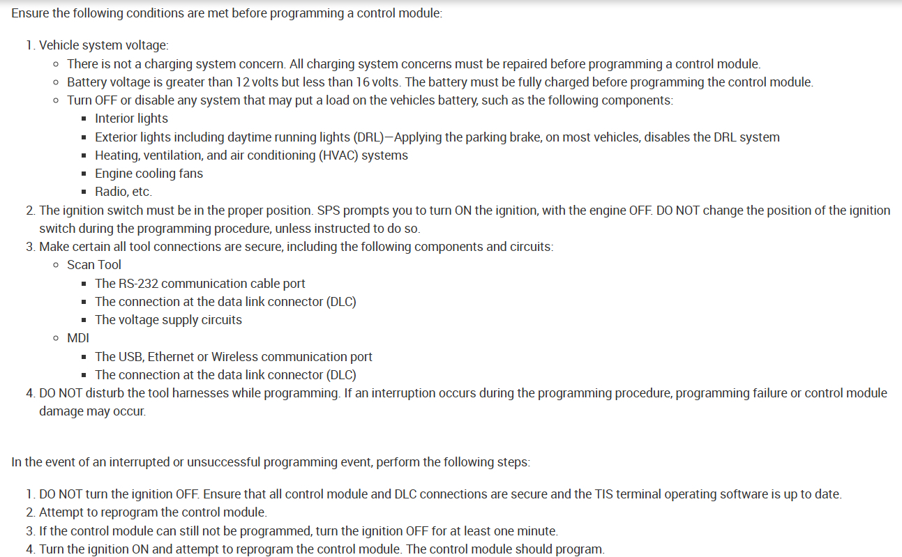

The fuel pump control modules (FPCM) do actually need to be programmed to the vehicle VIN. They are NOT plug and play. Here are the instructions: Check out the image (below)
Let us know if you need anything else. . Please use 2CarPros anytime we are here to help. Ken
