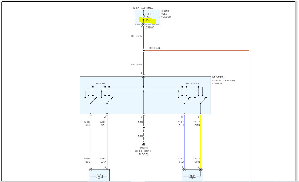

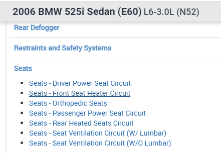

No problem. I went with the 525 model. If you look below, I attached the wiring schematic for the driver's seat. It shows the fuse to be a 30amp fuse.
Please keep in mind, without knowing for sure the model it came from, I can't be 100% sure, but I did check a couple 5 series vehicles and they had the same thing.
Let me know if this helps.
See pics below. Note: I had to cut the pic in half to make it readable. I did overlap the two.

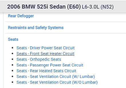

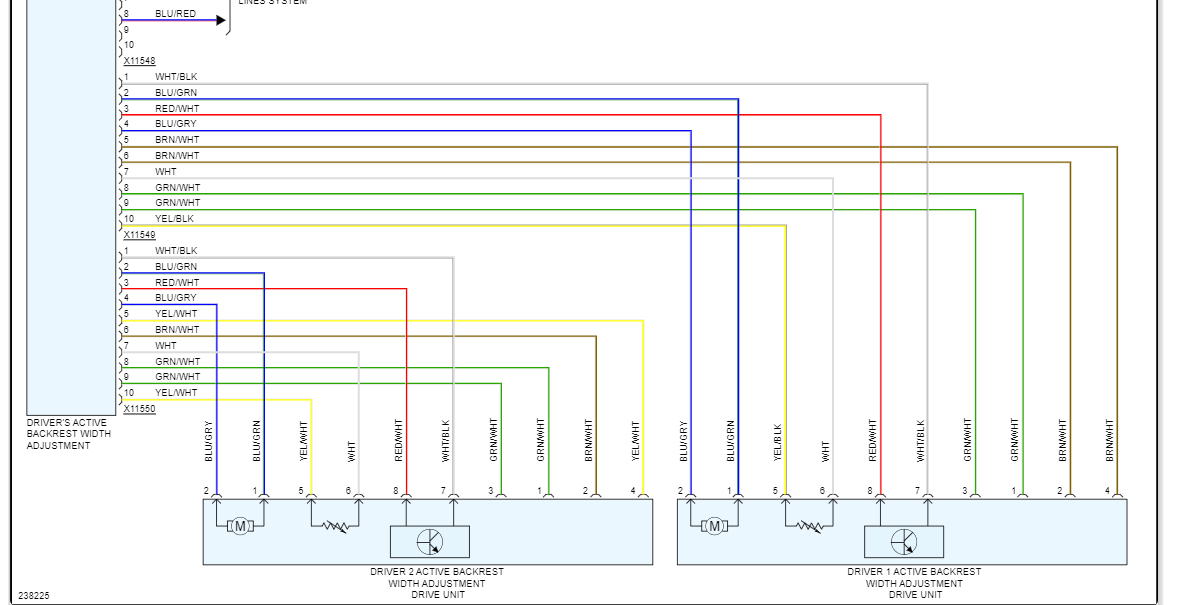

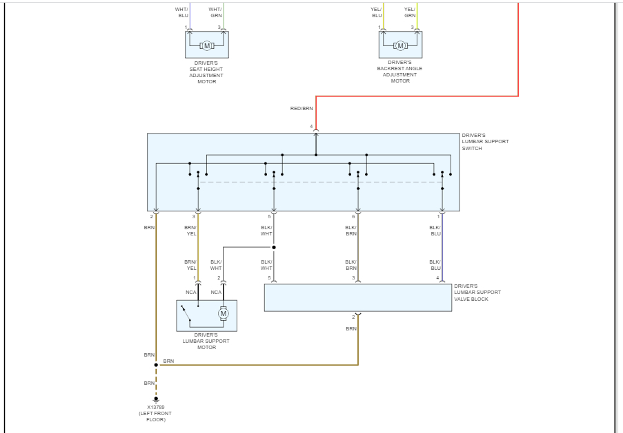

There are several variations of options, but the closest I can get to 12 appears to be a 10-pin connector. That is for an orthopedic seat. See pic below. Do the wire colors appear to be correct?
Also, pic 2 shows the optional functions.
See pics below.

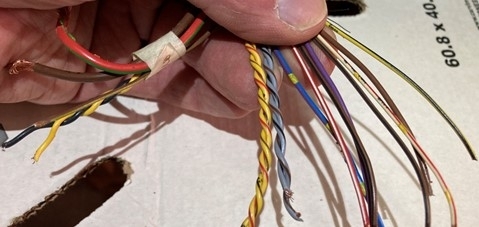

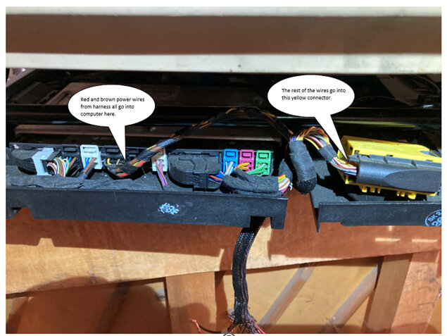

I took some pics to show what I have. The harness pic I fanned the wires out to show them. There are 5 wires that I grouped that seemed to be the power group. There's a brown and a red/green with some smaller wires. They stay together and get plugged into the computer under the seat.
Then there are 12 more wires that leave the harness and go into the yellow connector. Now the yellow/red and yellow/black I followed and they go to the seatbelt. But along with those 2 a red and black also goes to that same seat belt component. They seem to come from the back of the yellow connector, but they don't match any of the wires going into the connector.
Looking at your diagram I have a few colors that aren't listed like a purple wire going into the yellow connector.
From what I see each component has 4 wires going to it. I'm guessing a power set and a communication set. I'm worried there's a communication with the seat computer or maybe even the car computer that I have to do something about for the seat switches to work.

The ones that are twisted together are part of the controller area network. I don't think you need to worry about them.
What you need is power to the power supply wire, red/brown. That is power to the switch. The solid brown wire is a ground. You will need to use that to complete the circuit.
Once you have those two things, there are 4 wires that should go to the motors (white/blue, white/green, yellow/blue, and yellow/green).
That (in theory) should make the motors responsive. I do see the wire colors I mentioned in your pic. The modules shouldn't even be needed.
