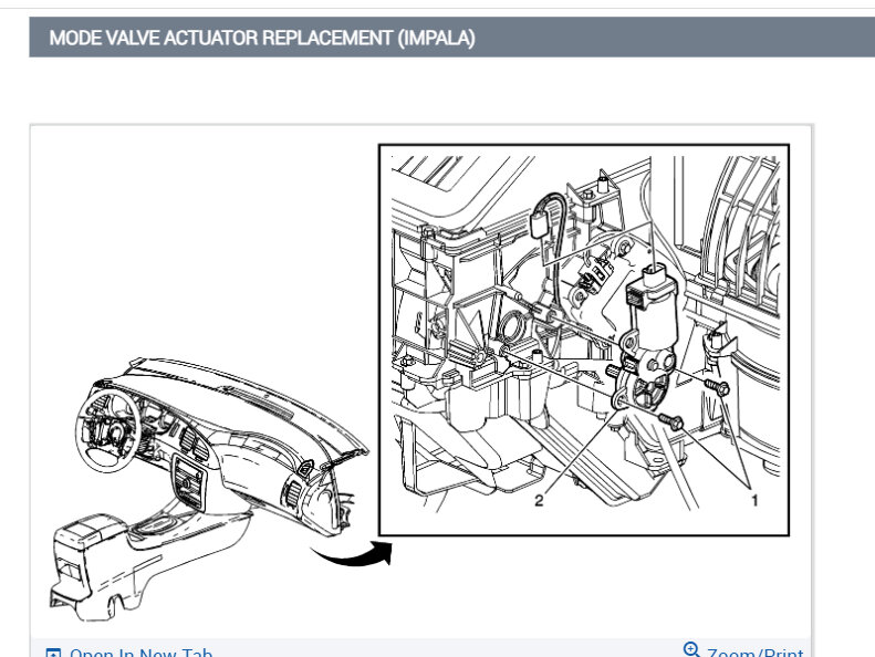

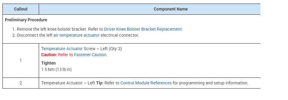

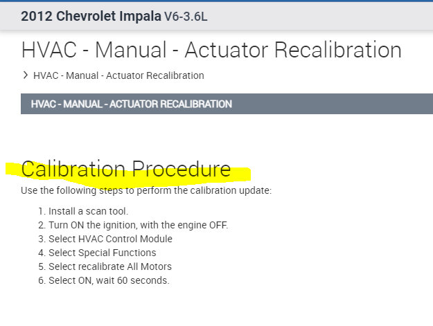

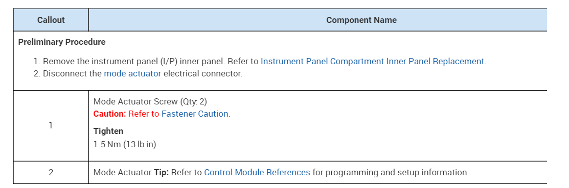

The actuators you mentioned are two different ones. The mode door actuator is for airflow direction and the temp (heat) is a blend air door. I suspect you are referring to the mode door (air flow direction), so I attached the directions below.

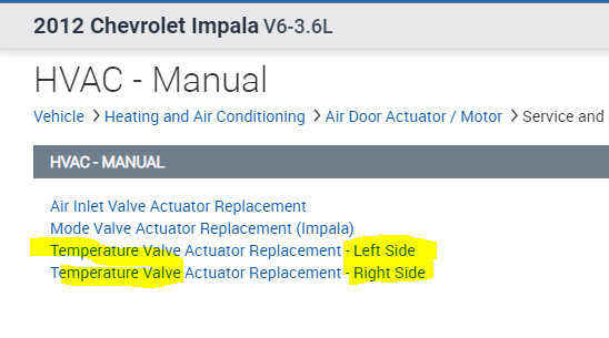

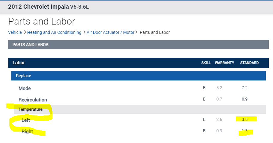

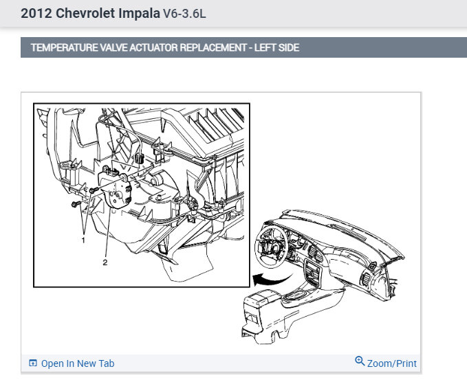

If, however, you need the blend air door actuator (air temperature actuator), let me know if it is for the left or right side.
Take care and let me know if this helps.

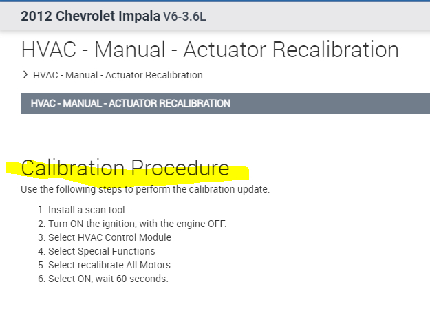

See pics below.
