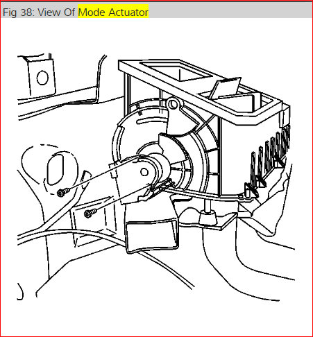

I have an auto HVAC system. My mode door actuator does not seem to be working (no matter what position the digital display indicates, defrost, vent, floor vent, defrost floor, floor the air flow does not change). It comes out on defrost and floor at the same time. When I look under the dash at the mode door actuator while pressing the position button, the actuator does not move or do anything. My question is when replacing, how do you align it (where should the white gear be?)? And how do you calibrate it to ensure there is no damage done?

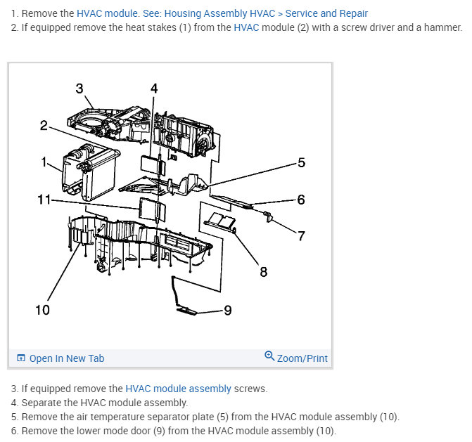

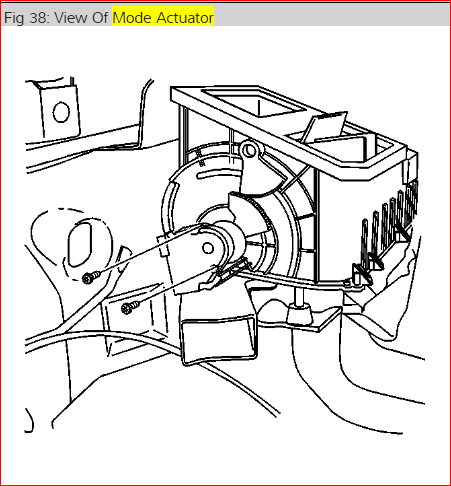

I have attached a picture but I do believe you know already where it is located based on your post. I have also attached a how to link. When replacing the mode actuator as an assembly with the actuator cam, line up the heater/defroster lever with the mode actuator cam slot. Next, line up the A/C lever with the mode actuator cam. Hope this helps and feel free to ask any more questions if needed. Thanks for using 2CarPros.
Danny-
Check out the images (Below). Please let us know what happens.

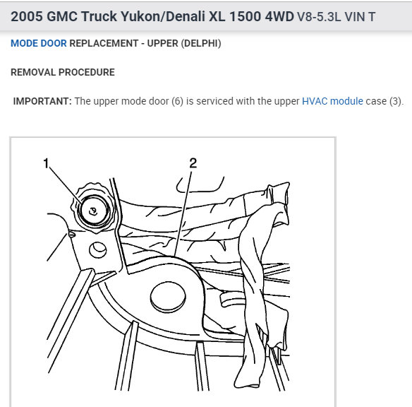

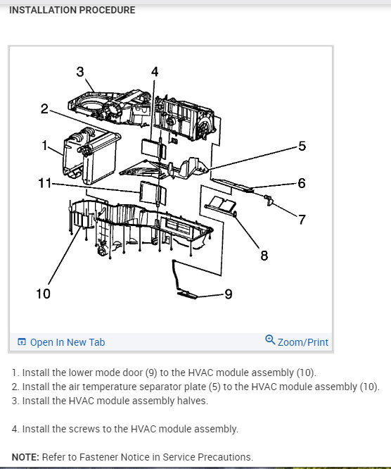

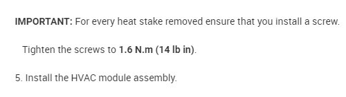

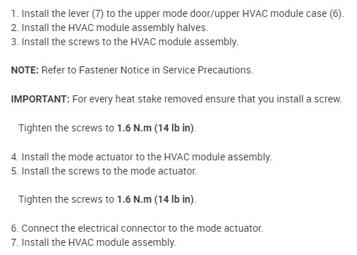

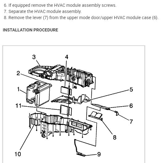

Hello again,

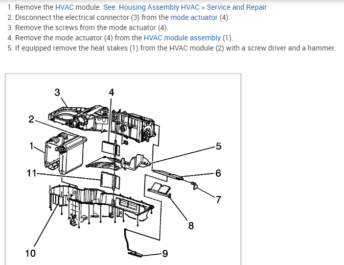

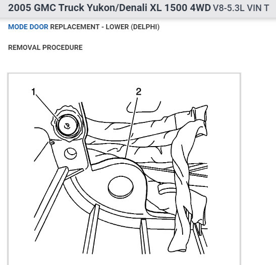

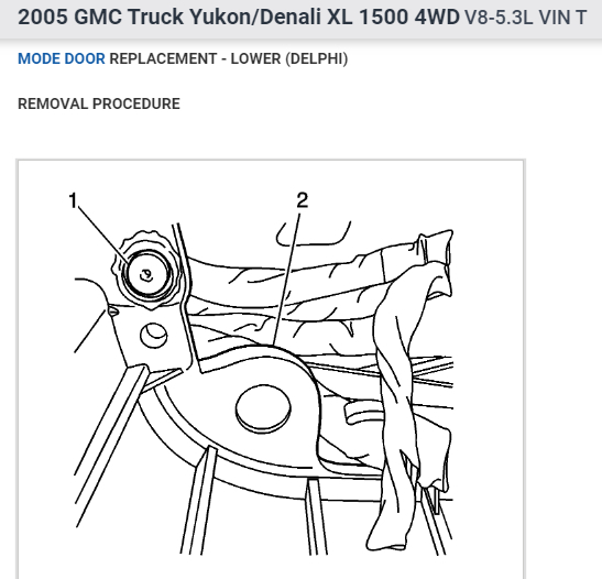

Here is what I found for the upper and lower mode door replacement. I've attached the step-by-step pictures below.Hope this helps and thanks again for using 2CarPros.
