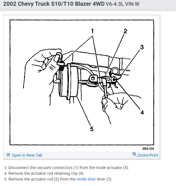

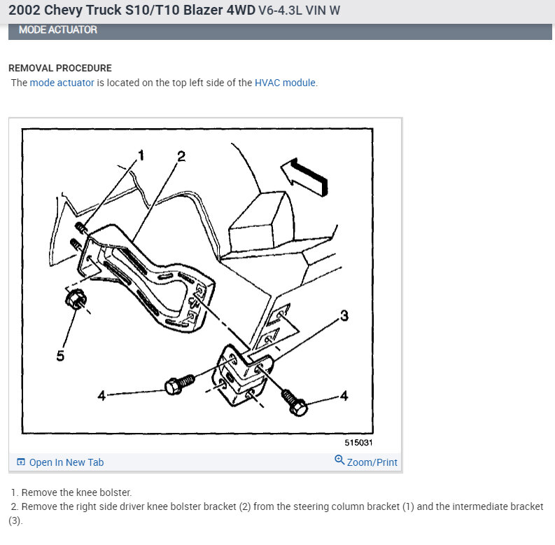

I have good heat and good A/C. Air is only coming out on the forward-facing vents. Will not change to defrost or to floor.
Oct 8, 2022 at 8:34 PM
SQM
CERTIFIED EXPERT
6,383 POSTS

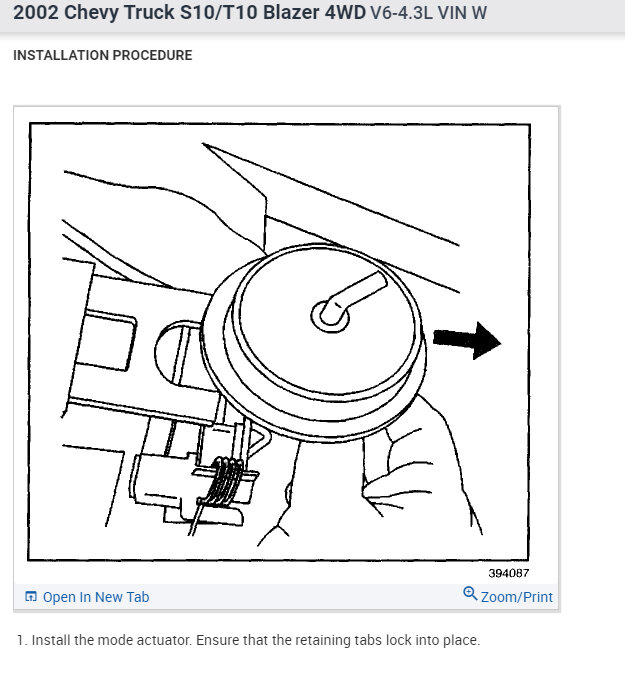

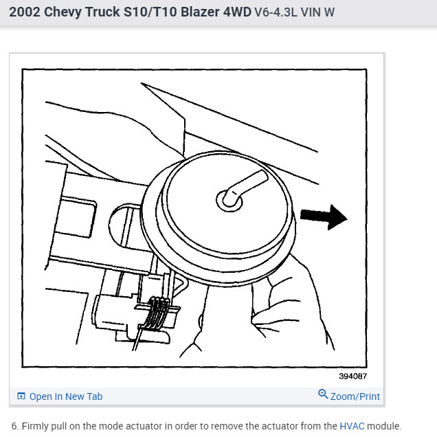

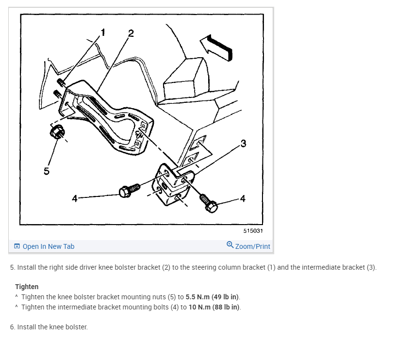

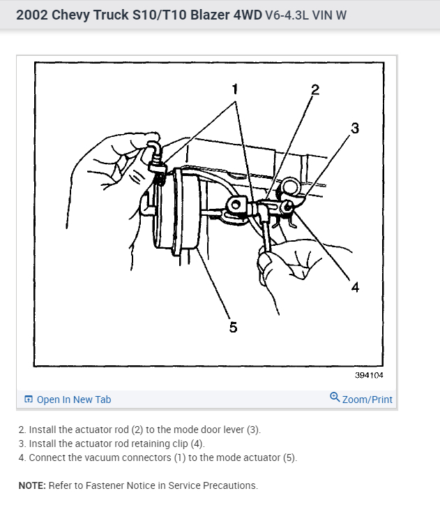

The mode door actuator is located on the top left side of the HVAC module, behind the dash.
See attached for the replacement procedure.
Let me know if you have any questions.
Thank you.
https://www.2carpros.com/articles/air-vents-stay-in-the-defrost-position
