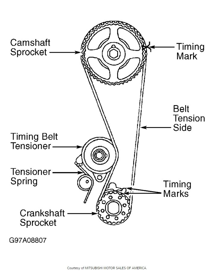

Where are the timing marks on a 1997 Mitsubishi Mirage 1.5? i think the timing jumped. When I start it I have to hold it to the floor and it barely runs at all, it sounds like poop. lol...

Hi everyone!
I found this post and you needed a diagram, here you go. Let me know what you find out so it can help others.
