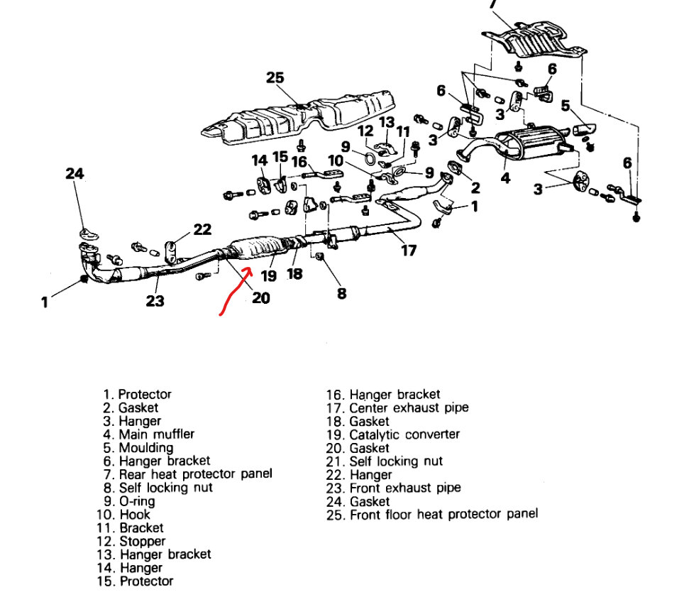

To me it sounds like you have a clogged catalytic converter but to be sure here is the guide to help confirm the problem.
this guide can help as well
https://www.2carpros.com/articles/engine-has-low-power-output
Here is the location of the cat so you can check it out. Check out the images (below). Please let us know what happens.
