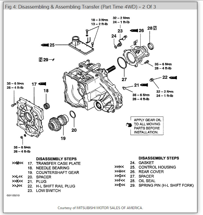

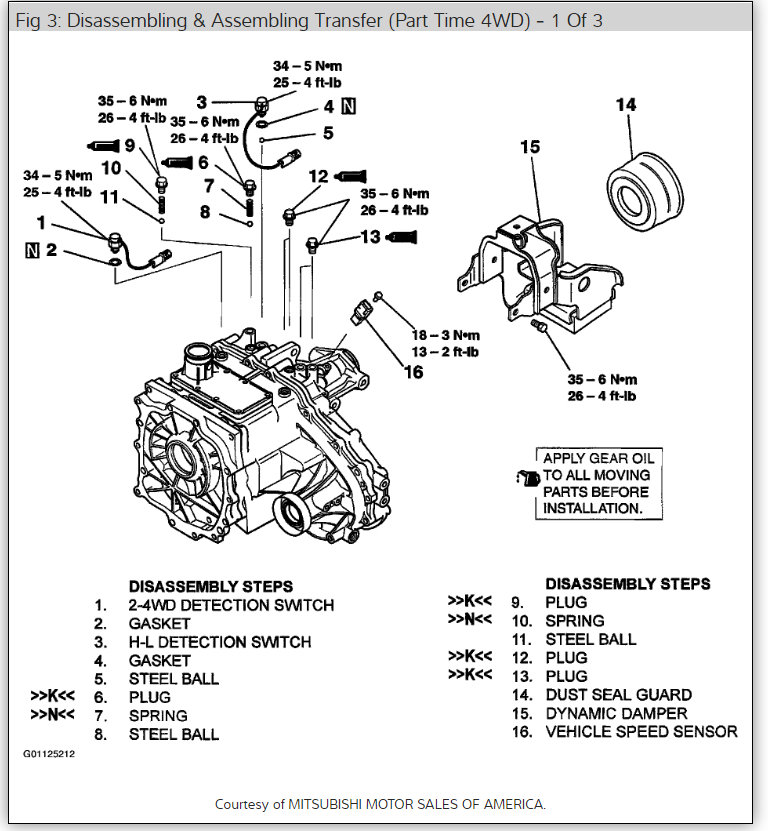

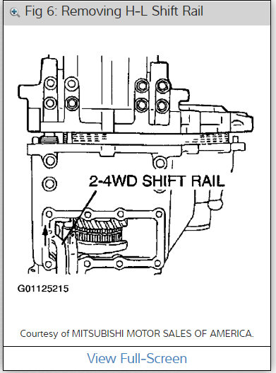

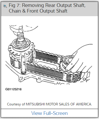

This sounds like a retainer clip broke or the 2wd to 4wd shift fork is worn here are diagrams to help you see what you are in for when doing the job. Check out the diagrams (Below). Let us know what happens and please upload pictures or videos of the problem.
