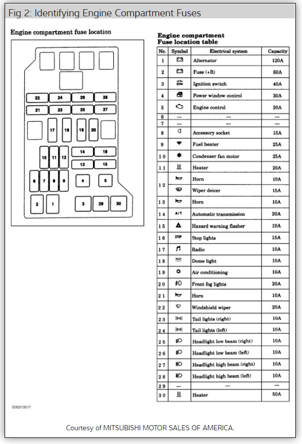

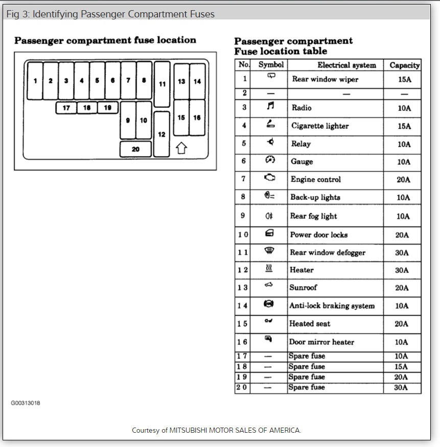

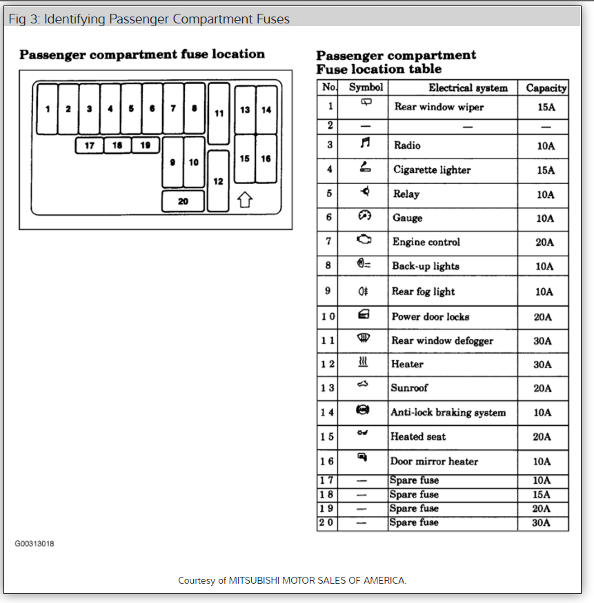

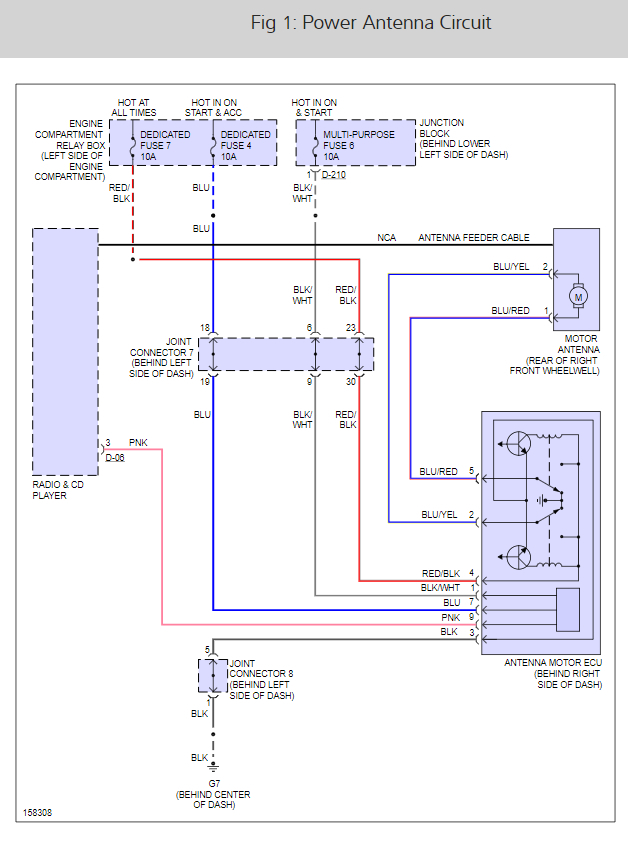

I want to disconnect the motor that raises/lowers my power antenna, where is the fuse located
Feb 13, 2009 at 3:06 PM
BLUELIGHTNIN6
  • 16,542 POSTS

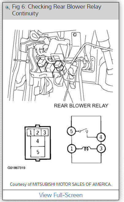

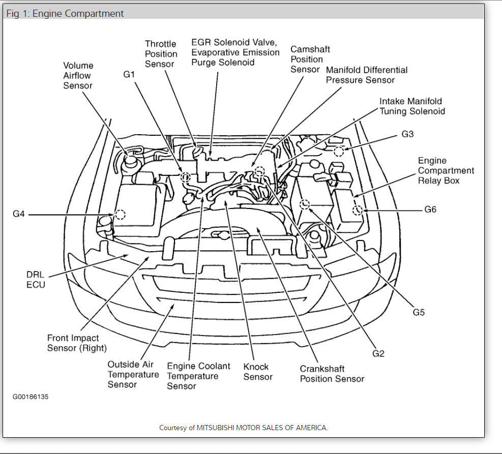

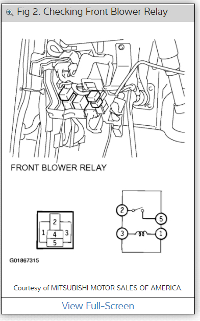

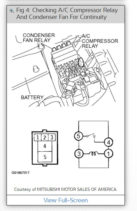

Hello, there are 3 fuses that run the antenna. Here are wiring diagrams so you can see how the system works and which fuses. Check out the diagrams (Below) Please let us know if you need anything else to get the problem fixed. Click to enlarge
